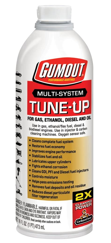

You did the right thing. @thepumpguysc would be my 1st course of action too. I know he has been so busy this summer and fall season. Glad you were able to get a hold of him.
For the fuel system lubrication, I use this. About 1/2 can every other tank fill up. MY machine is such a fuel sipper, it takes a long time before fillups.
