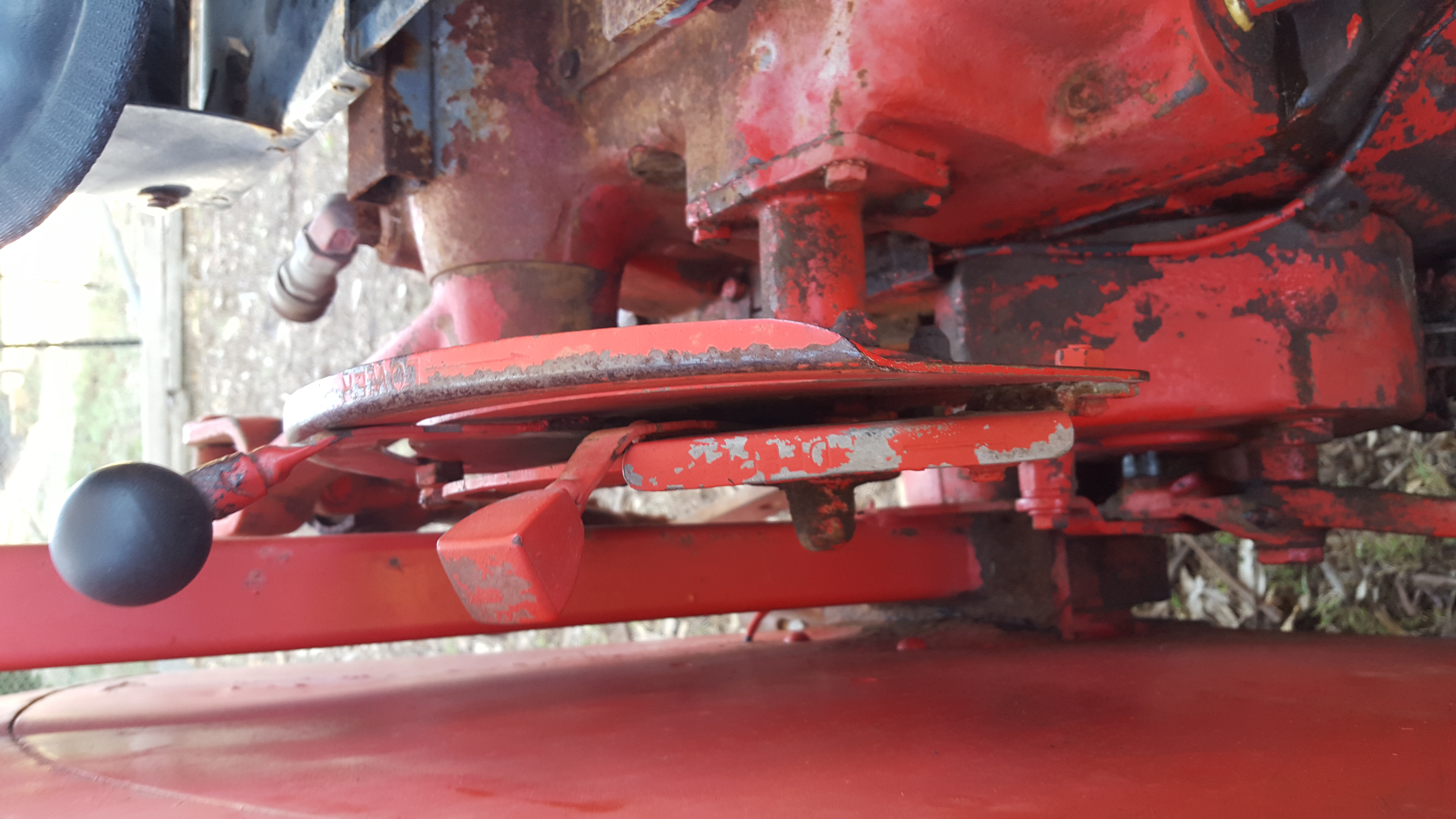

3...has no handbrake....I am sure it was not made this way even though seller said so...I can see a lever under the brake arm with a hole, but there is nothing there at all.....will post image later...

Here are some photos of the handbrake. It only works on the RH pedal so for it to work well the pedals should be locked.
I dont as I like them independent for better turning.
. by Keith Cree, on Flickr
Also you asked about the Diff lock.
Yes , it has to be held down to keep working.
Thanks for those images, will have a close look, that type is same as what is on 434, I know my bottom link area is same, but someone has removed whatever handbrake setup there was, there is another type that has a rachet type handle, will see if anyone posts that, maybe they bolt up the same way, ebay au has some of the ratchet type for sale, no idea how it setup though.
re the diff lock, ok, so that is how they are, odd that they cannot be locked on so foot is free to do other things ? I guess if you need more traction, your not trying to stop at the same time nor apply one brake for turning.
