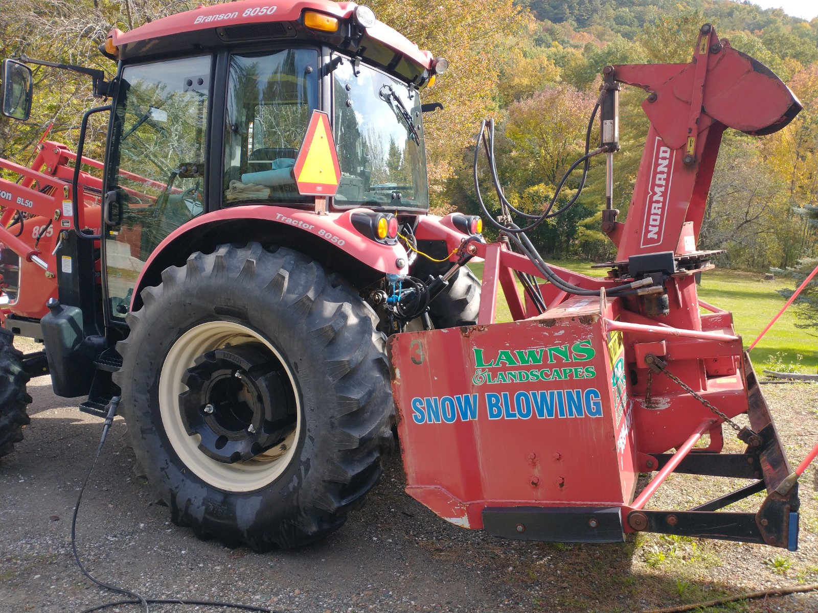

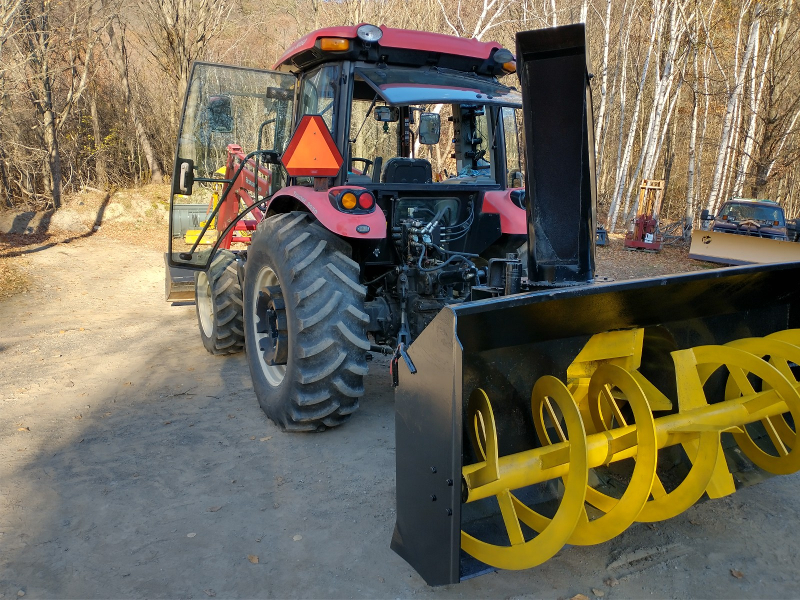

I have both a conventional rear mount that you use in reverse and an inverted one to pull.
I'm usually using a Branson 8050 on either of them, I prefer the inverted pull type.
If I'm moving a pile of plowed snow bank then the conventional is better.
For just blowing the driveway the inverted works great, mine also has a rear drag blde to pull snow away from doors and such, after you pull ahead while blowing you lift, back up and drop and pull ahead again blowing what you have pulled out.
I have not have any issues clearing the plow wipes at the end of the driveway.
My inverted blower does have the poly cutting edge and shoes, I like them but they are expensive.
These are 2" thick and the cutting edge is 6-8" on the ground the full width.
