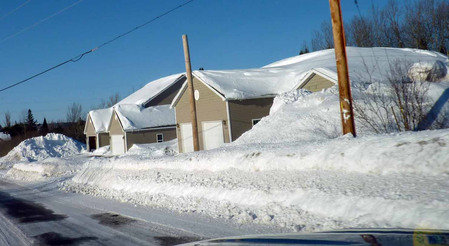

I have thought about it and the idea seems great. But the idea of waking up and finding the storm has dumped 2 or 4 feet of snow in my driveway and I've got a 4 to 6+ foot drift across the middle of it and all I have is a blower the requires me to drive thought that before I can move it with my little tractor just does not seem like a good idea. I have a traditional rear blower because I need one piece of equipment that can handle whatever I get. Big snowfalls are a common event here.
I only put the blower on when the snow gets too deep to plow. That means it would also be too deep to drive through....like this heavy drifted snow.
The biggest difference with a rear pull is it does not become the tool just for big events, it replaces a plow. Slower, yes, but you only touch the snow once.
Here that multi ft snow just isn't common. We've had only maybe 3 2-3 ft snows in the 17 years we've been here. Wind also is not a big factor. We average maybe 120inches and get many days of snow, just not big days. A pull blower is not going to be for everyone but not everyone gets big snows commonly or has huge drifts. The worst i have cleared was late in the season 30ish inches of packed and accumulated snow and ice resulting from the whole winter. Wasn't fast but it worked.

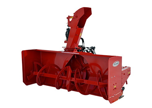

Hello and good moring Roy,
You should be getting the heavy rain/gully washer we just received.
Seeing your post about snow blowers made me go back and look at the Pronovost TRC720 TRC with the rotating impeller drum that work well for heavy slush salt laden snow.
I could not upload a picture of the rear of the snowblower minus the chute to show the left and right discharge openings but the image
is on the 720TRC page.
Pronovost still sells front mount attachment kits for its snowblowers for tractors with mid point PTO systems.
The Pronovost dealer in Vermont is United Ag & Turf in Royalton, Vermont.
www.pronovostinc.com/en/snowblowers/pronovost-group-i/p-720-p-720trc
