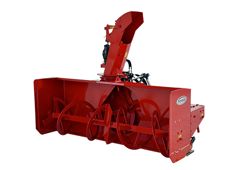

I find this an incredibly interesting thread. We have just purchased 50 acres that will require a 1/4 mile driveway, just south of Duluth, MN. I'm getting ahead of myself, perhaps, but snow removal will be required once we have a road laid down. It will be gravel, and pretty straight and flat with two short but somewhat steep hills. It looks like a pull-behind "inverted" blower would be the way to go. I've been dreading the rear mount, reverse-drive set up, and I don't want to give up my loader bucket and grapple for a front mount.
The only pull behind that I have seen before was an off-set operation that cut on the left side like a sickle mower. Back in the day when I had a Ford 8N, they were interesting, but we don't get the snow at our present location (Iowa) that justified something like that.
The big concern after reading these posts is whether my JD 3039R can handle one an inverted that is 70+" wide, and if so, how wide can I go? From the posts here, they seem to be heavier than I would have guessed. Is a 39hp, 4wd tractor going to handle it?
If so, I may start shopping around for a used one here in Iowa.

68-72'' should still be fine for yours sized tractor.

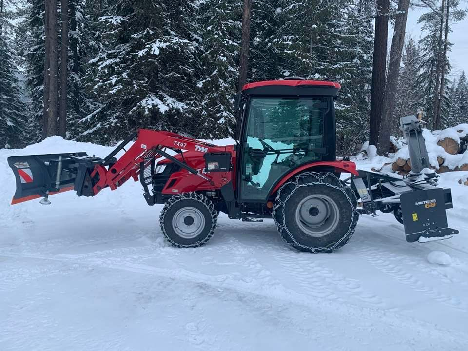

I live 75 miles south of Duluth. Here is my 40hp New Holland and a 68" MK Matin rear pull snowblower. I bought mine from Iowa Farm Equipment.

I have a 45HP and pull a 72" MK Martin. It is heavy at 685 pounds, and that weight is out a ways from the tractor. But nothing my tractor cannot handle. Last week, we got dumped on, and I spent 7 hours in the seat doing driveways, pulling cars out of the ditch, and blowing snow off the county road. Its slow, but not horrible. When we get a few inches, I can run pretty quick. The big thing for your smaller tractor with an inverted, is the ground clearance. If you get dumped on, having something to push the snow with is better than driving over it, IMO.

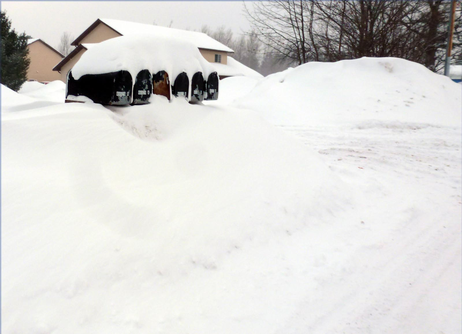

We had a storm last week where we were predicted 3-5" and we got 22". This happens pretty often. We also have many times we are predicted 3-5 and get none like we were 4 days ago.

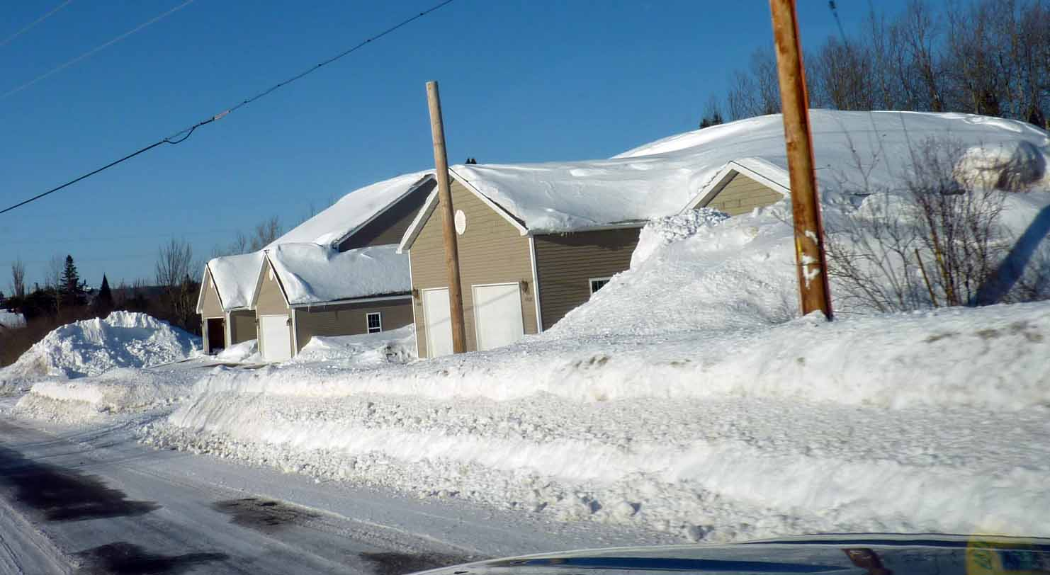

In my line of work I do not know which I prefer. The snow I can see. The wind blown drifts I would almost have to drive my route to see who had anything. Some would have none and some would be snowed in.

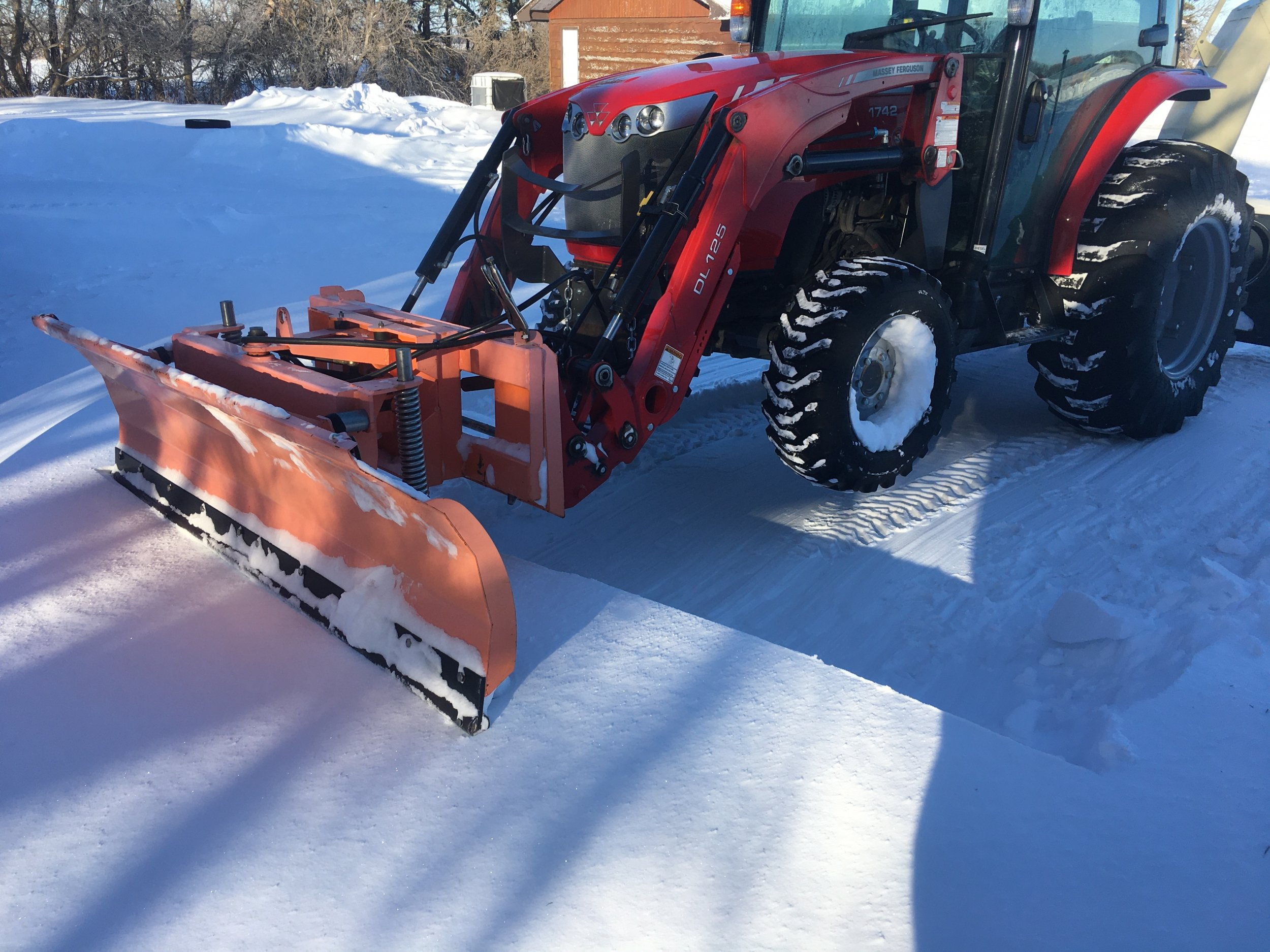

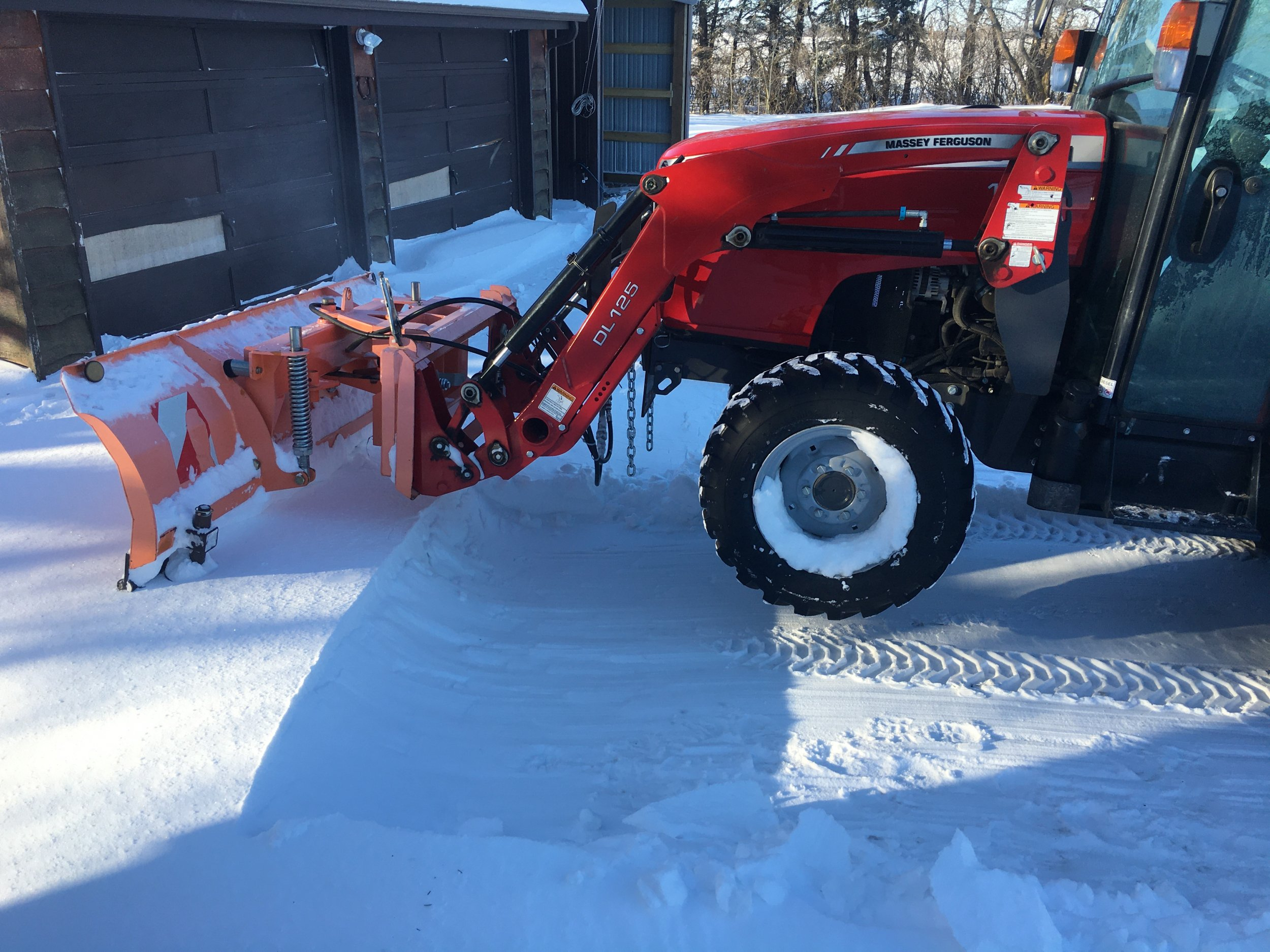

I don't want to knock the pull blowers, I wouldn't mind having one myself if I could use it. But my little tractor cannot drive through 3 to 6 foot drifts or the 3+ foot banks that the plow leaves at the end of my driveway. Using a pull blower would mean staying up all night to keep up with the snow. If I wanted to do that I could have gotten a beater truck with a plow for a whole lot less than I spent on the tractor. Either I'd have to be up all night during heavy storms or I'd need to have two different blowers to use depending on how much show fell while I was sleeping. Not sure why I keep reading threads like this except for envy of those that don't have to deal with the snow and drifting that I have to deal with.
An inverted wouldn't be right for a small CUT, or long deep drifts. The banks that a plow leaves at the end of a driveway can easily be handled by your loader, and then you're back to blowing.
