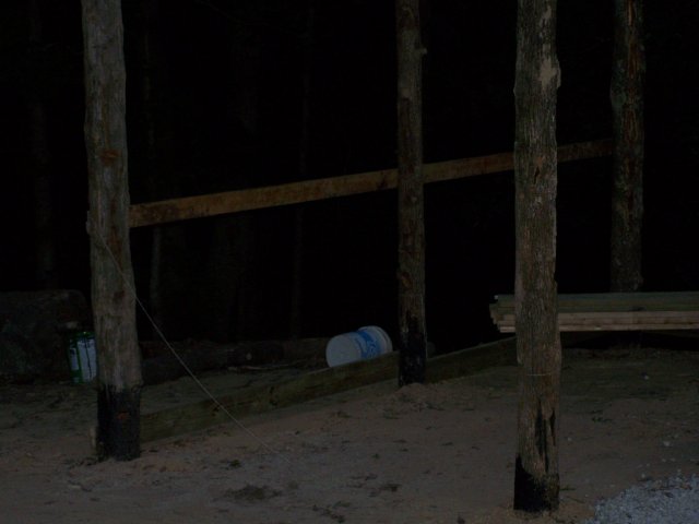

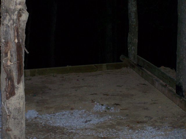

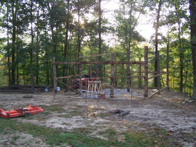

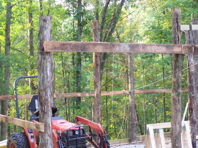

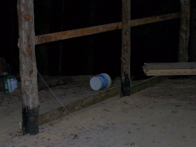

I started putting on stringers today. Whew, same size square poles do have advantages, but being frugal (in my case broke) using my home grown posts. ah, cost effective!
The bottom stringer is treated 2x6, since it makes ground contact in most the places. I need to get a load of dirt to fill in low spots, and then I'll put limestone down on the floor.
I've got one band finished in the middle and just started the second and these are by golly 2x4s I had milled, and by golly lift one of those oak 16 footers and you know you have a board!
The work is gettin' the stringers plum with each other cause the poles ain't symmetrical, a 50 cent work by my account, in any way, shape or form. Going from the treated 2x6 up 4' to an actually 2x4 by golly the posts need notched so the stringers are plum. Another great reason to have a sawzall in the armory! Oh I'm Bo, so of coures I have one older than dirt wood blade and a pile of bi-metal blades, but the wood blade got me thru the day and it's off to Lowes tomorrow.
I must stay I'm very happy on how the shed is coming together and sometime over the next few days I'm hauling in my older than dirt scaffolding to use as my work platform.
Here's the latest pics but it was getting dark so here goes. You'll see a white 2x4 on one pic that is just to make the corner work.

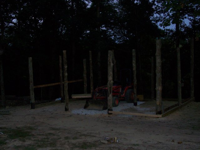

Nearly all the first two runs of stringers are up and too dark to take pictures!

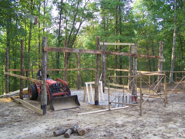

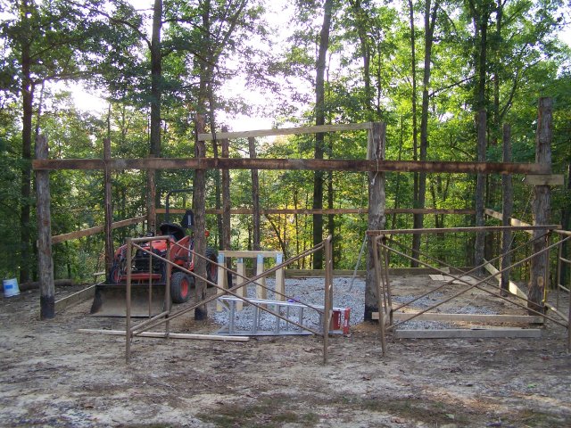

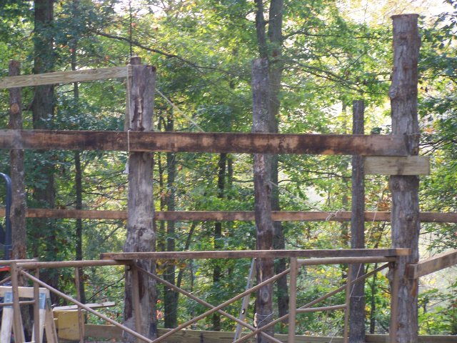

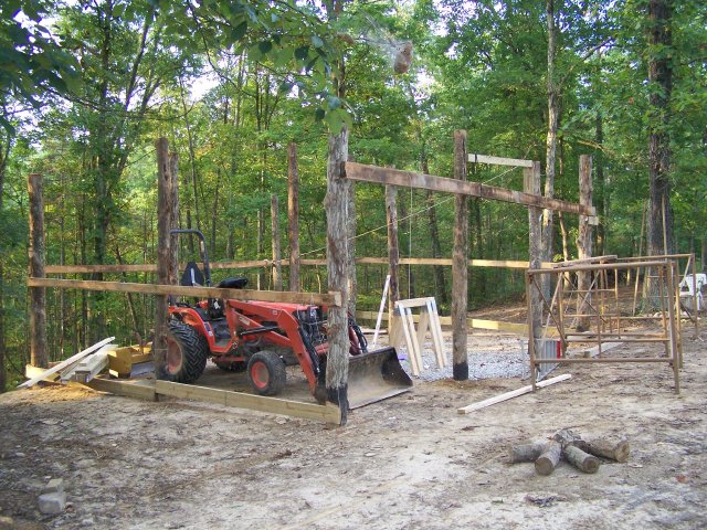

All the bottom and middle stringers are on now. The pole outta place is now in place. I just finished the top 2X6 stringer, and let me tell you the 8' section was a breeze, but that 16' was a bear, a grizzley bear with a bad attitude type bear too!! Whew, I did, and I did it all by myself...thank goodness for ropes and trap straps!
Pics a coming, it was plum dark when I was picking up tools.
   / Iron Hill Shed
#29
Here are the pics.... There's lots of clutter...I am me.
