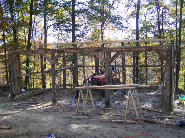

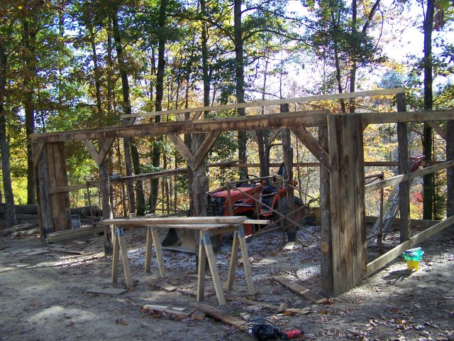

Here's the latest pics. Check out what the earth equipment the Operations Manager dropped off, whew...what do they think I am, but it's green and yellow (can ya say Deere? Cat?)

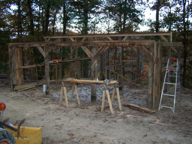

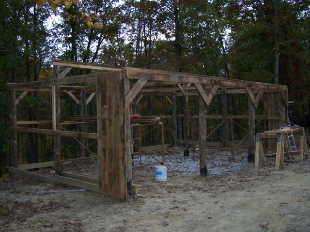

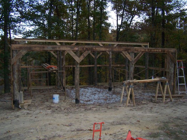

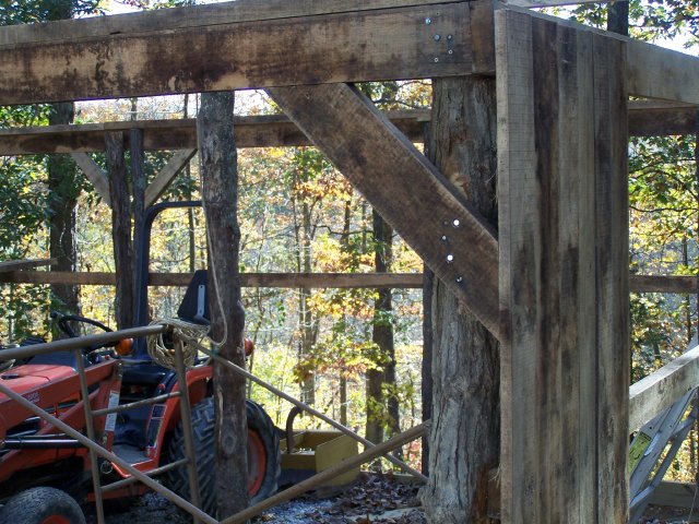

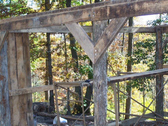

You may not notice the progress (it's a slow pace when your help is yourself) but all the braces are in place and I build a support beam across the center poles for the rafters. Tied in the middle beams to the front and back. I have the first long rafter cut and ready to you it as my pattern. I just gotta get the small ones cut for the front. It'll be a saltbox style for sure.
All the top stringers are lag bolted to the poles with additonal exterior 4" wood screws and a few have a big ol' nail..had to get them in place then level.... For the most part everything else is 4" wood exterior screws (for some reason I think they maybe 4.5").
What few 1" siding boards are in place by 2.5" exterior wood screws and a 8 penny galvanized nail. I'd nail in place then add the screws after I hung them.
It's a work in progress for sure.

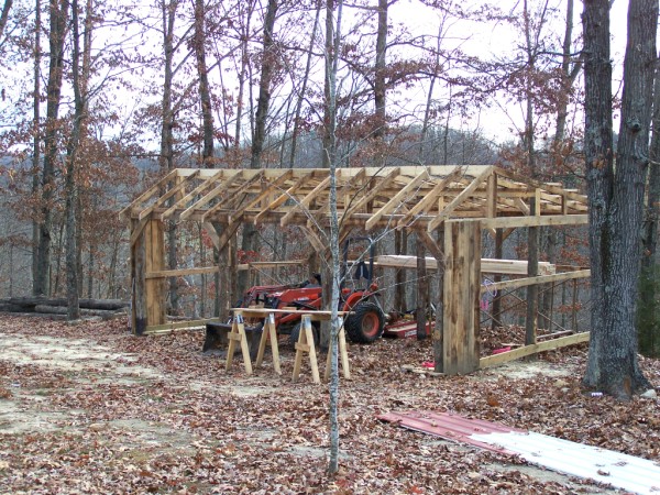

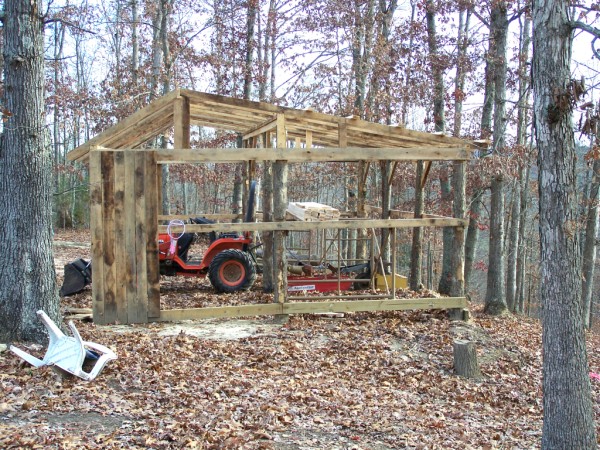

I got the long rafters in place today and ready for the short front ones, remember I'm doing a saltbox style roof. This one man operation is a tad bit slow, but the end, well the roof is coming fast, hopefully faster than damp weather. Not too much snow in this part of KY.
I hope to get metal prices this week. Can't think of the place in WV and it's cut to size. I heard they were the lowest price too. I think the CEO wants red, but ain't nobody but the birds and the planes ever seeing the top, except the front overhang.

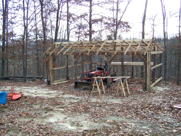

Got all the rafters up and about half the purlins are in place now. It's sure gonna look like a shed when done!
Contractor buddy gave me 4-5 sheets of metal for the roof, ah the roof of many colors. The bottoms are all white, so if the birds don't complain it just don't matter! The front of the saltbox roof will be red and the remainer will be what they give me the best deal on!

Here are some pics of the latest.
Thanks Eddie, I hope it stands forever!! It should out last me and I hope that's a LONG TIME!

I'm really following this becasue it looks like the run-in I want to do. Question about the salt box style roof. What supports the peak? Is it just like a regular ridgebeam style roof with with rafters, ridgebeam, and birdsmouths or is there some kind of support under the peak? I assumed that the rafters had to be symetrical for a ridgebeam to work. I can't tell from the angle of the pictures. Got anymore pictures?
Thanks,
Randy
   / Iron Hill Shed #50
Not sure if I explained the last question correctly. Let me try again:
It looks like a ridgebeam at the peak and a beam further back on top of the center posts. Correct? What supports the peak on a salt box style roof like this? I thought a ridgebeam design needed to be symetrical so that the rafters pushed equally against the beam and the bird's mouths.
