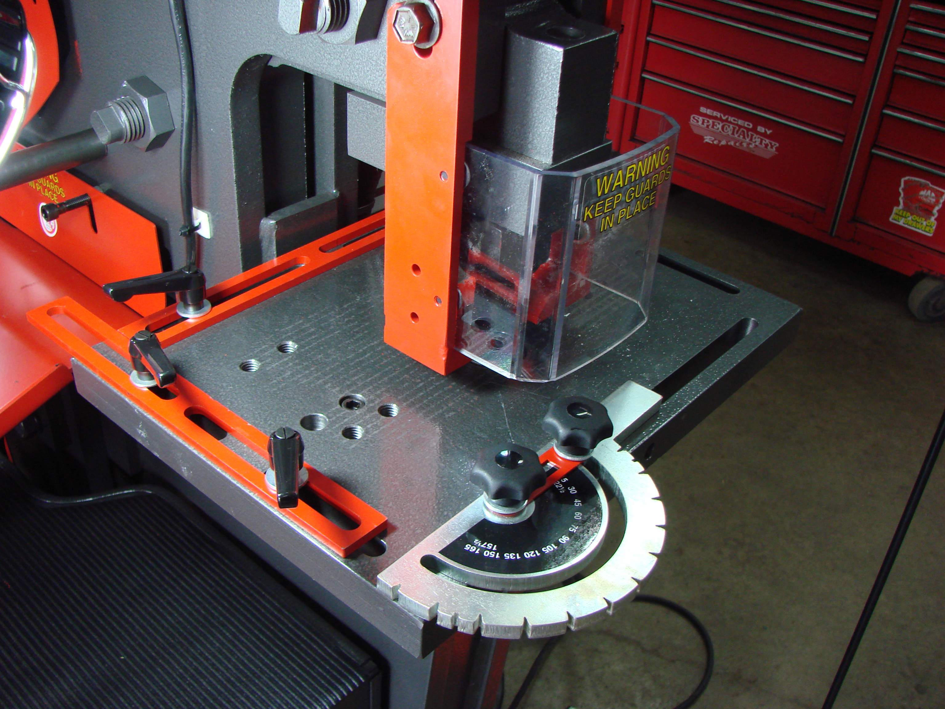

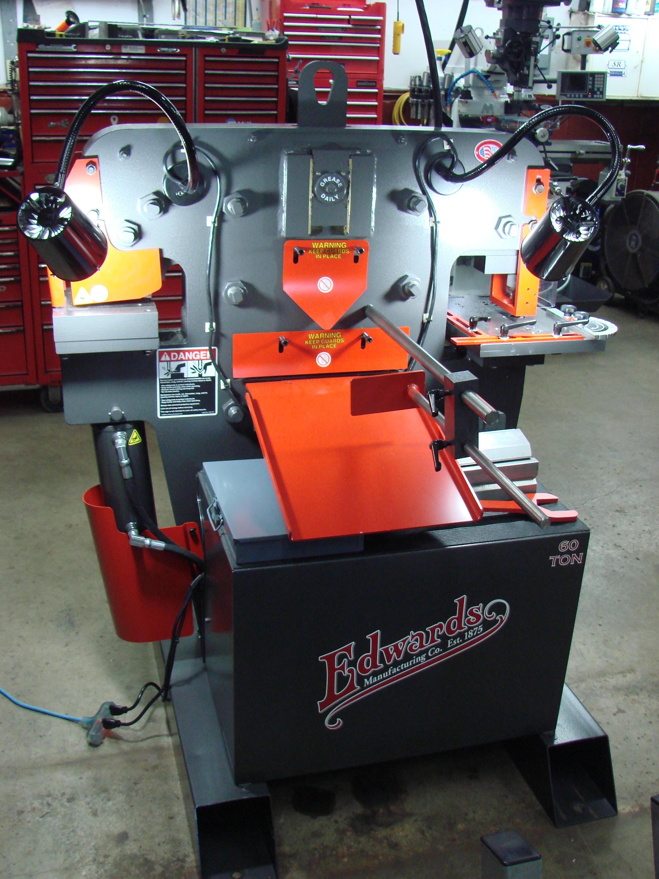

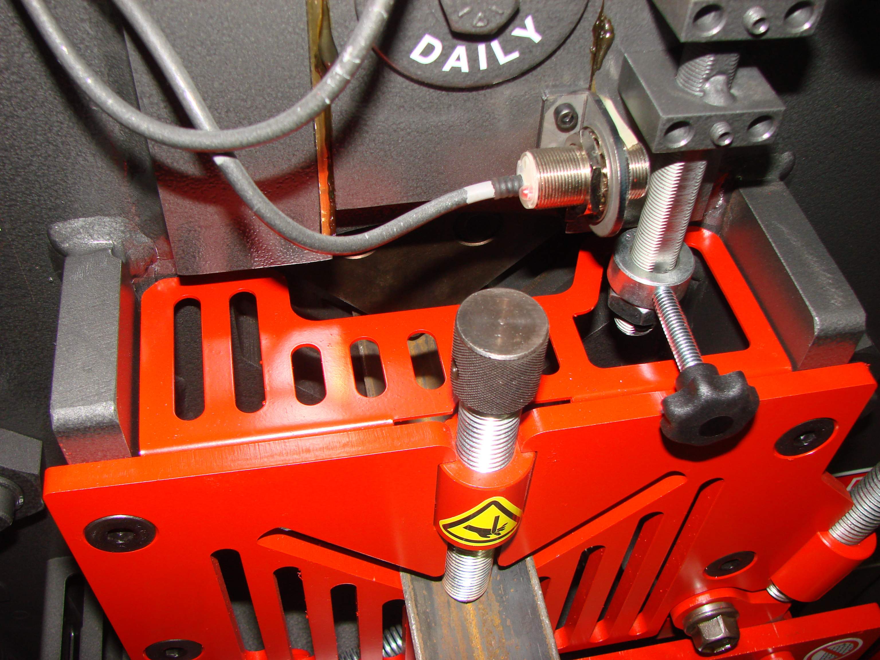

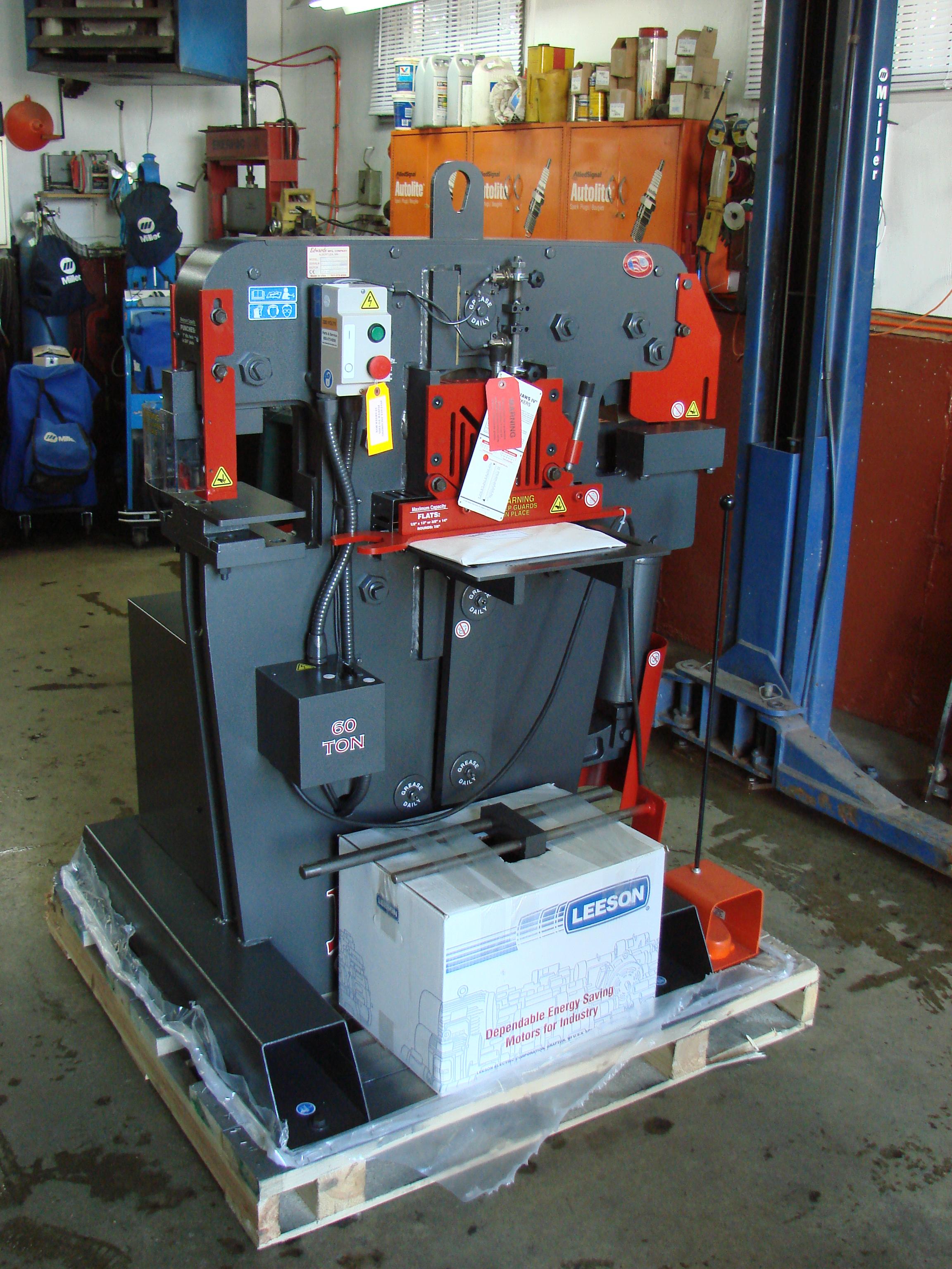

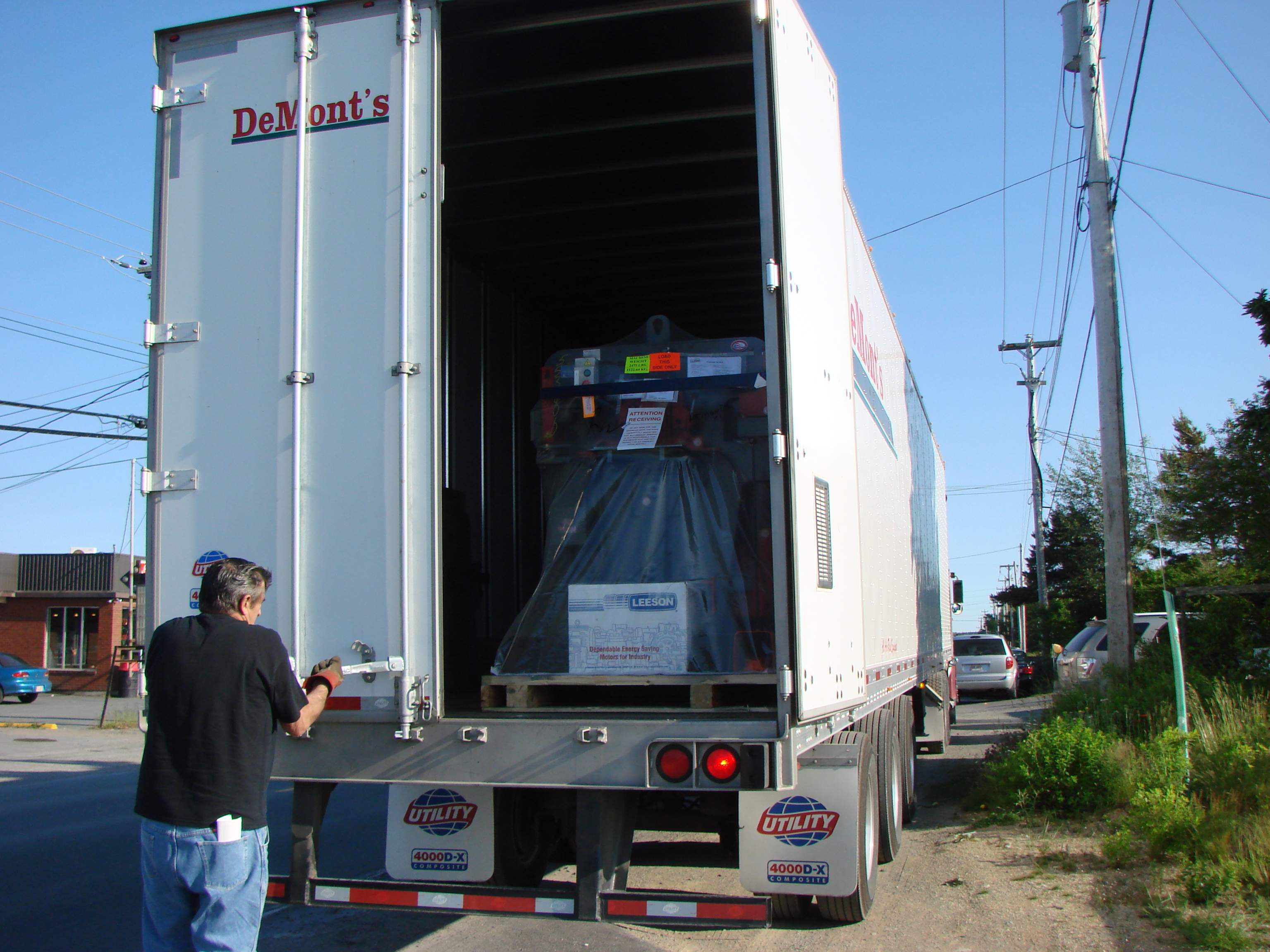

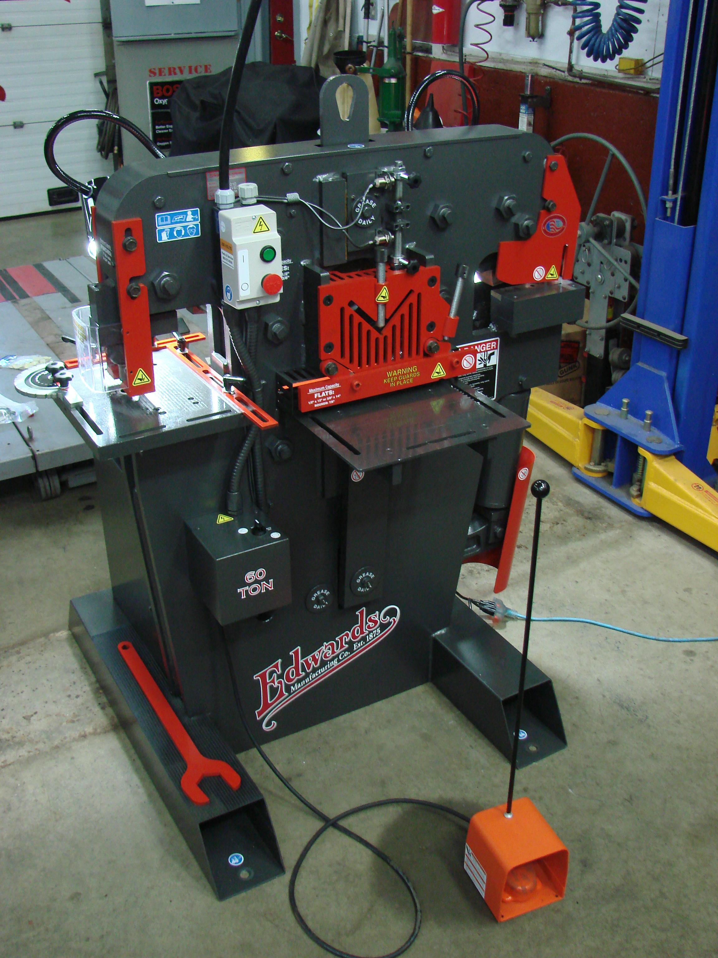

Well I had just left the shop yesterday and got in the house when I heard the pissh of an air brake so I knew it had to be the new Edwards Ironworker I ordered three weeks ago. This one is the 60 ton model. I ordered it with a set of punches, a heavy duty gauging table kit, pedestal die table,48" manual back gauge, a fabricators protractor and a 8" four way brake.
The ironworker came standard with the electric stroke control, coper/notcher and angle /plate share so It's well equipped.
Edwards fit and finish of these machines are fantastic. All good components are used such as a Leeson 5 HP motor. The Ironworker was very well packaged and everything that was ordered arrived which was a Hugh plus. After I got it all unpacked I started to install the optional items such as the 1" thick gauging table. I also ordered a couple of flexible magnetic lights from another source to put on the thing. I like lots of light. After I ran the 220 single phase power to the machine it fired right up and worked great. The last photo shows the 1/4 plate I practiced on. It did that with so little effort I could hardly believe it. Made in the USA was a big plus as well. Here's how it looks.

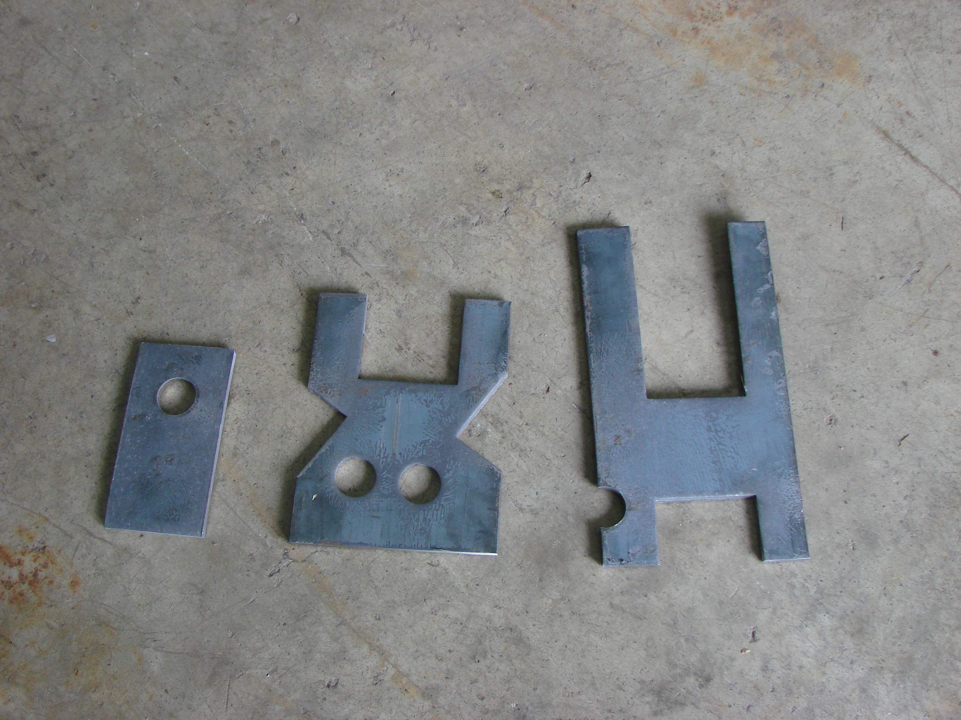

The first use of the machine. 1/4 plate:D

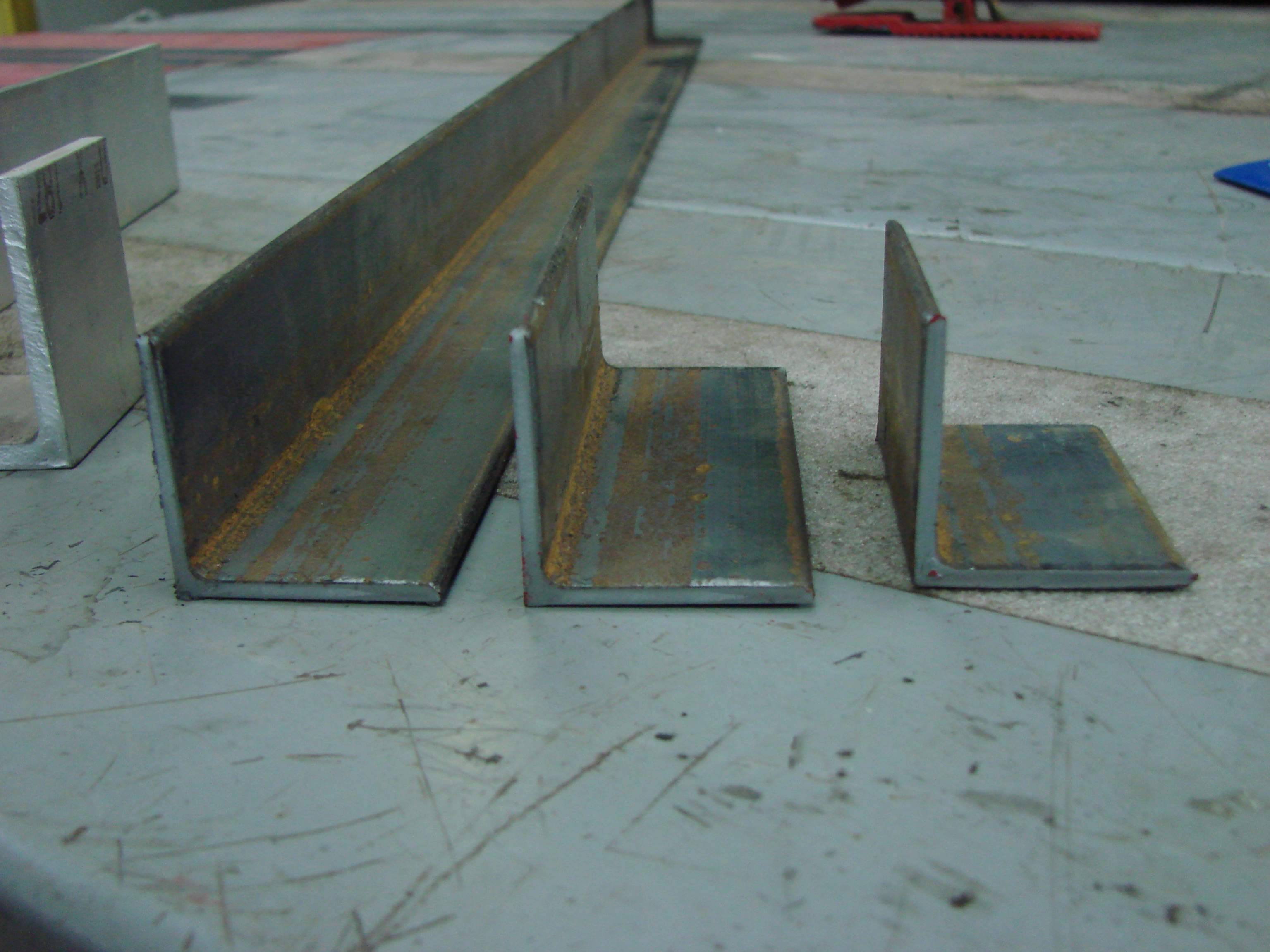

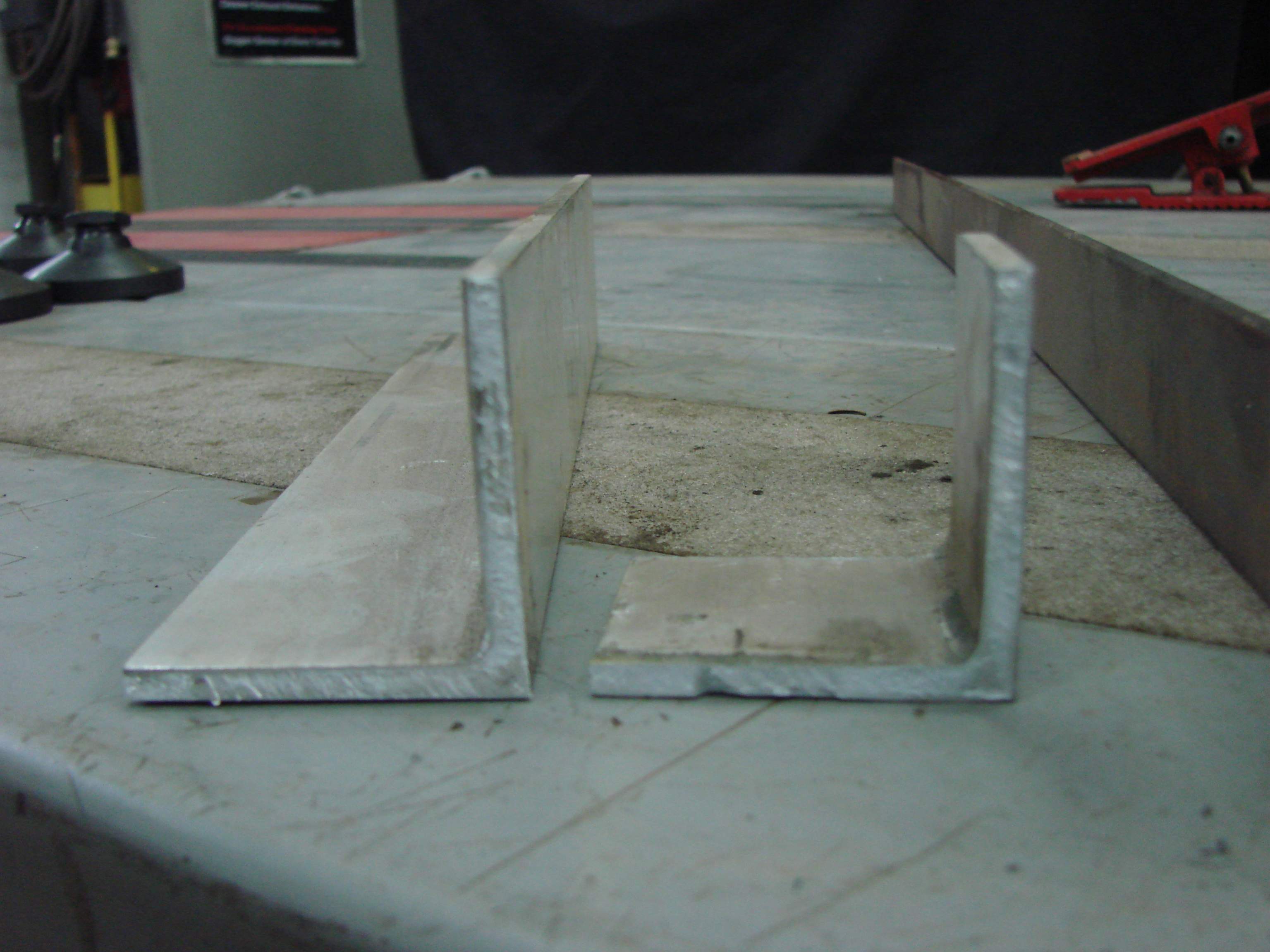

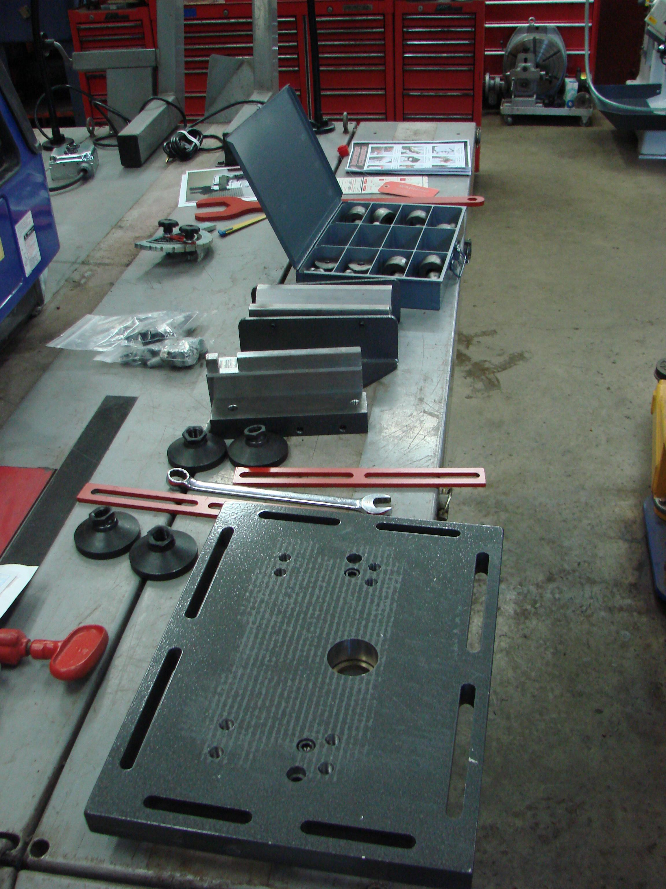

Have you sheared any angle iron with it yet? I have a Metal pro ironworker and when I shear angle iron I lose 3/8" every time I make a cut because it has to make a double cut to keep from distorting the angle. I was curious as to whether the Edwards was the same way. You will love your ironworker. I use the punch and the shear the most. It sure makes life easier when you fabricate a lot.

Good question Bill so I put some steel angle iron in. All I had here was 1/8th x2" so I made a few cuts and there was no distortion at all on any of the pieces. I also cut some 1/4 aluminum angle as well with no distortion. I snapped a few pics of it to show you. Maybe you just got a blade out of adjustment?

i'm not completely familiar with either of these exact models, but i know the metalpro uses a slug-type shear. i'm assuming that the edwards doesn't. the slug-type shear is very much like a punch where it pushes a small piece out when cutting, hence the term slug. i would guess this may have to do with requiring support on both sides of the shear to keep the metal from tipping up while cutting. some metalworking machines i have seen/used have hydraulic hold down clamps that engage before the shear.

Aparently mine is a slug type shear. I called the manufacturer when I got it and they said this was normal. This probably also reflects in the price. The Edwards are top of the line but out of my price range.
