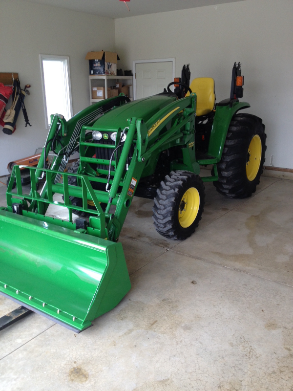

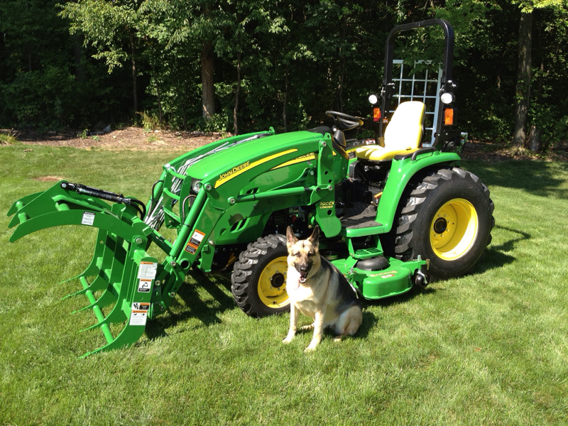

Here's some eye candy for ya! The day I took delivery...
   / Is a 3320/3520 to big for my needs? #16
Here's some eye candy for ya! The day I took delivery... <img src="http://www.tractorbynet.com/forums/attachment.php?attachmentid=367817"/>
Mines bigger...lol
