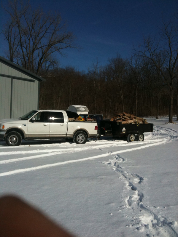

If the price is right and the truck was well cared for, they will pull 5000 lbs, locally. I have owned the 4.6 and the 5.4 liter trucks. Honestly neither are really awesome at towing. When I borrow my fathers 05 Chevy truck I realize what a dog the 5.4 liter is. But, I tow regularly with my 01 f150 5.4l. It gets the job done. Not a sprinter but works ok.
Chuck
