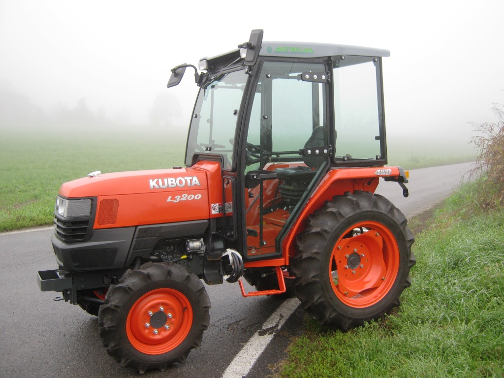

I'm throwing around the idea of getting a cabbed tractor for my mowing business due to allergies that I recently acquired. I currently have a L3400 with loaded rear tires and 4" spacers on each rear axle. This thing is very stable on slopes. Would it make a difference in stability if, for instance, it was cabbed?

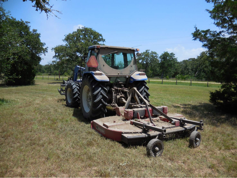

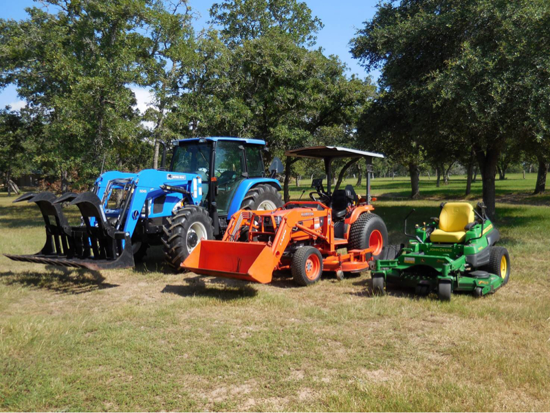

Well stated C4. My pastures have lots of oak trees that the NH TL100A cannot get under. So have to use the open station Kubota for that, and the JD Zero Turn for the really low trees. The JD is, by far, the dirtiest when it is dry.

Yes, cabs are worth every extra cent they cost and then some. A big plus is that they hold their value if ........... you don't beat the crap out of them.
