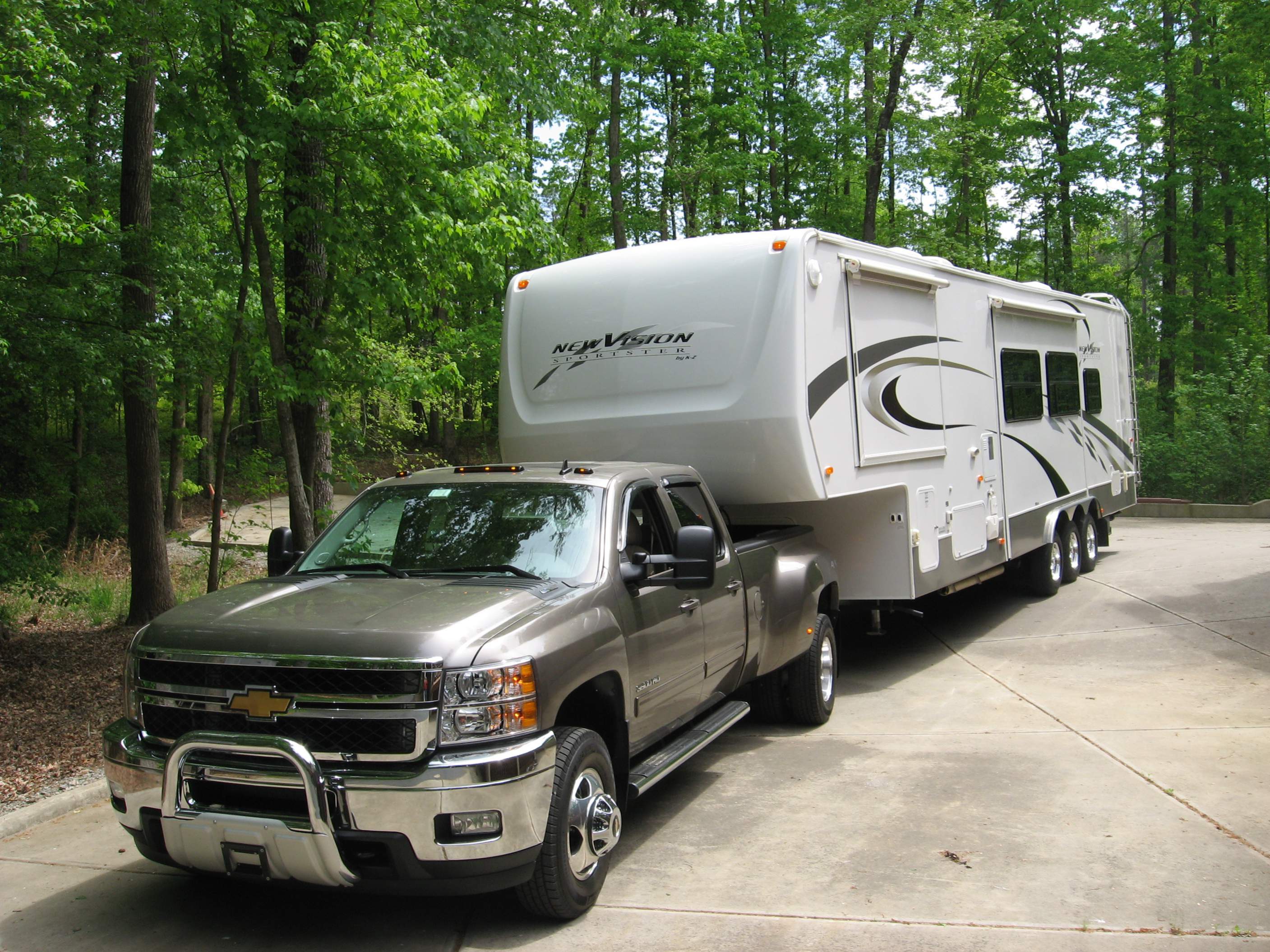

old computer pictures 017.jpgI also would not be worried about a large 5th wheel. Get stuck at a campground with 3 days of rain and they all get very small quickly. Buy good equipment regardless of brand and I don't think you will be disappointed.
Length is a issue with some older campgrounds. I really wanted something under 38 feet, but could not find one that would do what I wanted and haul golf cart. Less length and more slides are better IMO. The longer they are harder to back in tight campsites and leveling and door steps can be a issue.
I would also recommend triple axel with michelin E load tires. One blow out will cost you more in body repair than cost of tires.
Weight police typically leave RVs alone.
Good Luck.
Scott

gorgeous rig Scott. Nice "deer clearer"....could sure use those here.
so, you are pulling between 17K and 19K with that rig, with a duramax dually, rated to pull how much?
3.73 rear?

I have learned the wisdom of the "big rig" campgrounds. They really are easier to get in and out of, less sharp turns, etc. But sometimes you want to go somewhere else, that perfect spot along the lake, and one can only back in...
do they make cameras that go on the back of a fifth wheel trailer for backing?
do triple axles make turning harder? I like the idea of more tires on the road, less single points of failure.

Yes, there are any number of back up cameras that can be mounted on the tail of long trailers, some are wireless.
I just got a new "trucker" Rand McNally GPS that has an input for a back-up camera.
Not clear that I will actually USE it, I tend to "walk it first" - old fashioned I guess.
I was taught to not drive into anything I couldn't back out of, so when it looks iffy I back in.
If that doesn't work out at least I can still pull out forwards - then give up (-:
I might use a camera INSIDE the trailer to watch the horses, although having done that before I know it can be a HUGE driving distraction )-;
Yes, triple axles SCRUB more, wear more, etc. but sudden blow outs are less dramatic.
A well balanced trailer on tandem axles won't always "tell you" when a tire goes out - which is scary, you could go quite a way before the other one on that side overheats and blows out, THEN you would have a problem - make that a PROBLEM !!!!
