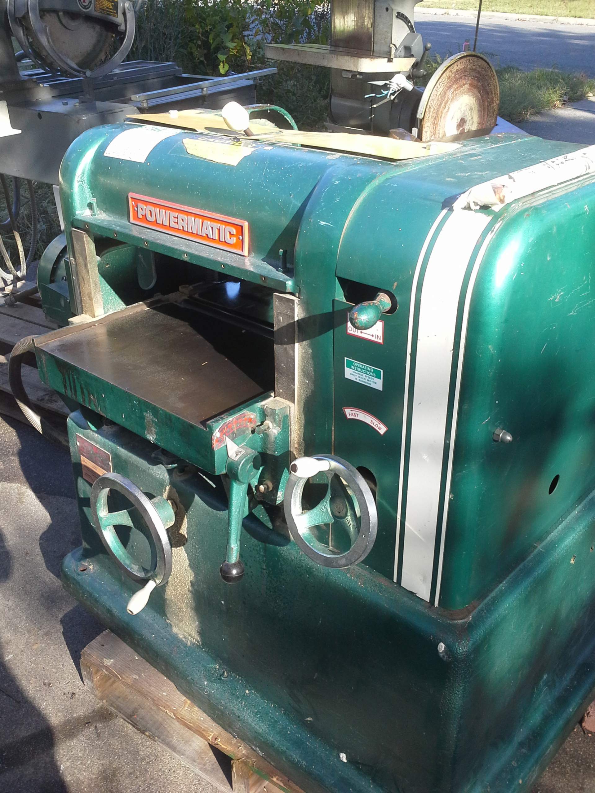

In my case I felt I needed the dually for the payload capacity, on my 2002 F350 a SRW would carry 1,900lbs, a DRW 3,100 lbs.
So for example when I dropped this 1300lb planar in the back
I had capacity left to load the cab and put my trailer on the back. When I go to put logs in the back 1,000lbs means another 10' log.
