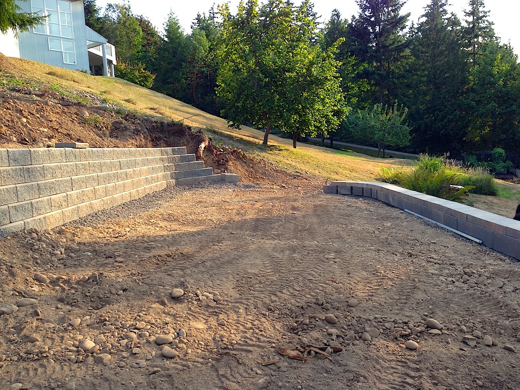

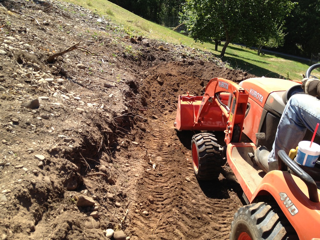

I guess I am way too brutal on my little BX because I have been doing some serious digging on my sloped hill with the FEL and a Piranha tooth bar. I'm guessing a hundred yards moved in two terraces so far. Yes slower than a big excavator or dozer for sure but it can be done if you have the time.

Nice dragon:)! Im amazed what the mighty bx will do ( laughing):) . I dug out a concrete pad w backhoe & moved it w fel about 1000# pieces! Couldnt lift it but would curl it so was good enough to carry to woods. Nice work btw

Good work. You were essentially driving into a pile of material, the hill, WITH a toothbar and picking it up and loading it.
But if Harry Homeowner's main objective for his expensive piece of equipment is to make a large basement and a trench for a new house on flat hard clay, or to dig out stumps, or graves he would be better served with a different piece of equipment then a FEL. My manuals explicitly state not to attempt to dig more than a few inches deep at a time.
