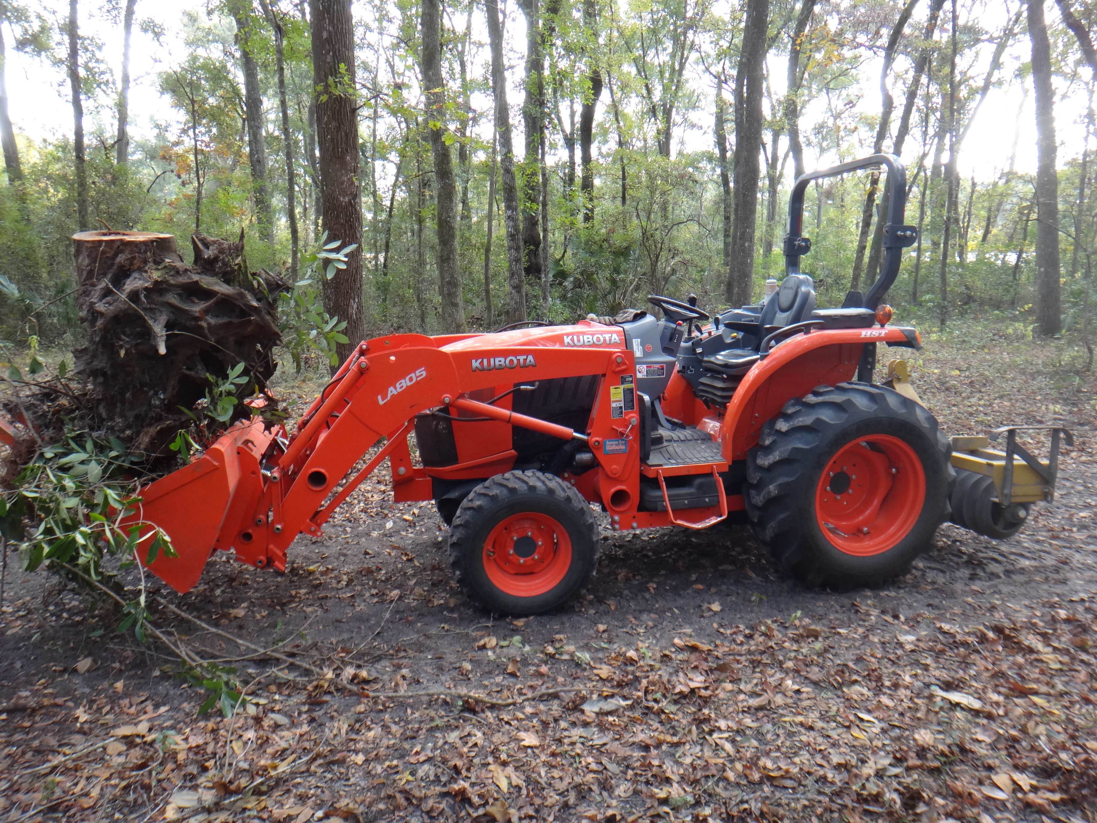

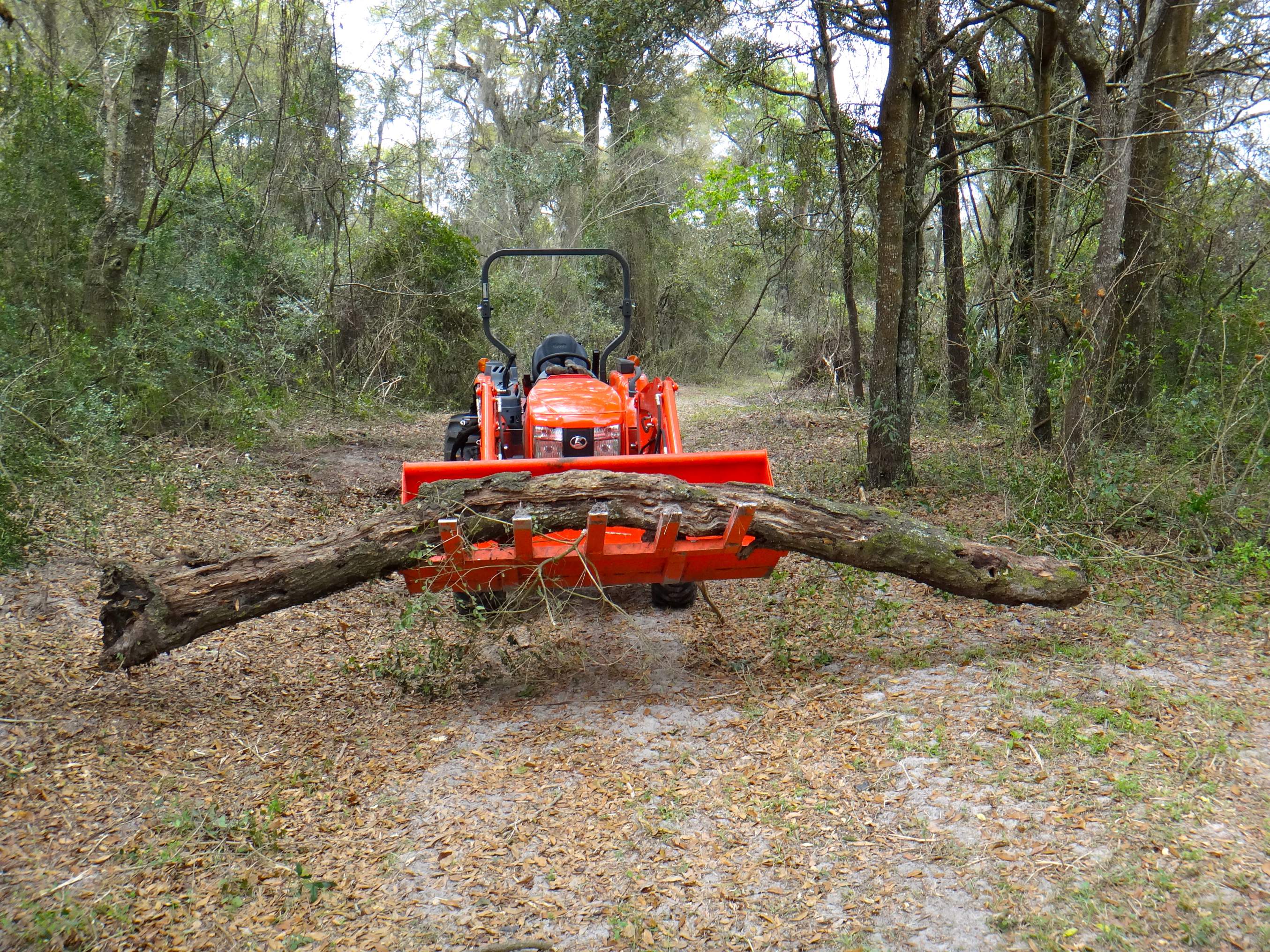

I have air-filled R4/industrial tires and LA805 loader on my L3560. I pull a Ford two-bottom, 12" plow and a Tufline Disc Harrow with 20" diameter pans weighing 915 pounds regularly without traction issues, over never-mud Florida sandy-loam.
For loader work I use a 700 pound, 60" wide everytfhingattachments.com Cultipacker for Three Point Hitch counterbalance most frequently.
Your loaded R1/ag tires will be 50% (estimate) more "grippy" on flat land than my air-filled R4/industrial tires.

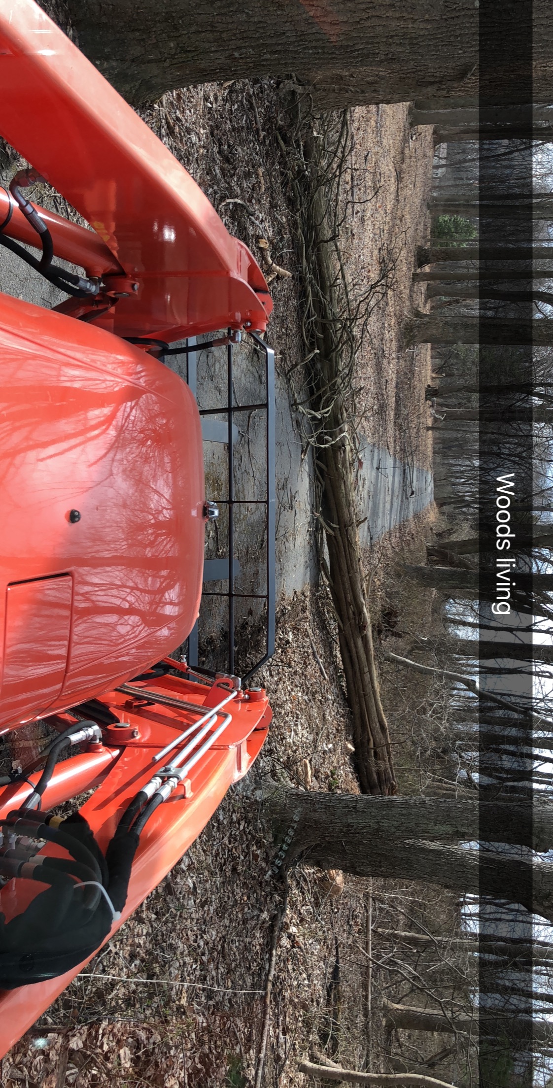

I had a big Cedar fall down across my driveway this weekend. Even with all the tire weight / ballast, the tractor still tried to pick up the rear tires. A 3pt hitch ballast box would certainly be more effective for dedicated heavy loader work. I still like having max ballast, on the tractor allowing me to keep my 3pt hitch available for other use.
