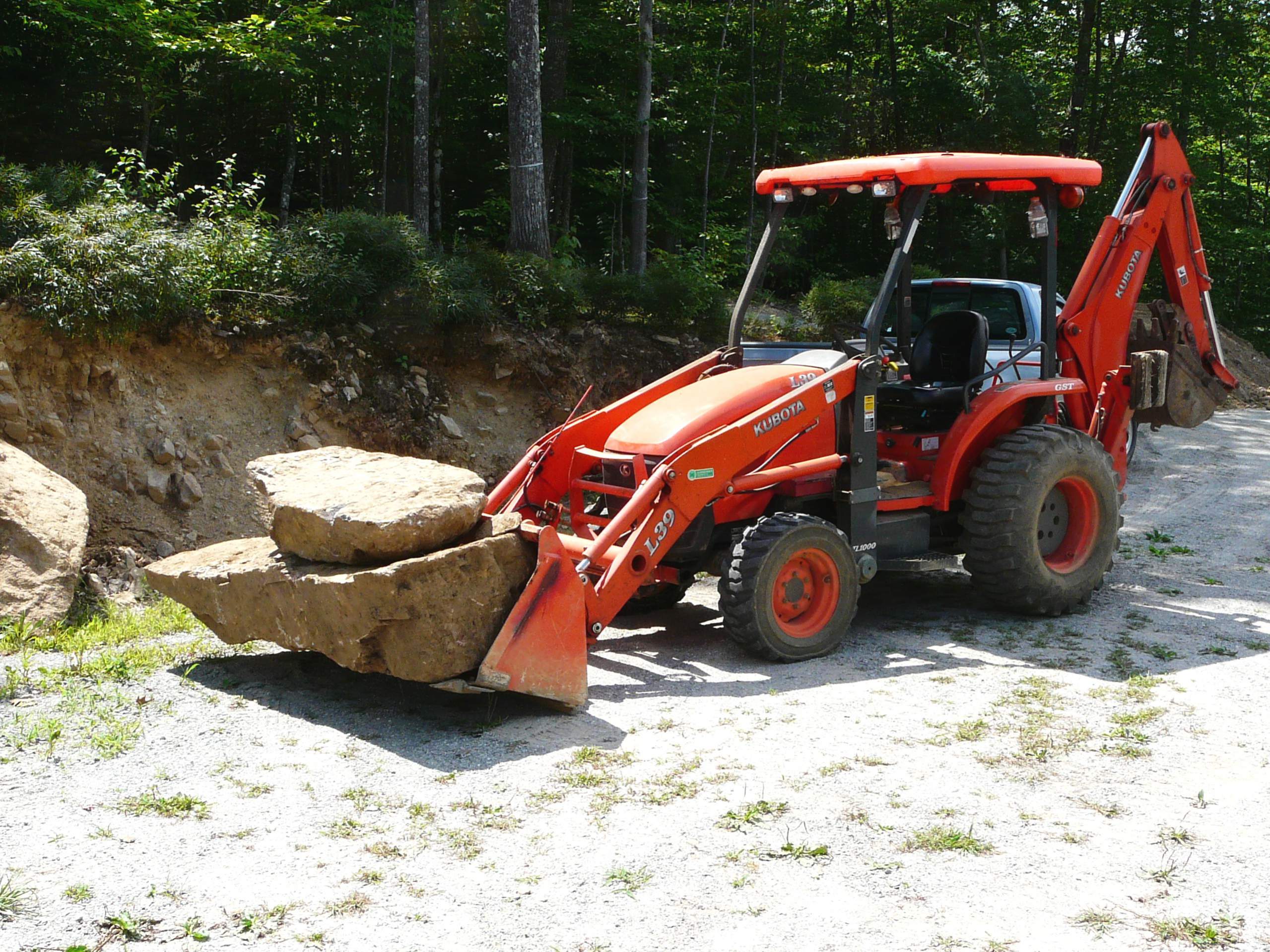

I only broke the front axle of my L39 twice in 2,200 hours of operation.
Fist time I hit it with my PC75 UU2 excavator.
2n'd time I dropped a big rock into the bucket with my excavator, and I did not have the L39's bucket firmly on the ground.
So neither of that stuff counts.
L39 is nothing more than a grand L with an integral frame, a bigger loader, and stronger hoe. L39 has same 'fragile' font axle.
Considering how hard I use my tractor, you would have to rather abusive to hurt the front end of a grand L.

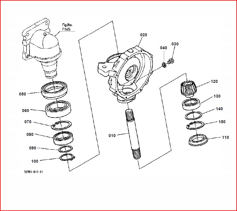

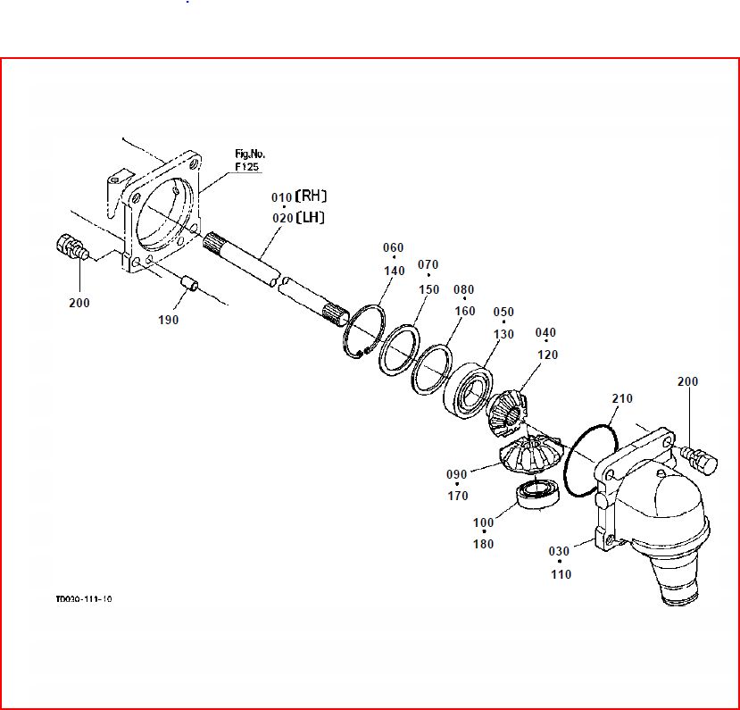

What part of the axle broke? Any pictures of the broken parts?
The L3940 has the same axle as the L3560 and L4060. The higher horsepower L60's, L4760 and up, have a bigger front axle. They also get the loader with more capacity.
   / Is adding max weight to a Grand L a good idea. #42
No Pictures
Once it just tweaked it and required bearings, seals, and shaft (010), the other time with the rock the casting broke (030.110).
