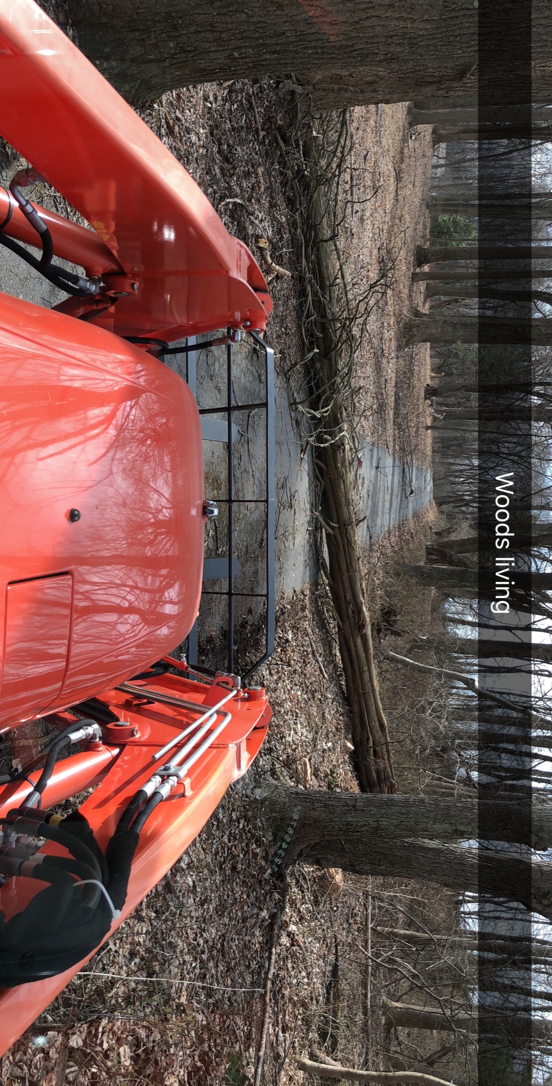

I recently bought a used L5740. On the way to New York to pick it up, I also stopped along the way to grab a used set of wheel weights. When I got home I realized the rear tires were already filled (washer fluid). At that point I already had the weights so I went ahead and installed them anyway. With the wheels set the to the "medium" track width configuration, all 3 weights fit within the wheel and do not extend but maybe a 1/2" out from the face of the rim. I'm not worried about soil compaction in what i'm doing, so I didn't see any reason not to have max weight.
I had a big Cedar fall down across my driveway this weekend. Even with all the tire weight / ballast, the tractor still tried to pick up the rear tires. A 3pt hitch ballast box would certainly be more effective for dedicated heavy loader work. I still like having max ballast, on the tractor allowing me to keep my 3pt hitch available for other use.
If you don't have proper ballast on your 3 pt, you are overloading your front axle if you lift much. The complex, expensive, fradgile, small front axle is rated for a lot less load than the rear axle. If you lift your rear off the ground, 100% of the tractor & loader weight plus a large part of that load weight ends up on the front axle. Not to mention the fact the front axle is on a pivot & will xa use you to roll.
Ballast on the 3pt tries to make the machine pop a wheely to some degree, taking weight off the font axle & putting it onto the rear. Wheel weights or filled tires help a bit, but ultimately don't have the leverage & make things worse if the back gets light at all. Think of a tractor like teter totter with 2 pivot points. You want a fat kid on one side to make sure only 1 of those pivot points is taking most of the weight.
Any reasonably heavy impliment will work as well as a basllast box. A long heavy rotary cutter or backhoe works best, but sacrifices manuverability. The further back & heavier within reason the better. Generally you want 3/4-1.5 times the weight you are lifting on the loader on the back.
