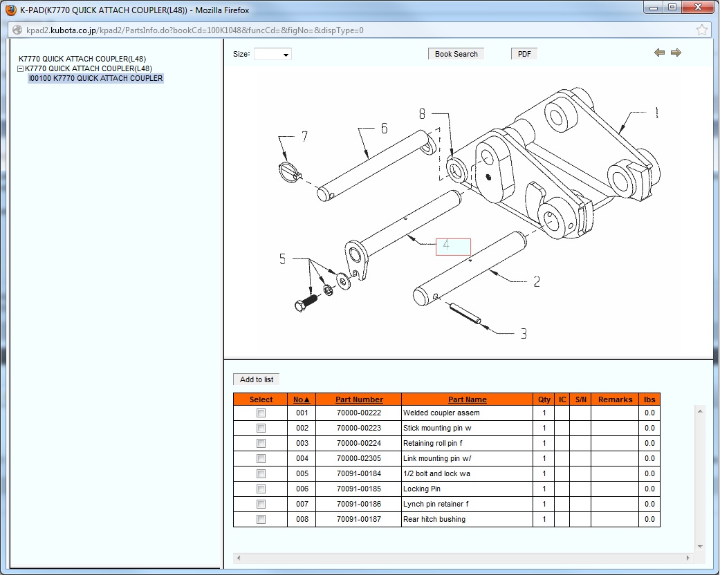

Lauren,
Having to swap quick releases would add even MORE to the cost. I have been trying to determine which quick release I have and determine if it is the "right" one for the Kubota thumb. I THINK Kubota needs the K7966 quick release for the thumb. I believe I have the K7770. I attached a picture of the quick release setup I have. Is this the same as the one you guys with the thumb have?
The other interesting thing is that Kubota lists the BTB404 as the aux hydraulic setup for the backhoe. This setup has hard lines and looks like it is installed outside the backhoe arm. I wonder if this is the setup they use for hoes not equipped from the factory with the thumb?

Yeah, I believe that. Trust me, the plan is to have a thumb. I simply don't have $3400 to allocate for one. I am 100% confident that I can fabricate one significantly cheaper for myself. I'm not even sure Kubota offers a thumb "kit" for the setup I have. Buying a replacement quick attach and modifying the buckets I already have will just add to the cost/work to the point that it will simply never happen. I have a plasma cutter. I have a welder. I have the motivation.
The only struggling point I have right now is fabricating the replacement pin for the thumb to ride on. If someone could take rough measurements of the diameter and the overall length of the pin the thumb/qr ride on I may be able to buy the part from Kubota and use it with my quick attach. That would be GREATLY appreciated.
