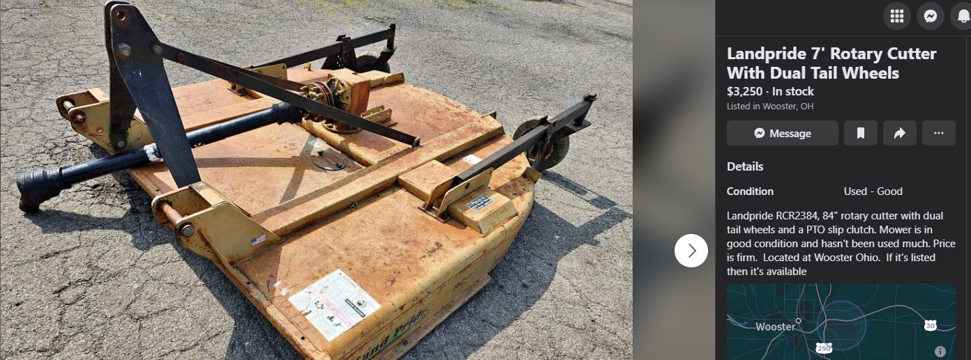

I was initially thinking of something like this... but you guys have me sufficiently thinking it might be too big.... I will probably get something like this for my my MILs tractor it is 36 pto hp. I'll get a 6' cutter for mine with the 32 pto hp.
   / Is anyone running a 7' cutter with less than 32 pto hp? #17
wise move, & good luck w/the purchase
You can get a brand new bush-whacker hd-72 for less than that the md-72 are even less
