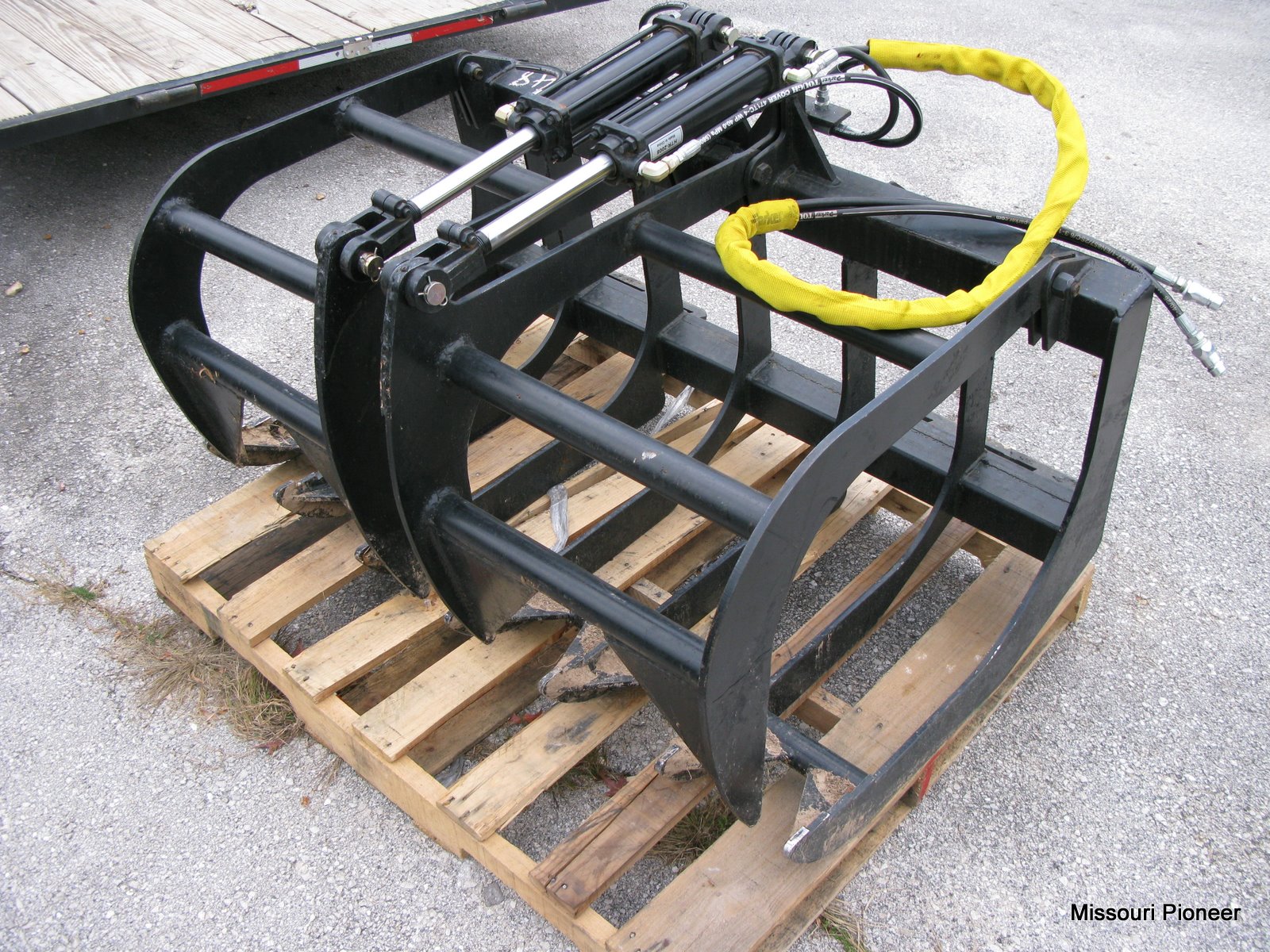

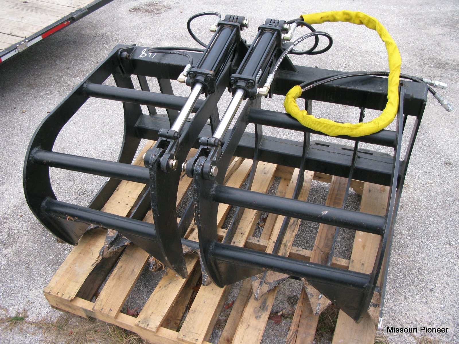

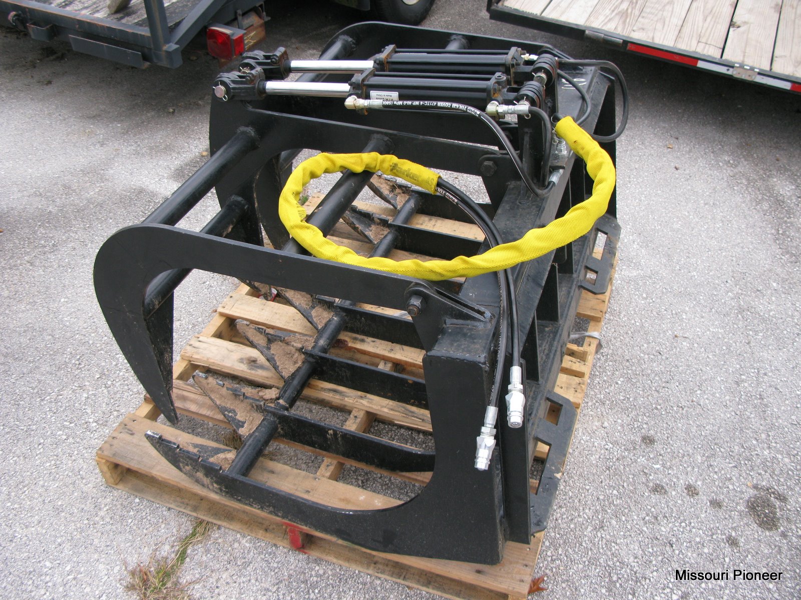

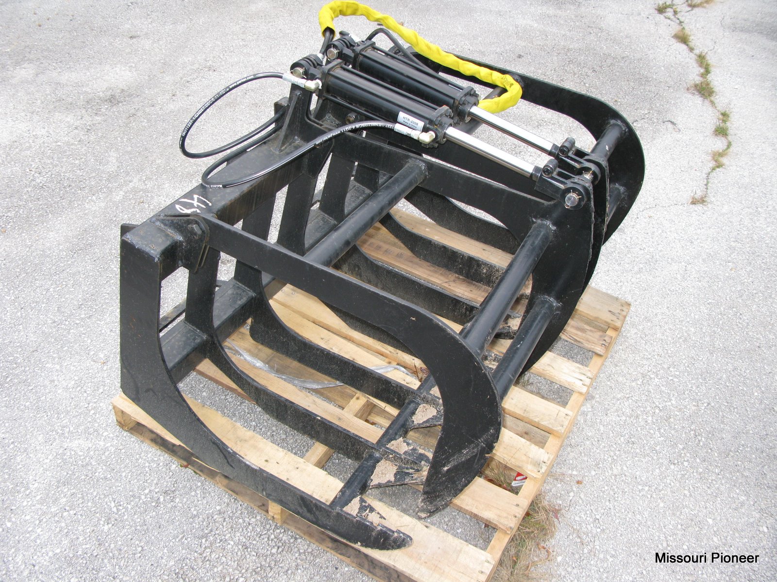

Island, notwithstanding the photo on ebay or their web site but much to my delight, my universal skid steer mount 48" Wildkat grapple came with TWO top arms - each with two points - and TWO cylinders.
PM me with your email address if you want a photo.
   / Is Gator Attachments still in business? #16
Two top arms on a 48" grapple???? Interesting. I'd love to see photos and hear how it works.
I would think that the single wide upper arm would be sufficient and would weigh less and presumably cost less too. For most folks I'd say that would do. I'm sure the double arm version will do the job too, I've just never seen a double arm 48.
What did yours cost? I found the closed ebay listing for the single arm version and must stay that at $599 that is a steal. They don't list the econo 48 model on their regular website for some reason.

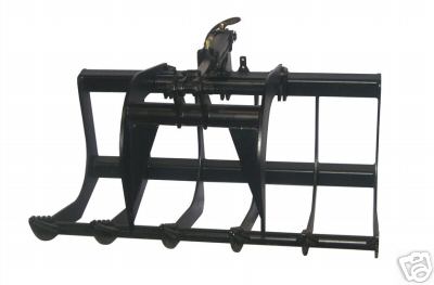

Photos below are of my Millonzi 48" light duty grapple.

Thanks for the "how to post" info, Island. I had to figure out how to re-size, too. I think I have it down now. Here are the photos of my 48" WildKat double arm grapple.
I haven't been able to REALLY put it to work yet, since I just ordered a tandem dually gooseneck to transport the equipment to the farm. I'll begin work there after deer season.
