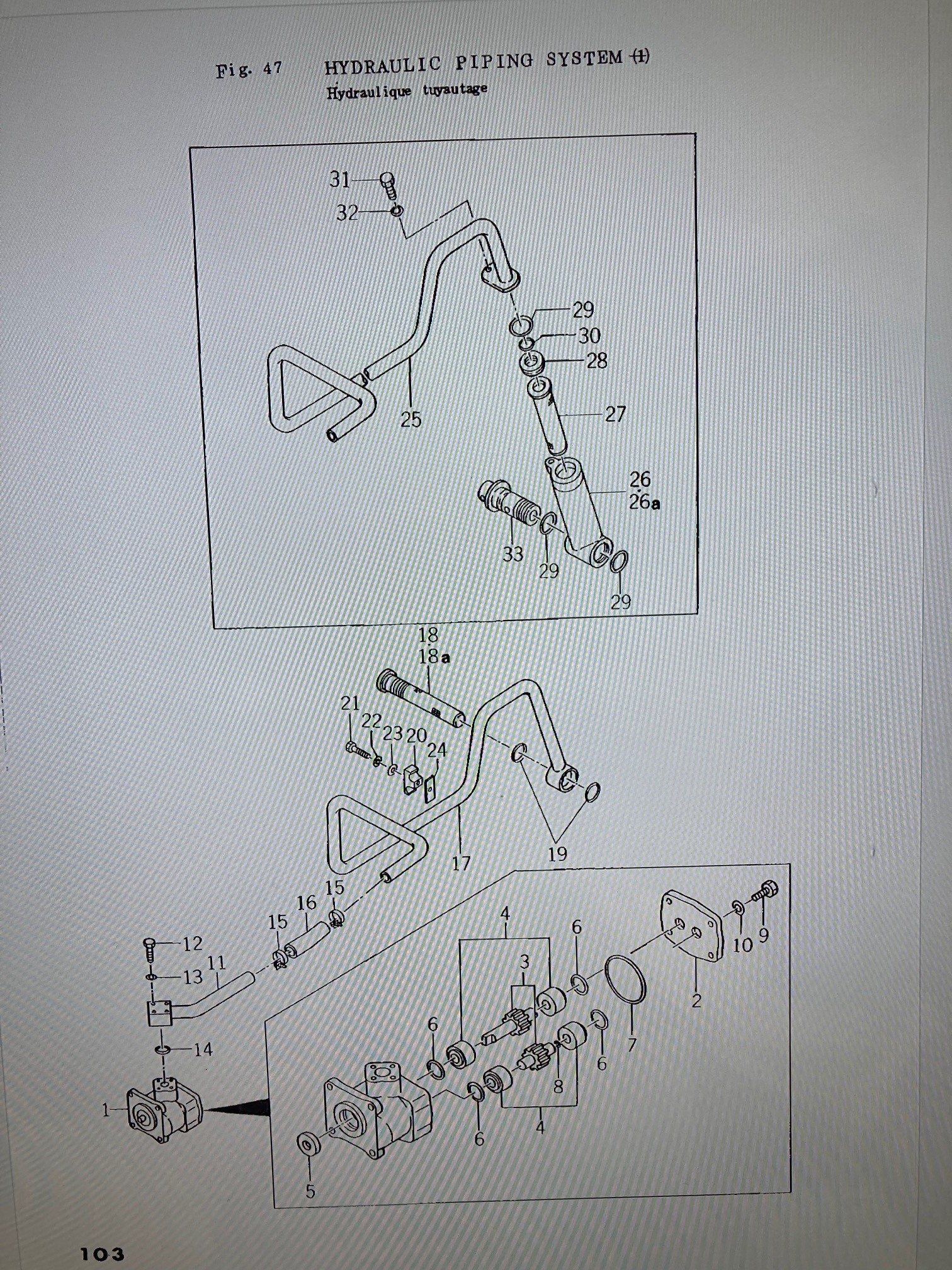

Hallo
I just bought a Tx 1300F that had been sitting for 10 years so i got it quite cheap compared to other Isekis with a FEL ( But maybe not cheap enough)
With a little bit of coaxing i got the engine started so i knew that was working when i got it home. I have avoided running it before i could do a service.
First up was changing all the fluids and found some issues with the gear/hydraulic fluid.
It had water in the oil and the filter for the hydraulic was dissolved and i found some pieces/teeth for the third gear for the PTO in the bottom of the gearbox.
And surprise, i cant get any circulation from the pump. let alone pressure. I can get it to work for a few minutes, then it stops working. I seem to get some oil coming through the return for the FEL in the start but it stops after a few minutes.
The 3 point has not been going down on its own when it sat in the raised position while i was waiting for parts. I have managed to get it raised a few times.

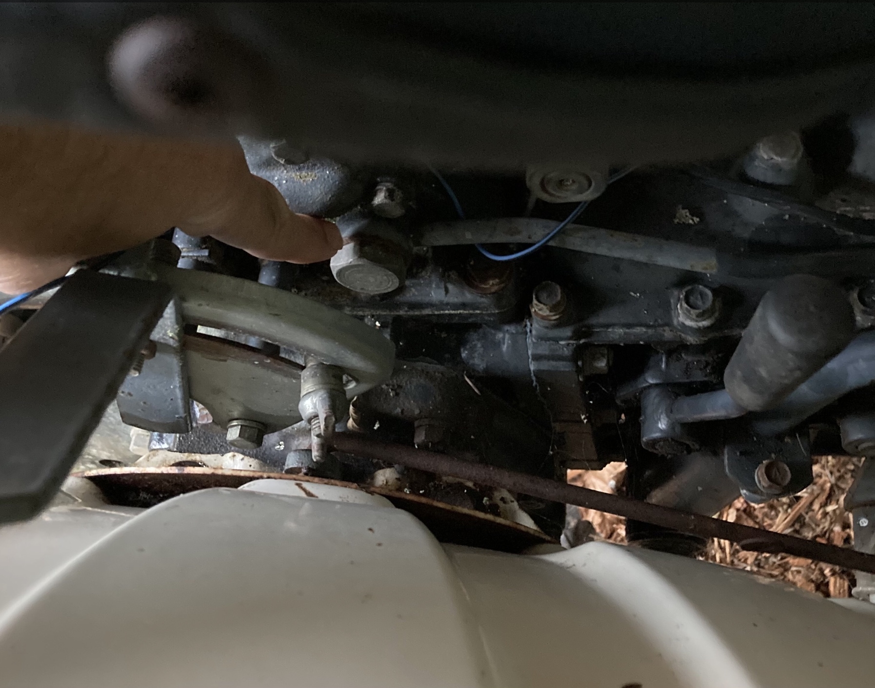

Tried the bleed port next to the speed control leaver for the 3 point. That did nothing. The pump also gets warmish with the engine running for only a few minutes.
Disconnected the outlet and ran the starter. I get some oil coming through but not a lot and it seem to come in bursts, not a steady flow.
Is there anything special you have to do after a hydraulic oil change that i'm missing or is the pump dead?
With the filter completly ruined it has been eating gravel for dinner so its no wonder if its dead.

I could be wrong but I believe those tractors have a screen/strainer on the suction side of the hydraulic pump. Did you pull that out to give a good cleaning?

That filter was completly destroyed. The screen was all mangled up. No idea how that could have happened. So the pump probably has been running without a function filter.
   / Is my hydraulic pump dead? (Tx1300F) #4
If there is no screen there is a good possibility the pump is shot. I usually supply an external screw on filter in these situations. I may have a used pump or can supply a new one.

That would have been really nice. Sadly i live in Norway, so shipping will be a hassle. Bought a new pump now so hopefully everything works.

So i got a new pump installed, changed the oil (again) and cleaned the filter. Hoked up the FEL on saturday and did a small testrun, everything was working fine.
Today i moved some dirt around and after about one hour the hydraulic started shaking/shuddering, both on the FEL and 3 point when raising either the FEL or the 3 point.
Thought maybe the filter was clogged so i drained the oil and took out the filter wich looked fine. Filled it back up and it was working for about one hour before it started shuddering/shaking again. Noticed that the oil flow from the return was intermittent as well.
What is going on here? Seems to happen when the pump is getting warm.
Is there a airleak on the suction side?
