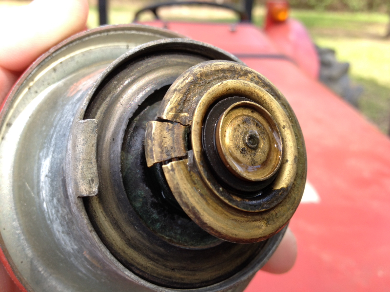

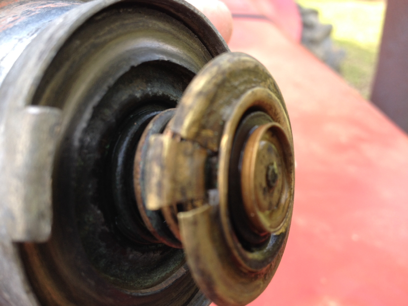

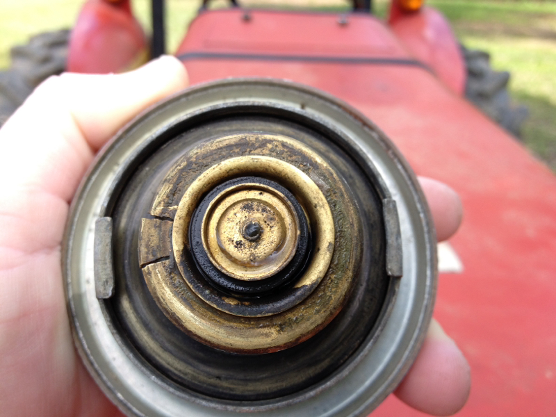

Ok I may have found the problem, or A problem...
I tilled while ago for about 10 minutes. Needle didn't get in the white, but was definitely high green.
Anyway, i stopped tilling and immediately opened the radiator cap. I heard absolutely "NO relief of pressure", bubbling, or steam.
I have no idea how long the radiator cap has been broke like this (or started with an un-noticed hairline crack) but I'm wondering if this has anything to do with the situation?
IF THIS IS THE PROBLEM, IM ASSUMING that the water pump was working extra hard, just enough to keep the engine from overheating when running at "normal" temp. (The reason why it was getting too hot so quick under a load)
Please correct me if my thinking is wrong...

   / Is my MF 231 running too hot?? #92
You need a new cap, but it won't change the temps or how fast it heats up and got nothing to do with how hard the water pump has to work.
   / Is my MF 231 running too hot?? #93
A broken seal would result in a lower boiling point.
   / Is my MF 231 running too hot?? #94
Increasing the boiling point would only help if the tractor was boiling the coolant out, it's not so there will be no change to the system.
   / Is my MF 231 running too hot?? #95
I agree but the cap is why the boiling point is raised by putting the system under pressure. The Tractor is NOT getting hot enough to even boil over.
