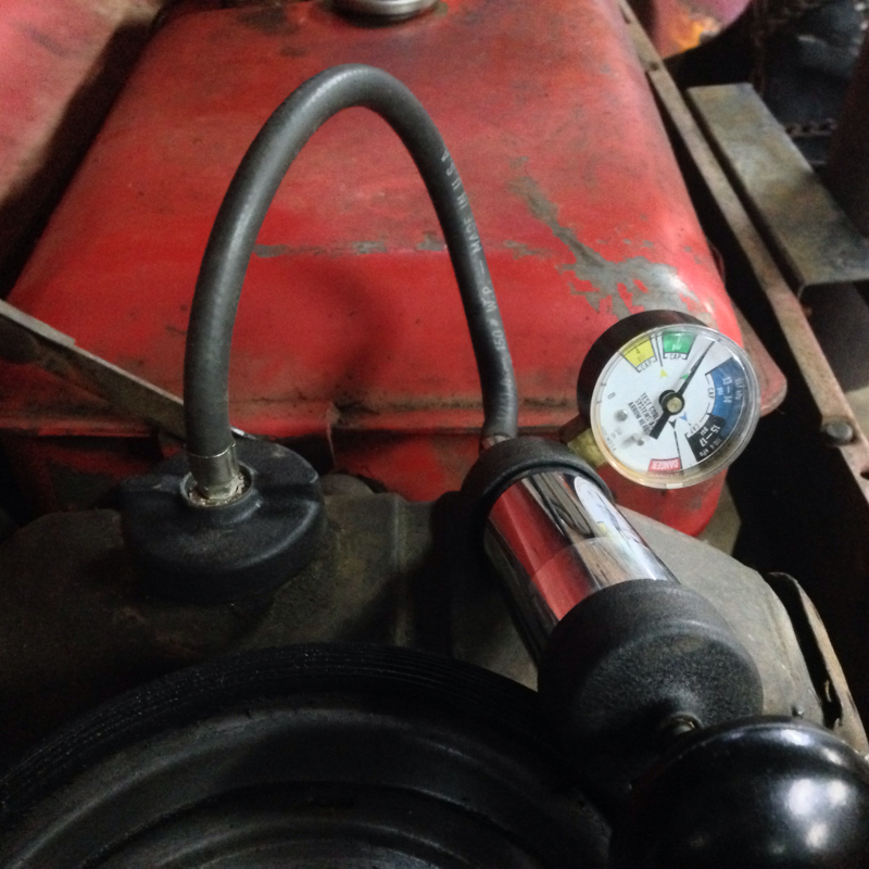

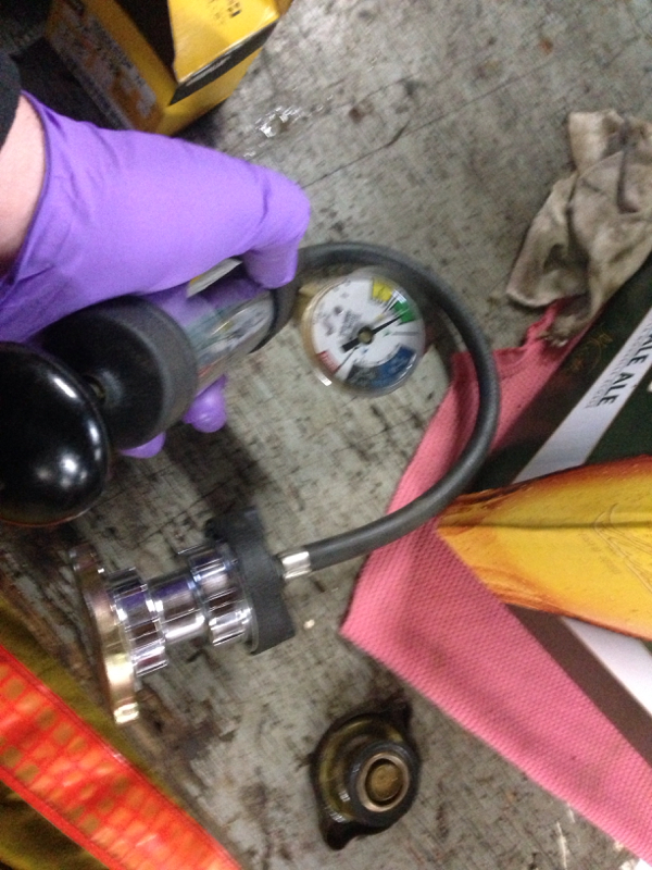

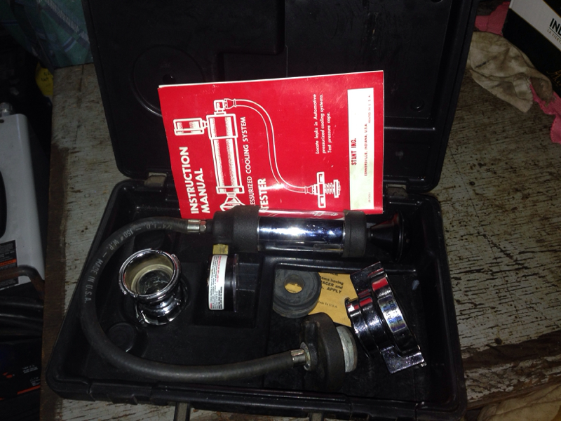

Earlier in the thread it was asked how to test a cap, in your case it was apparent but otherwise you use a coolant pressure tester.
The cap should relive and reseat within the spec range in this case 7#.
Also you can pressurize the system to simulate operating conditions to check for leaks.

I bet that set up is expensive!
