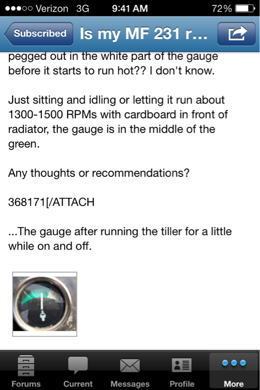

I have no pics of the gauge in white. But here is a pic of light tilling, with cardboard in front of the radiator. The tiller was running on and off for a short period of time. Look at how the needle is almost in the white.
This was on page 2 right below half of the page...

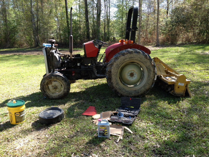

Since I already got the fuel tank off, I'm gonna change the thermostat. I'd be crazy not to. Plus it's a good time to change the fuel filter since air is already in the system with the tank being off.
I will be happy (peace of mind) that AT LEAST the Tstat will be changed because if the water pump ever needed changing or the radiator needed to come off, fuel tank would NOT have to be removed again.... I don't know for certain, but I would think this is the original thermostat since the tractor was new in '98. I bought it with 480 hours 7 years ago and now it has 1,153 hrs.

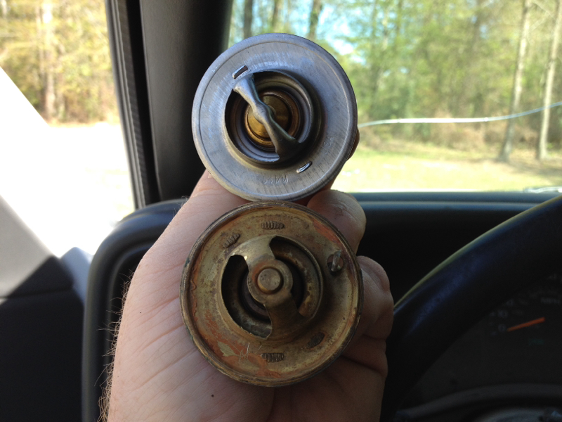

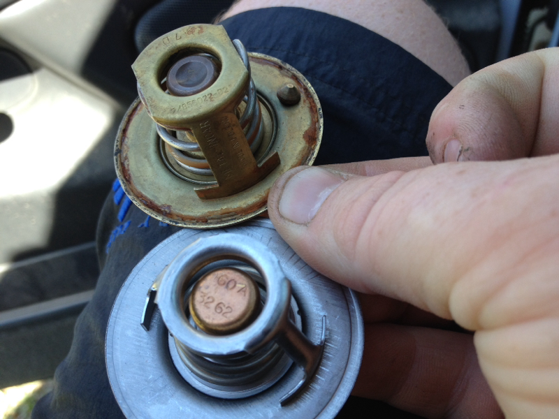

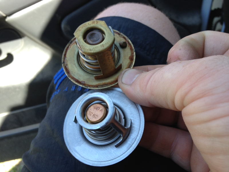

Ok here is the pics of the 2 thermostats. Easily to tell the new one from the old one... Both Napa stores had the 160 degree Tstats. Not the 180 like I mentioned before. So this is a 160 that I put back in it...

Looks like the old was all metal. Let us know if you see any improvement when you get her back together. Hopefully your issue will be resolved. For kicks take old one home and place in cold water on stove. Put burner on high to see at what temp it opens. Provided it works properly I would expect it to fully open by 200F
Sent from my iPhone using TractorByNet
   / Is my MF 231 running too hot?? #58
You should put the old one in a pan of hot water and heat it on the stove checking when/if it opens with a thermometer. Inquiring minds want to know.
