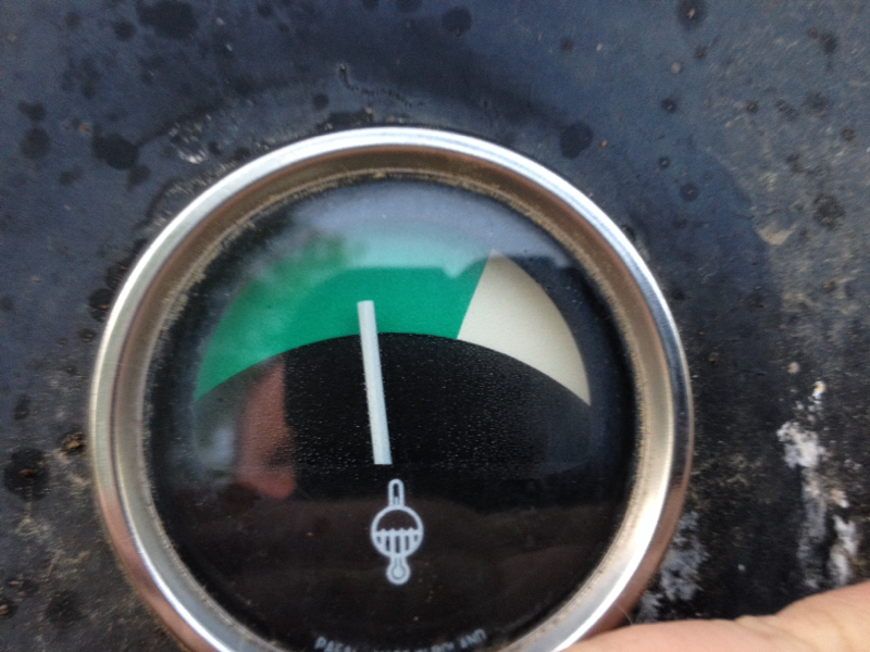

So here are the results! There was definitely a problem with the old thermostat. It is running much cooler now. The max temp at the thermostat housing now is 158-162 degrees.
Here are some pics with descriptions...

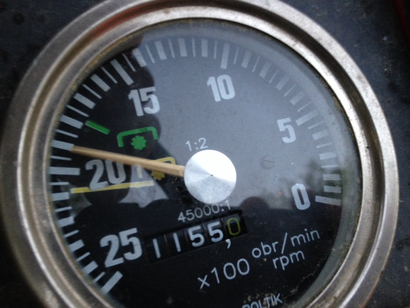

This a pic with the engine running at 1900 RPMs with no engine load and nothing but water and the radiator flush/cleaner in the system.

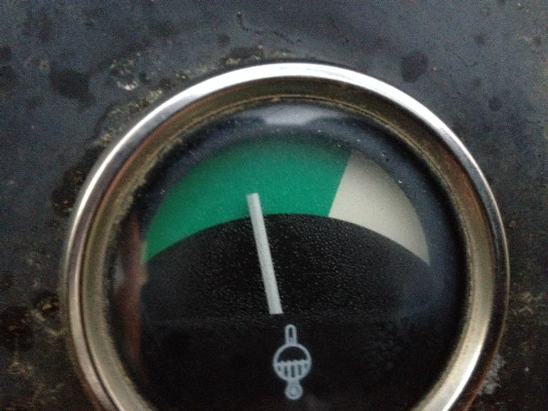

Here is a pic of the radiator completely blocked with cardboard, no engine load...
Here is the temp reading with the radiator blocked with cardboard idling at 1900 RPMs, no engine load...

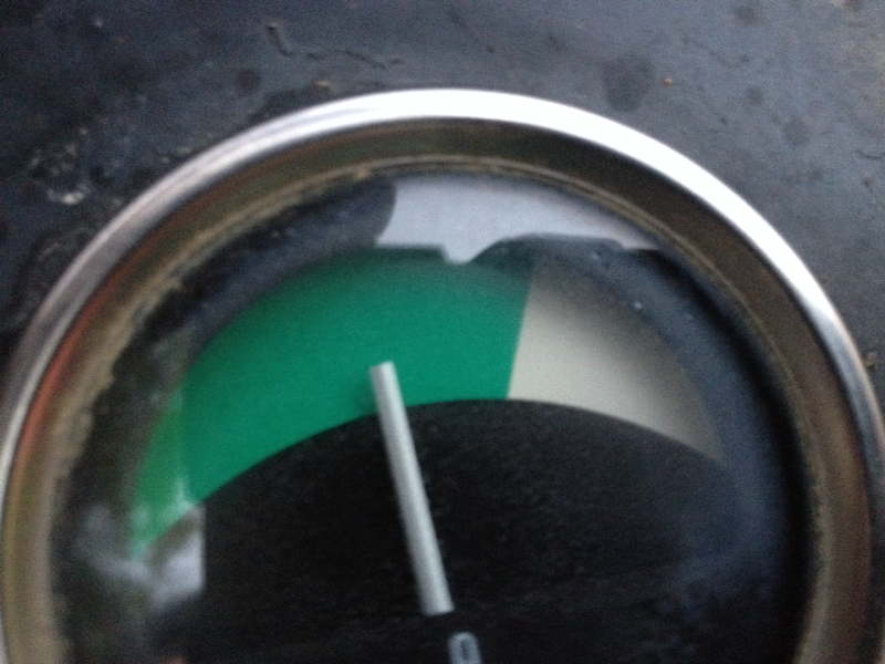

Idling at 1900 RPMs, no cardboard, no engine load...
And here is the pic idling at 1500-1800 RPMs with no cardboard, no engine load...

You want really know till you load her up. This is because the other thermostat may have been the 180 one. Run the snot out of her and let us know. What we are looking for is a max temp. If it continues to rise under full load then there is still a flow issue. Let us know.

Put the old one in a pan, heat it up with a thermometer. Then you will know when it opens
