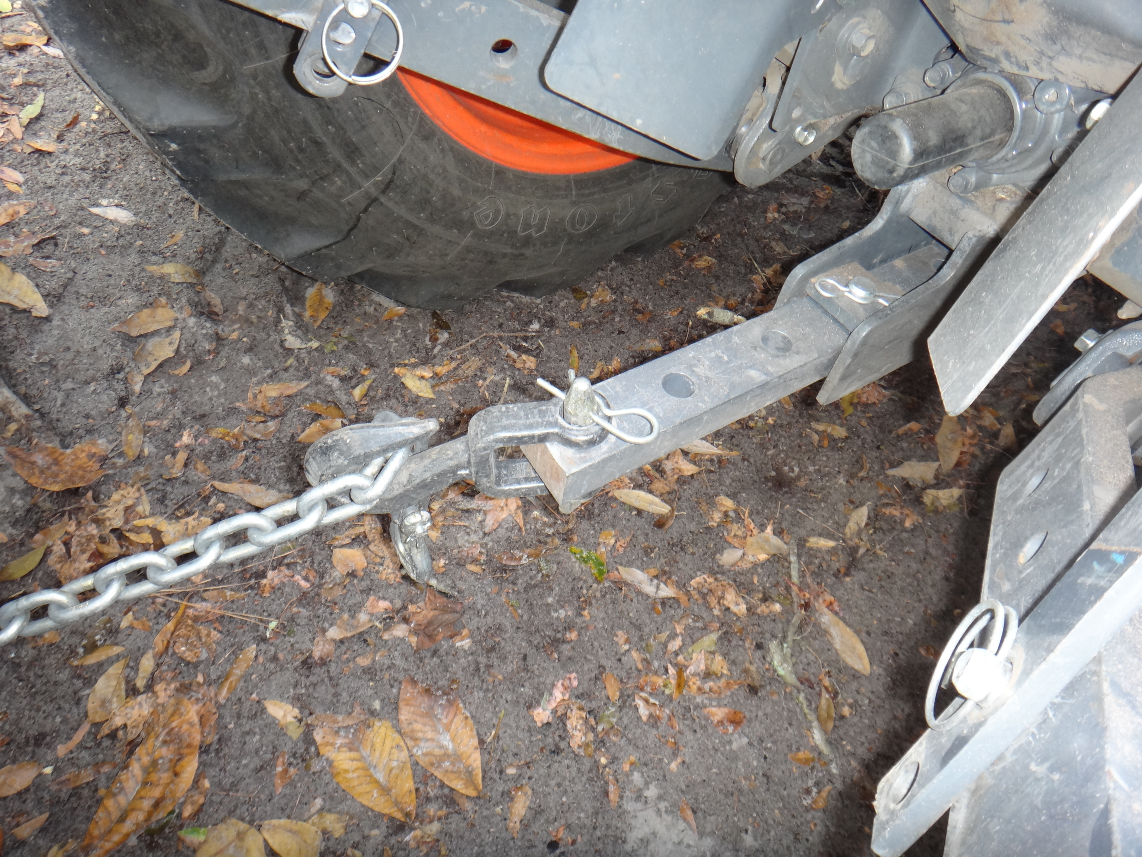

good catch. I was looking at the tractor's hydraulic spec "Lift capacity at lift points: 1918 lbs", not the FEL's capacity.
Enough for me to move trees, but not enough to move my pallets of brick.
Know that pallet forks are available for the Three Point Hitch at the rear.
LINK: King Kutter Tractor 3 point hitch Pallet Mover pallet fork attachment
L2501 Three Point Hitch lift capacity 24" behind eyes (center of a 48" pallet) 1,389 pounds, including weight of forks.
If your ground is flat, you can drag your pallet of bricks a reasonable distance using is 1/4" or 5/16" Grade 70 chain attached to tractor rear/center drawbar. The oversize rear wheels provide tremendous mechanical advantage when pulling any type of load. (1/4" Grade 70 chain would be my choice.)
Some buy the engine hood of an old car at a salvage yard, using the hood as a sled to pull heavy boulders or other heavy stuff.
