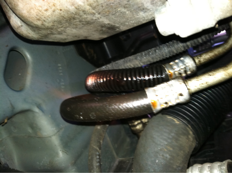

At least aftermarket lines are available. I was crawling under our Chevy HHR and I see that both tranny cooler lines are leaking. GM lines are the only replacement available. Now I just have to figure out how to top off the "sealed" transmission.
Nice, seems like the same crappy design.
The sealed trannys I have been around have a sight plug like a gear box that you use a pump to get the fluid in.
Good luck.

That's just plain foolish. The aftermarket kit can be had for about $100 and after you install it your done with it. For me my time is worth more than messing around at the dealer,warranty or not.
HHR, just replace the lines with hydralic hoses. A local hydralic shop can set you up with them. Not sure on the HHR but the GM lines need to be at least 300psi rated.
