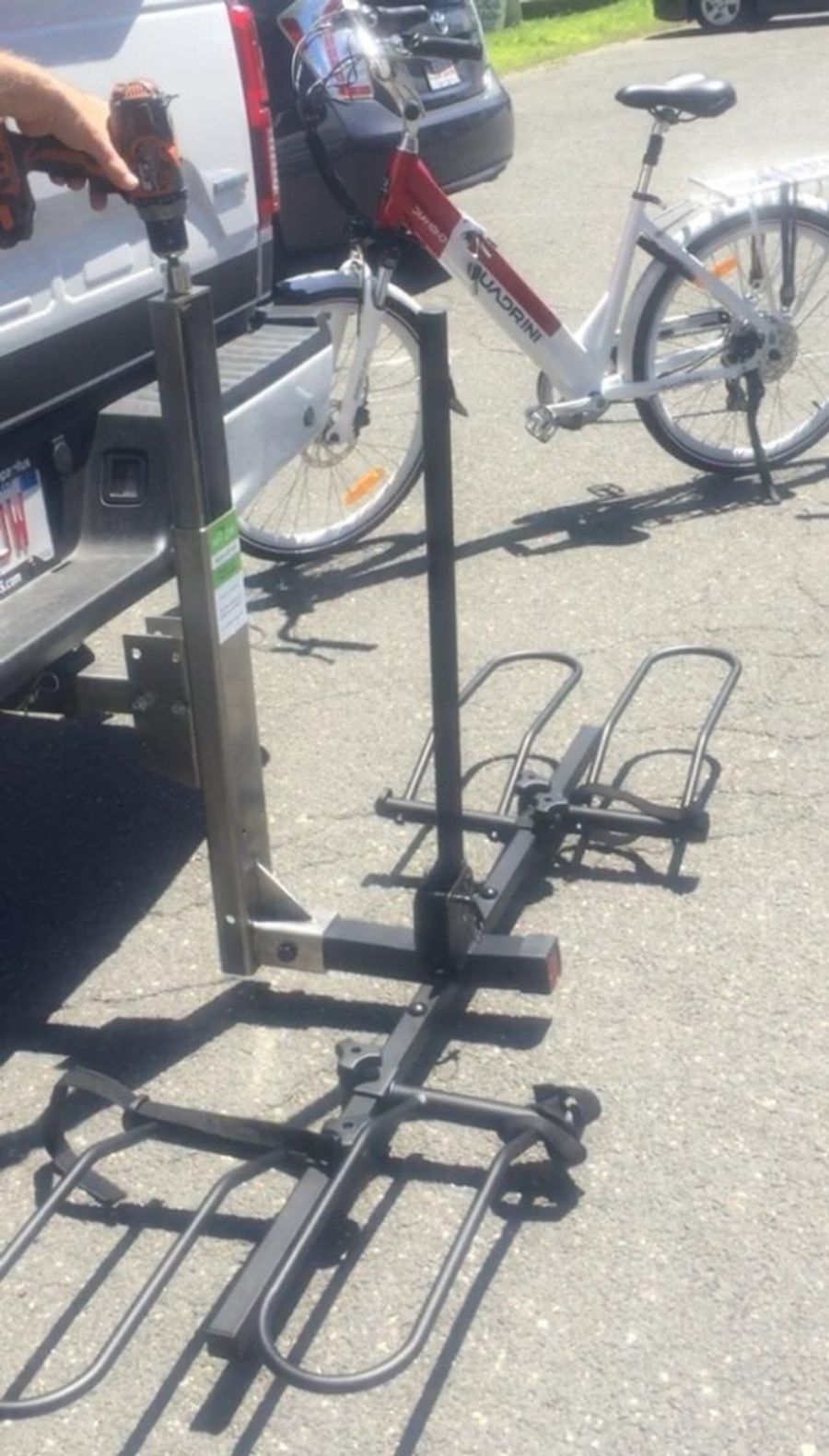

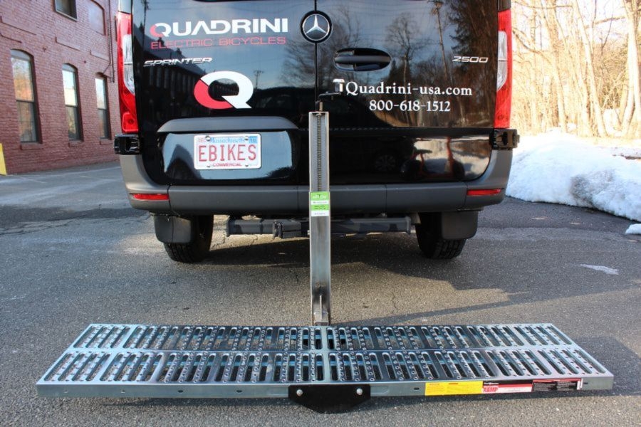

At my age, lifting anything into the pickup bed is a hassle.
I bought this electric receiver hitch jack to make it easier to carry my heavy electric bikes.
To carry gas cans, I remove the bike rack from the hitch jack and use a simple cargo carrier. That way, the cans sit on a metal platform which rests on the ground when filling.
The hitch is raised using a cordless drill or with the optional motor, which plugs into the 7 pin trailer connector.
Not a cheap option for just carrying gas cans, but in my case, it serves a dual purpose.
