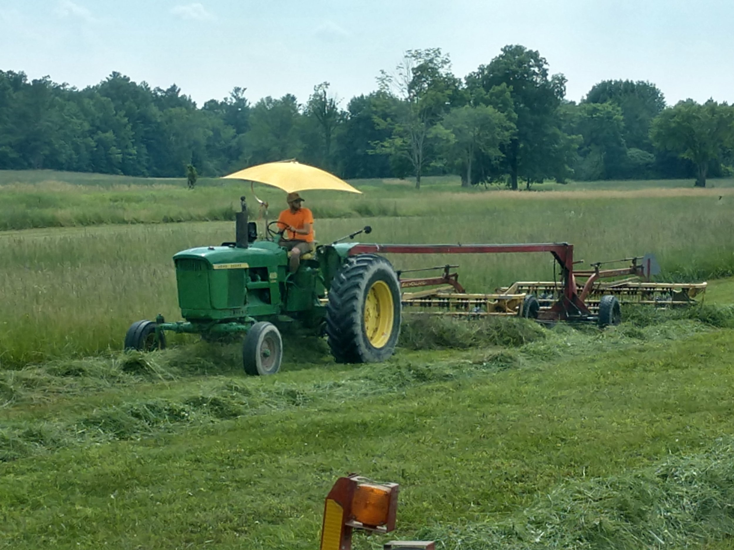

Here is the farms with my nephew raking hay;
The little 3 point hoe didn't like the JD 4020, it is plumbed to use the tractor hydraulics and the older JD closed center system did not like the open center valving on the hoe.

That pict. doesn't show the tractor with the rubber that normally came on a 4020...

If the backhoe mount was designed to keep it at the right height it wouldn’t matter how high the tractor was. If you take a backhoe designed for a little tractor and slap it on a big tractor it’s probably not going to work good.
   / Is there any size of tractor that is too big to add a backhoe on it? #29
Hard to tell from the pictures what size do you think it should have;
I've seen them with 15.5/16.9 to 18.4's
and 32 to 38" rims.
   / Is there any size of tractor that is too big to add a backhoe on it? #30
I don't know what it "should" have, I only know of the 4 new ones bought around here, all of them came with taller rubber.
Yeaa, I know 4 isn't a big sample...
