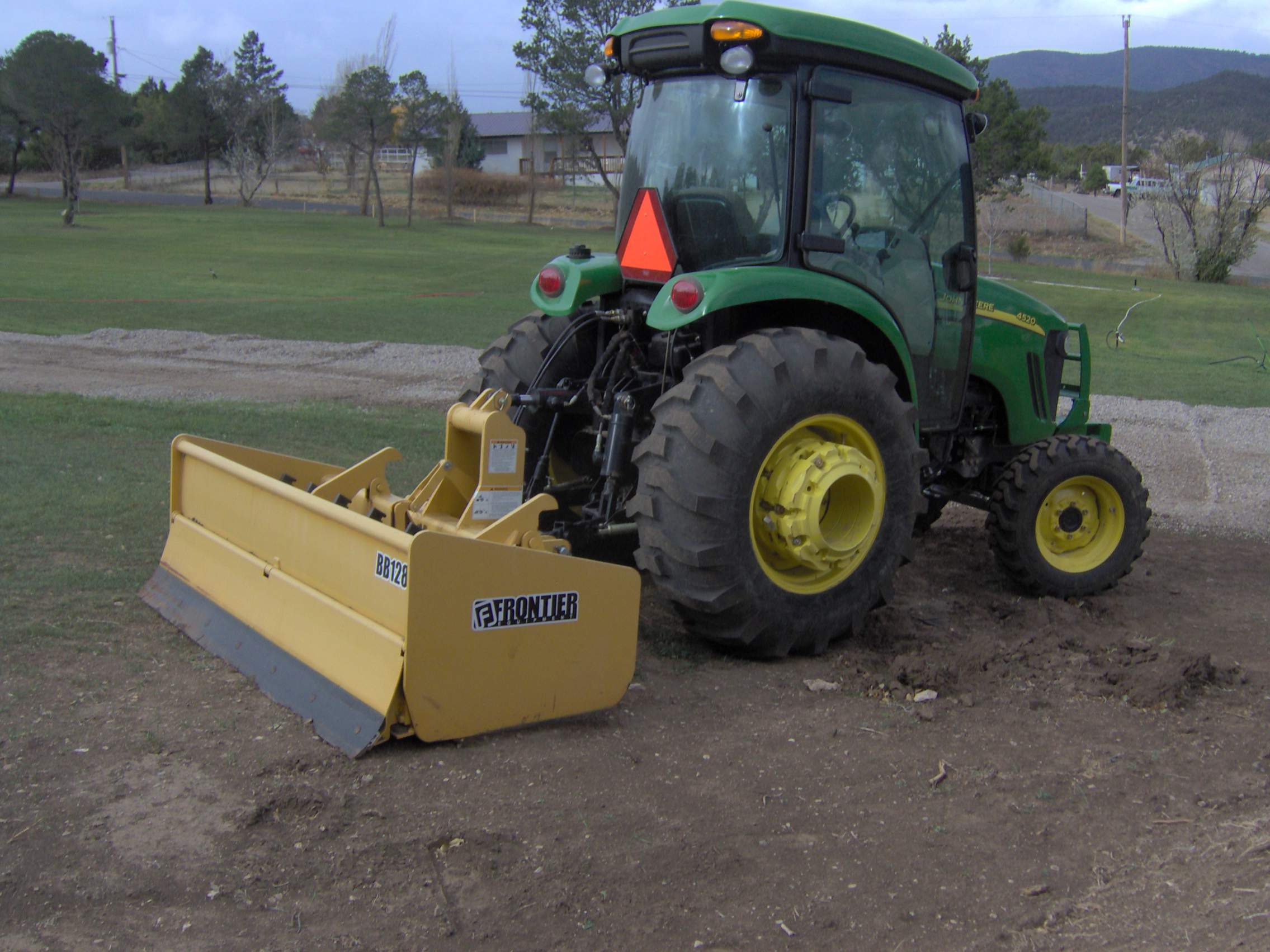

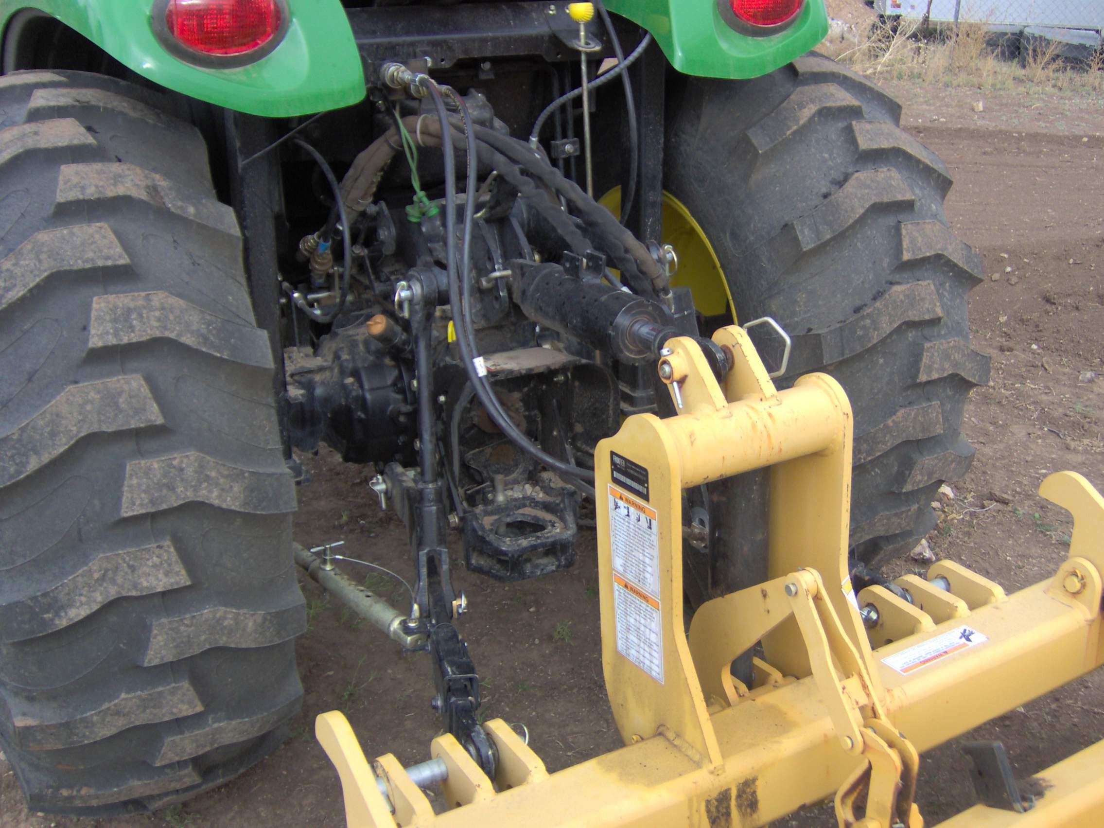

As I recall the down force option eliminates too many other hydraulic options to make it reasonable. I don't think you will be able to do near as much with it as a tractor with proper ballasting and heavy implements. My 4520 has 1100 lbs of steel weights and WWF in the rear tires. The box blade pictured is 7' and 1260 lbs.
Notice the 3 pt arm hookup, normally goes along with a better quality than the single pin tab on other's, other's may disagree, my .02 cents.
