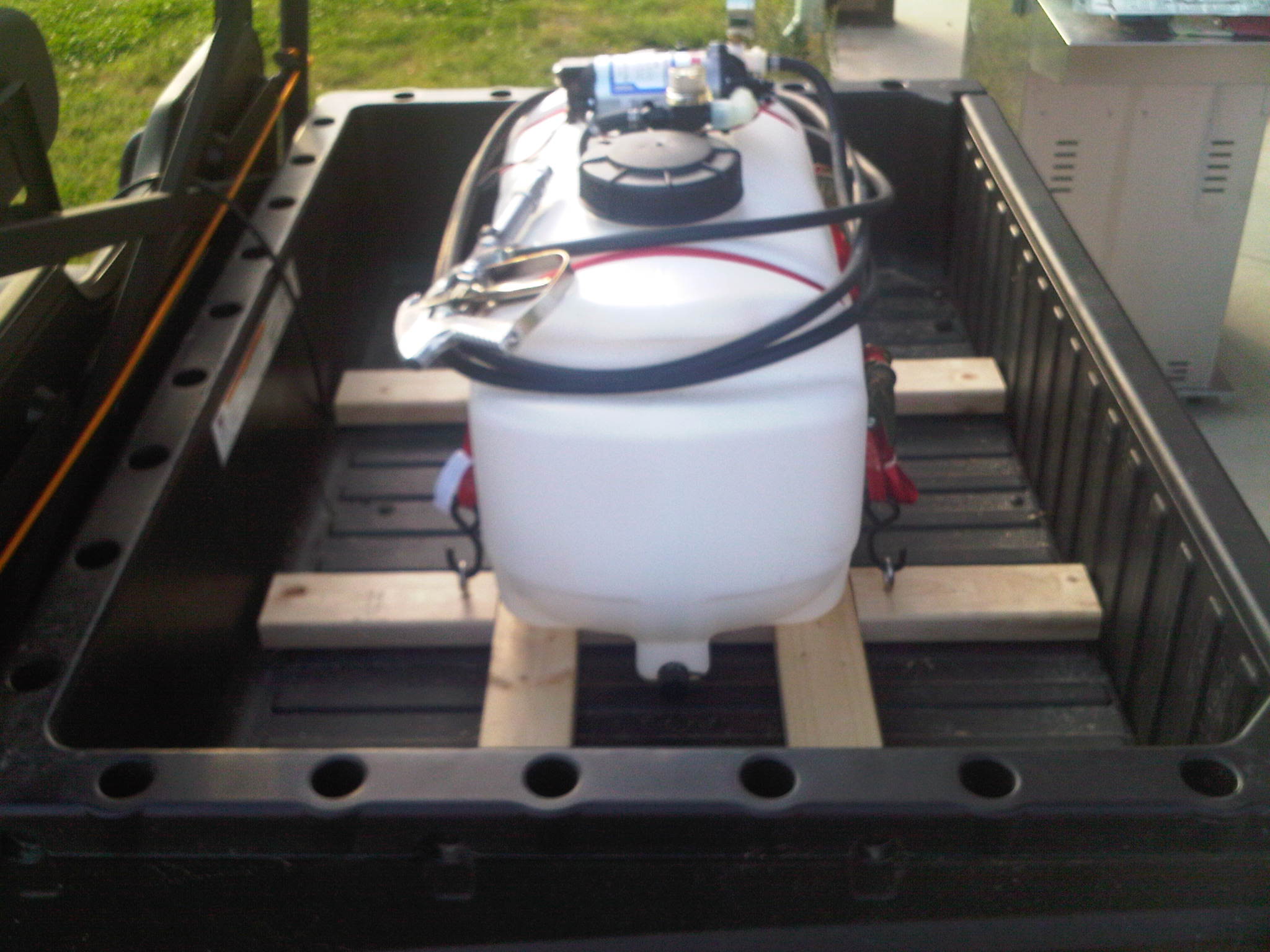

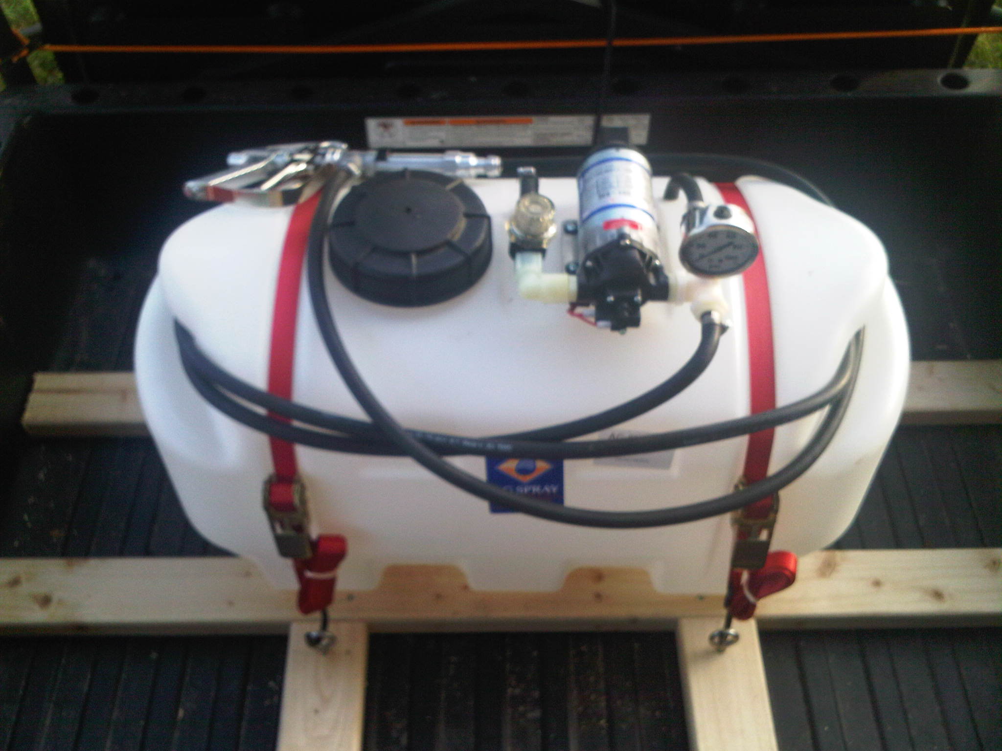

I purchased a 25 gallon spot sprayer earlier this year to used in my Polaris Ranger.
Ag Spray Spot Sprayers
I purchased it from our local Co-Op in TN. It is more expensive than the one that you are looking at. I am very pleased with it. I have not found a weed killer that I am happy with yet.
I did not want to drill holes in the Ranger's bed so I came up with this method to mount it using lap joints. The sprayer does not move around in the bed at all. When I am done I just lift out the sprayer, frame and all.
Thanks! That's a great mounting method :thumbsup:
