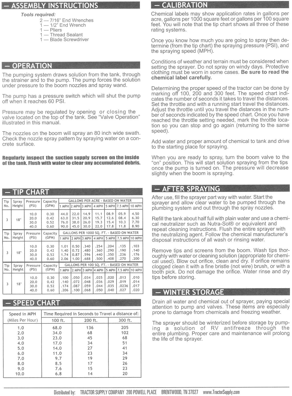

Just out of curiosity, how much ground will a 25gal sprayer cover?? I know there's a lot of devil in the details (application rate, height of sprayers, etc) but could you give me a ballpark WAG?? Gonna need one of these myself come springtime and with 4 acres, was wondering if this would work for me or if I need to go smaller/bigger... Not purposefully trying to 'jack your thread, but since the topic is open?? Thanks! :)
Here's a scan of the application rate page in my new sprayer's instruction booklet:
attachment.php
   / Is this 25-gal sprayer decent at $150? Suggest a weed killer? #29
This all depends like you said on many things. But is really dependant on the label of whatever your spraying. It will give you a dilution rate and an amout of water to use it in. This will depend on weather your spraying grass thats knee high or 2"s high. The taller the stuff the more surface area so the more solution will need to be applied to any given area. Industry standards (terminology used in spray rates and on lables) refers to a fine spray as 28 gallons/acre and a runoff spray is 110 gallons/acre Coarse is inbetween those.
This does not mean that you mix up 28 gallons an acre to kill low weeds on 1 acre, you need to read the label to see what your chemical calls for as far as amount of concentrate in X number of gallons and the amout it calls for a given area. Trust me this can be drastic between chemicals.
