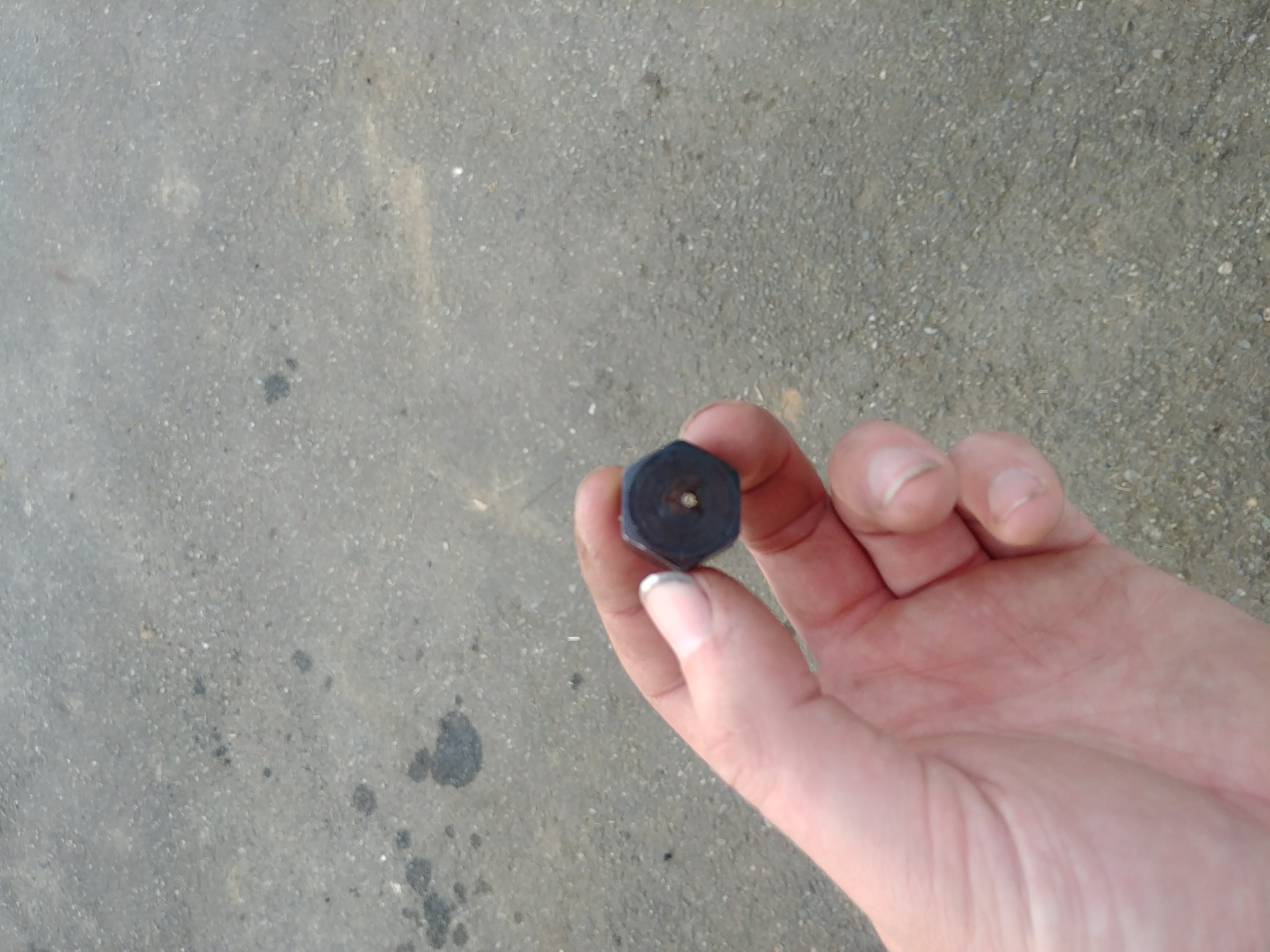

ok the backhoe is hooked up and it works!
its actually quite speedy with the tractor at 1000rpm with decent power. maybe a bit too speedy actually haha.
however i do have a question -
on the 2 cylinders that control the left to right swing. theres these nuts that screw on to what im guessing would be where a return hose would go.
when i first tried that backhoe functions and swung to the left a bunch of fluid sprayed out. i assumed a hose was blown but looking closer it was coming from the bolt. i took it off and the bolts have a hole in the top.
its like a breather almost. after the first bunch of fluid came out it seemed to stop doing that. im guessing some fluid leaked through some seal over the time it was sitting. you can hear air blowing through when you go left to right now.
im wondering if this is how its supposed to be? should there be a filter of some kind on them?

Chris
You have a homemade vent. The proper one is this style.
Crystals of bronze are fused together to make a porous matrix for air to pass through but filter out dirt.
If you have leaking piston seals some oil will get past the piston and start coming out the vent. A small amount is not a problem.

Ah ok great. I'll have to get a proper one. Whoever made this just had what look like some couch cushion stuff through the hole to act as a filter.
Why would these cylinders need a breather but not other ones?
   / is this a power beyond valve? #35
All the other cylinders on the backhoe are probably double acting, so they don't need a breather like that one does.

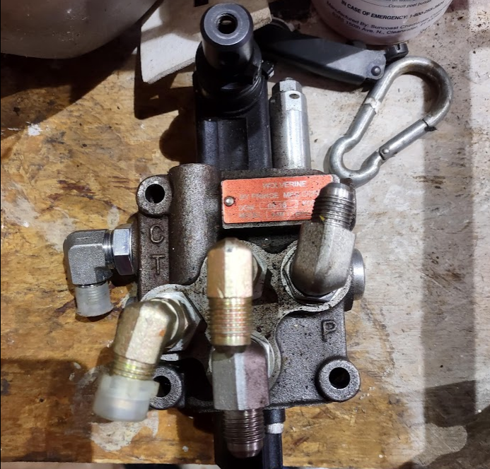

The "assembly" beside the two control levers is the adjustable relief valve. Most open center farm tractor type loader valves have them.
Let me explain a little further. Should you have a power beyond circuit coming from the loader valve and going to a second control valve,for a top and tilt for example, the second control valve also has a relief valve.
The FEL relief valve is set at 2,200 psi just to pick a figure. No matter what you do to the relief valve on the top and tilt control, it will never produce pressures higher than the FEL relief valve as the FEL relief is dumping any pressure above its setting. If you wanted the top and tilt relief valve set to 1,500 psi, you can do that and not affect the FEL pressures as they are first in line from the pump.
Please don't hesitate to ask any question. We all started with no knowledge at one point and it is the obligation for a few like me who have a bit more to share with others who want to learn.
Currently Chris' loader valve has a return line to the tank or reservoir. This is necessary for several reasons but a critical one is to provide a place for the relief valve to get rid of excess pressure.
On his normal loader valve there is a high pressure supply from the hydraulic pump. there are 4 work lines going to the double acting lift arm and bucket cylinders.
One high pressure supply line
One tank or return line
Four work lines
Total of six
Six is the basic number of lines a double spool FEL valve must have.
If there is a seventh line, that tells me that it is a power beyond line because it is above the number for simple FEL operation.
Sometimes you find uneducated people using the tank port to feed another hydraulic circuit. They cannot see why a line, which has fluid flowing in it, cannot be a pressure line for another valve.
There are design reasons too complicated to go into why this is a bad practice but the specification of most valves shows a simple reason not to do it.
The green arrow shows the design working pressure of the valve. The red arrow shows the much smaller design pressure of the tank port.
The only reason it is even 500 psi is in case you are using the tank port to supply a return line filter which creates some restriction in the flow of oil going back to the tank or reservoir.
This is an example of where a power beyond plug or sleeve would go.

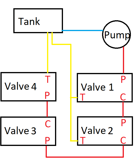

Dave,do you have a couple of pictures of this hooked up correctly?
I have a very similar valve:
P = Input from the pump
T = Low pressure return to tank
C = High Pressure Carryover to the next valve
It would be plumbed like so (valve 1 or 2):
The red lines are high pressure, the yellow lines are low pressure, the blue line is suction
If you have a three point hitch, is a power beyond sleeve mandatory? Thanks Dennis
That depends on the valve, you can have either six or seven ports coming out of a two spool valve like a loader valve, the odd numbered port will allow you to send low pressure return back to the tank and always have a place to dump fluid.
In the diagram above:
Valves 1, 2 and 3 are all rated for full system pressure on the C port.
Valves 1, 2 and 4 have a low pressure Tank port that goes back to the tank.
Lets say that:
  • Valve 1 is the loader valve
  • Valve 2 is an add on 3rd function valve
  • Valve 3 is the rear remote valve
  • Valve 4 is the 3 point valve
As for the reason for the sleeve and the "Tank" line:
If you have the 3 point set to lift, any fluid leaving Valve 3 HAS to go through the 3 point hitch and lift the 3 point to its setpoint BEFORE it can go back to the tank.
So, if you have a dump wagon on Valve 3, it will not lower unless there is enough pressure to force it down.
Not a big deal for a double acting cylinder, but for a single acting cylinder, you are out of luck.

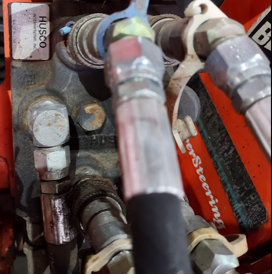

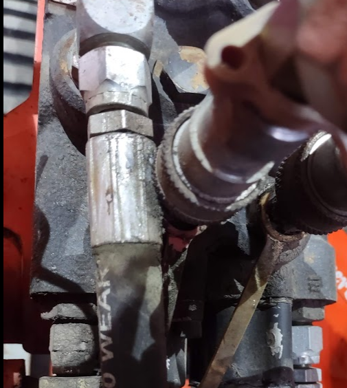

I see 6 hoses so if that is correct there is no power beyond at the present.
I also see galvanized plumbing street elbows used which is a big No No as they are not designed for the pressures in a hydraulic system.
Further, teflon tape is used everywhere to make improper fittings. That product contributes tiny strings to the hydraulic system which is bad for the pump and valves.
If you need another hydraulic circuit suggest you start with a new FEL valve with the correct hydraulic fittings and with a power beyond sleeve in it.
Alternatively, you install another single spool control valve ahead of the current FEL valve and then new valve feeds the old valve with its power beyond circuit.
