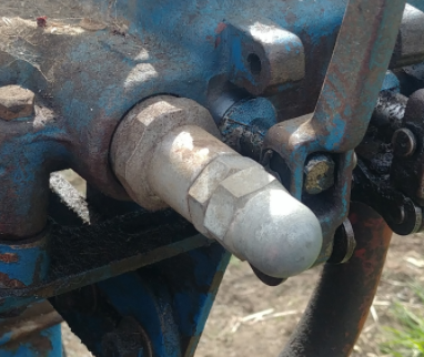

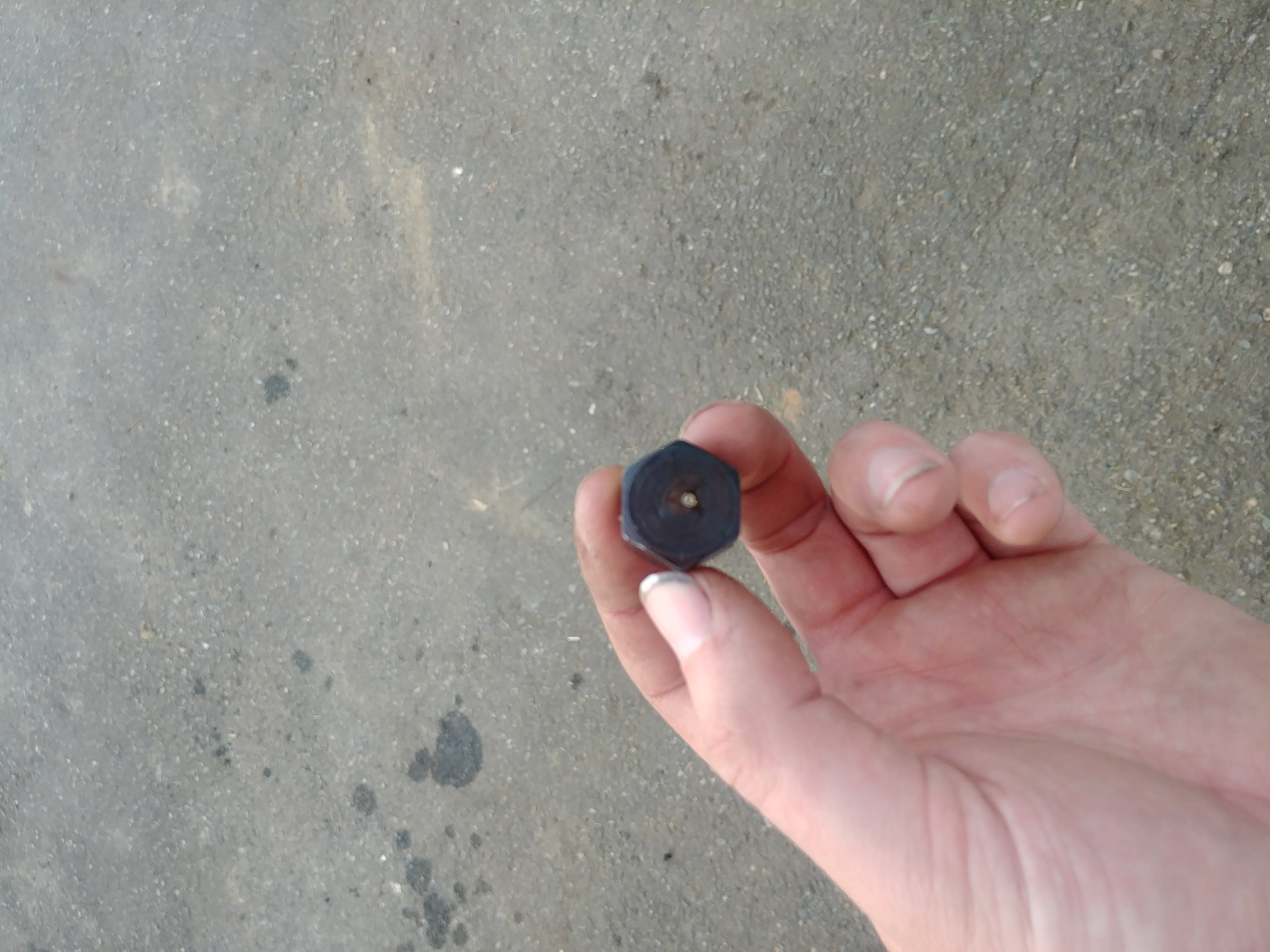

ok the backhoe is hooked up and it works!
its actually quite speedy with the tractor at 1000rpm with decent power. maybe a bit too speedy actually haha.
however i do have a question -
on the 2 cylinders that control the left to right swing. theres these nuts that screw on to what im guessing would be where a return hose would go.
when i first tried that backhoe functions and swung to the left a bunch of fluid sprayed out. i assumed a hose was blown but looking closer it was coming from the bolt. i took it off and the bolts have a hole in the top.
its like a breather almost. after the first bunch of fluid came out it seemed to stop doing that. im guessing some fluid leaked through some seal over the time it was sitting. you can hear air blowing through when you go left to right now.
im wondering if this is how its supposed to be? should there be a filter of some kind on them?

Chris
You have a homemade vent. The proper one is this style.
Crystals of bronze are fused together to make a porous matrix for air to pass through but filter out dirt.
If you have leaking piston seals some oil will get past the piston and start coming out the vent. A small amount is not a problem.
single acting hydraulic cylinder breather - Google Search

Ah ok great. I'll have to get a proper one. Whoever made this just had what look like some couch cushion stuff through the hole to act as a filter.
Why would these cylinders need a breather but not other ones?
   / is this a power beyond valve? #35
All the other cylinders on the backhoe are probably double acting, so they don't need a breather like that one does.

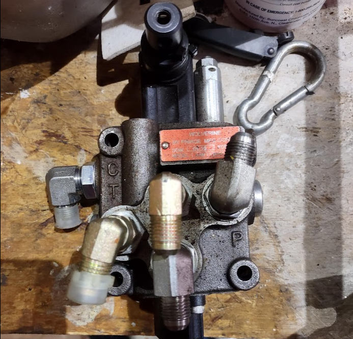

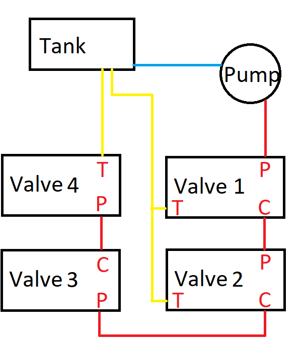

I have a very similar valve:
P = Input from the pump
T = Low pressure return to tank
C = High Pressure Carryover to the next valve
It would be plumbed like so (valve 1 or 2):
The red lines are high pressure, the yellow lines are low pressure, the blue line is suction
If you have a three point hitch, is a power beyond sleeve mandatory? Thanks Dennis
That depends on the valve, you can have either six or seven ports coming out of a two spool valve like a loader valve, the odd numbered port will allow you to send low pressure return back to the tank and always have a place to dump fluid.
In the diagram above:
Valves 1, 2 and 3 are all rated for full system pressure on the C port.
Valves 1, 2 and 4 have a low pressure Tank port that goes back to the tank.
Lets say that:
  • Valve 1 is the loader valve
  • Valve 2 is an add on 3rd function valve
  • Valve 3 is the rear remote valve
  • Valve 4 is the 3 point valve
As for the reason for the sleeve and the "Tank" line:
If you have the 3 point set to lift, any fluid leaving Valve 3 HAS to go through the 3 point hitch and lift the 3 point to its setpoint BEFORE it can go back to the tank.
So, if you have a dump wagon on Valve 3, it will not lower unless there is enough pressure to force it down.
Not a big deal for a double acting cylinder, but for a single acting cylinder, you are out of luck.

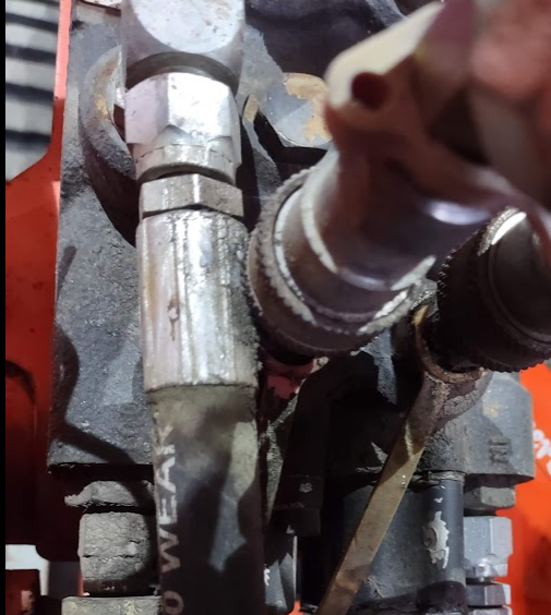

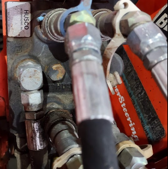

   / is this a power beyond valve? #38
A 2 spool Husco loader valve on our B7500's loader:
It has the following ports:
In = Inlet - High pressure in from the pump, labeled as P (Pump) in the diagram above
Out = Outlet - Low pressure outlet to tank, T (Tank) in the diagram above
PB = Power Beyond - High pressure outlet to the next valve, labeled as C (High Pressure Carryover) in the diagram above
Aaron Z

Thanks!!
