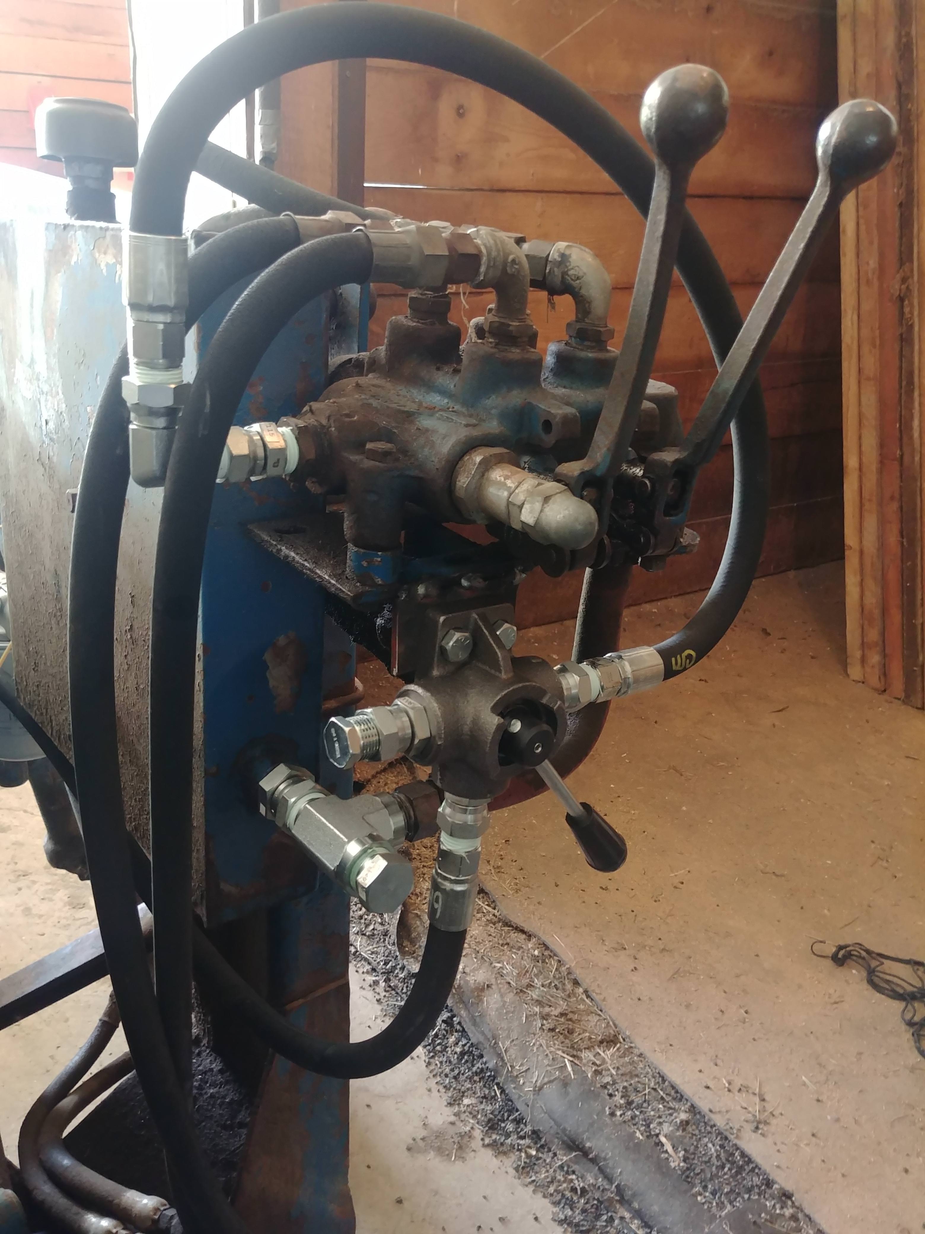

is this a power beyond valve?
   / is this a power beyond valve?
#22
Ya my backhoe has a relief valve i would guess. It has it's own resevoir. So I'm guessing at some point in it's life had a PTO pump. But that's all disconnected and it just has 2 hoses going into the hydraulic lever bank.. one in, one out. So my fel reservoir will just be for both uses. It's the same size as the one on the backhoe so it should be big enough

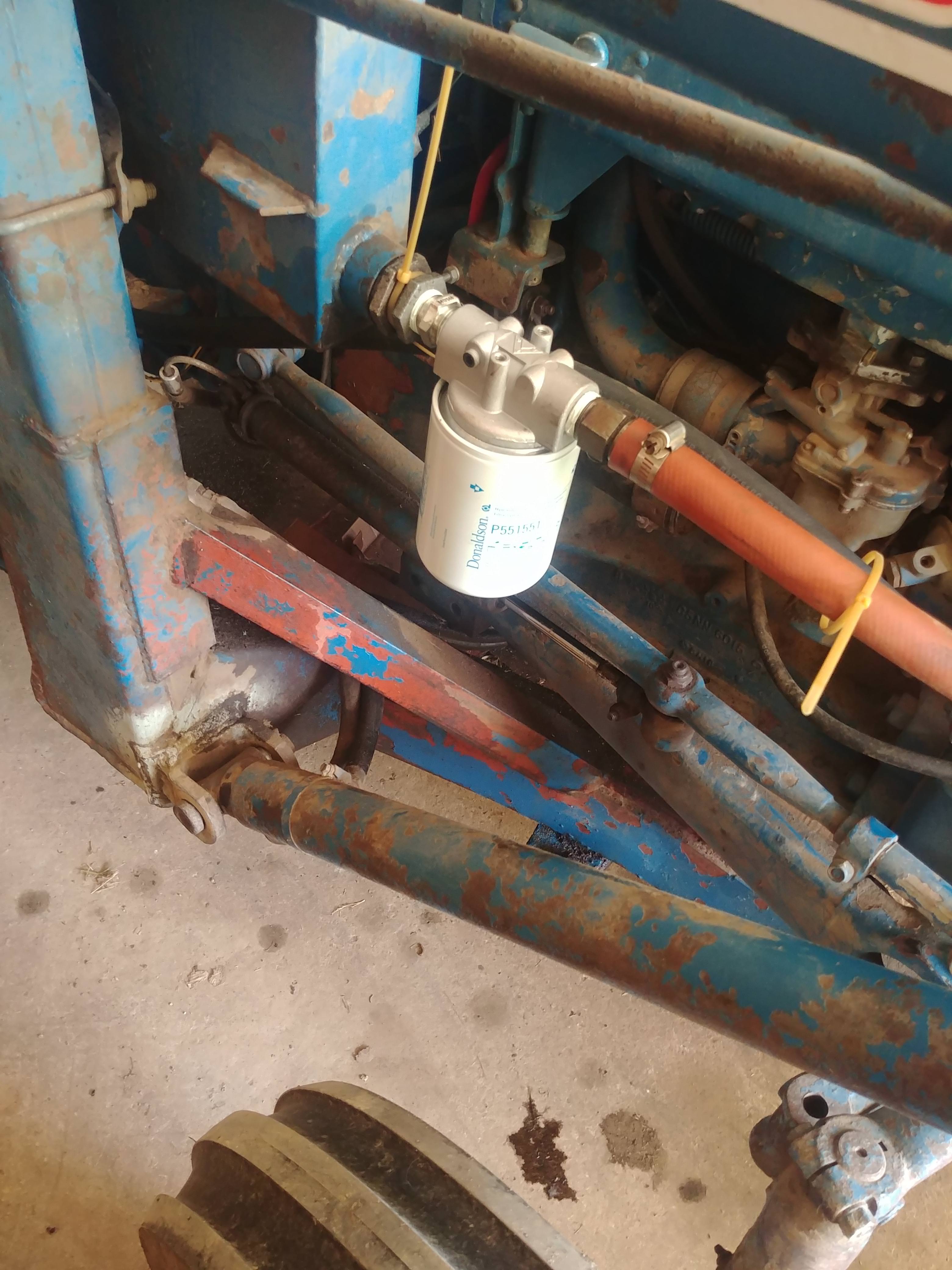

Also something else.
There's no hydraulic oil filter on the loader. I want to add one. Does it go on the high pressure line before the valves? Or on the return line before the reservoir? Or after the reservoir?
If it is a Ford 77x loader as you say there should be a filter in the bottom of the drivers side loader tower. Look for bolts holding a cover on the bottom.

#25
Ya someone at some point put a different reservoir on it. And there's no filter anywhere.

#27
Part way there. Got the valve installed, some new hoses and replaced some pipe fittings along the way. Next step is hooking up the backhoe. I'll see what i can figure out this weekend.
Added a filter too

Chris
Do not forget to replace the four 90 degree galvanized elbows on top of the FEL valve which have the hoses to the FEL work cylinders connected to them

#29
Ya. Those hoses need replacing too.
