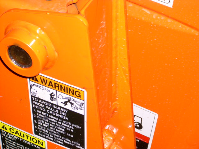

I almost hate to add to this hread but I would really force and be persistent on the welds issue. The fellow that stated weld standards include both quality and appearance is correct. I believe all Kubota B and L loaders are made in the USA.

the welds are terrible, terrible. I would NEVER buy anything that ugly!!!!
And these are not minor things.Maybe inside it is even worse. Obviously these people DO NOT CARE. They release such a disaster, which can be seen and judged!!!!!?????? What about the hidden stuff????
Amateur looking job......really, I'd say retarded amateur looking job. A person who did this has no knowledge , no pride , he is a joke. He and all his superiors and quality control should be fired. Immediately.
It is regretable, that some of you "approve" this kind of quality. DO you do the same lousy job at your workplace? I'd guess so!

Yo me it appears that there is nothing wrong with those welds other than the fact that they weren't machine done. I have many pieces of equipment with welds like that that have served me well for years. It is actually easy to make a perfect apearing MIG weld that doesn't penetrate and has very low strength. I think your time would be better spent enjoying your tractor.

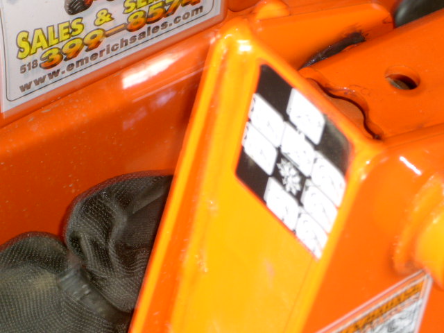

At risk of beating a dead horse, I almost feel obligated to post these close-ups for a few of the guys that think I am a nut-job. Perfect is not what I am after here, strong, good looking, and free of corrosion trapping holes is all I need. Do these meet the criteria? I've got lots more pictures if needed.
You are far from a nut job. I cant beleive there are people on this thread that say there is no problem w/ these welds freaken ridiculous. absolutly horrible! I am no expert and have only 10 hrs. of welding under my belt (teaching myself) and I could do better work than that freakin crap. I hope all works out for you and your claim, based on these pics I cant see how it wouldnt
   / Is this acceptable quality on a brand new Kubota? #250
Bandman, just wanted to share in your thread what I posted earlier in Farmall's thread, hope this can help you in your case. Good Luck!!!
Farmall45B, As I promised here are a few pics I took tonight of some of the welds on my B2620. I dont have electric yet in the barn and it gets dark here around 4:30pm so these are the best shots I could get. Although they dont show all weld locations this is a consistant on all of them they all look very similiar to the pics I have provided. Please note that the spots you see on pic 5 are not welding splats it is dirt. I have also recently looked at the thread started in this same section by Bandman titled is this acceptable quality on a new bota ..... If yours look anything like his than you have a very legitmate beef and I would not except anything but a new loader or a refund on the loader. After looking at mine tonight I cant believe they would even give out a product that looked liked his.
Hope this helps and feel free to use this in your case, I dont know if a picture shows this but I also checked and my tractor was built in Jefferson GA.
Best of luck and keep us posted
