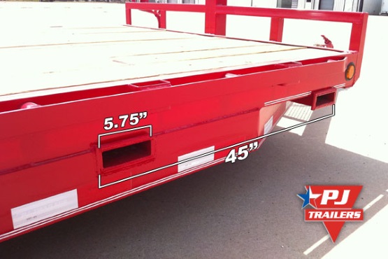

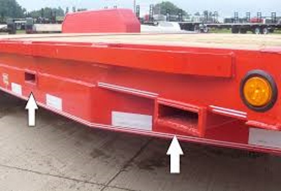

For those not familiar with fork pockets on a trailer:
