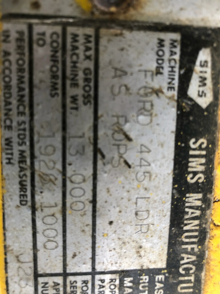

I am interested in buying a Ford 445 that's for sale in my area. I wanted your input on a few different things.
The tractor doesn't have PTO or 3 point hitch. Is it even possible for these tractors to NOT have 3 pt hitch?
The tractor weighs 13,000 lbs. is that correct?

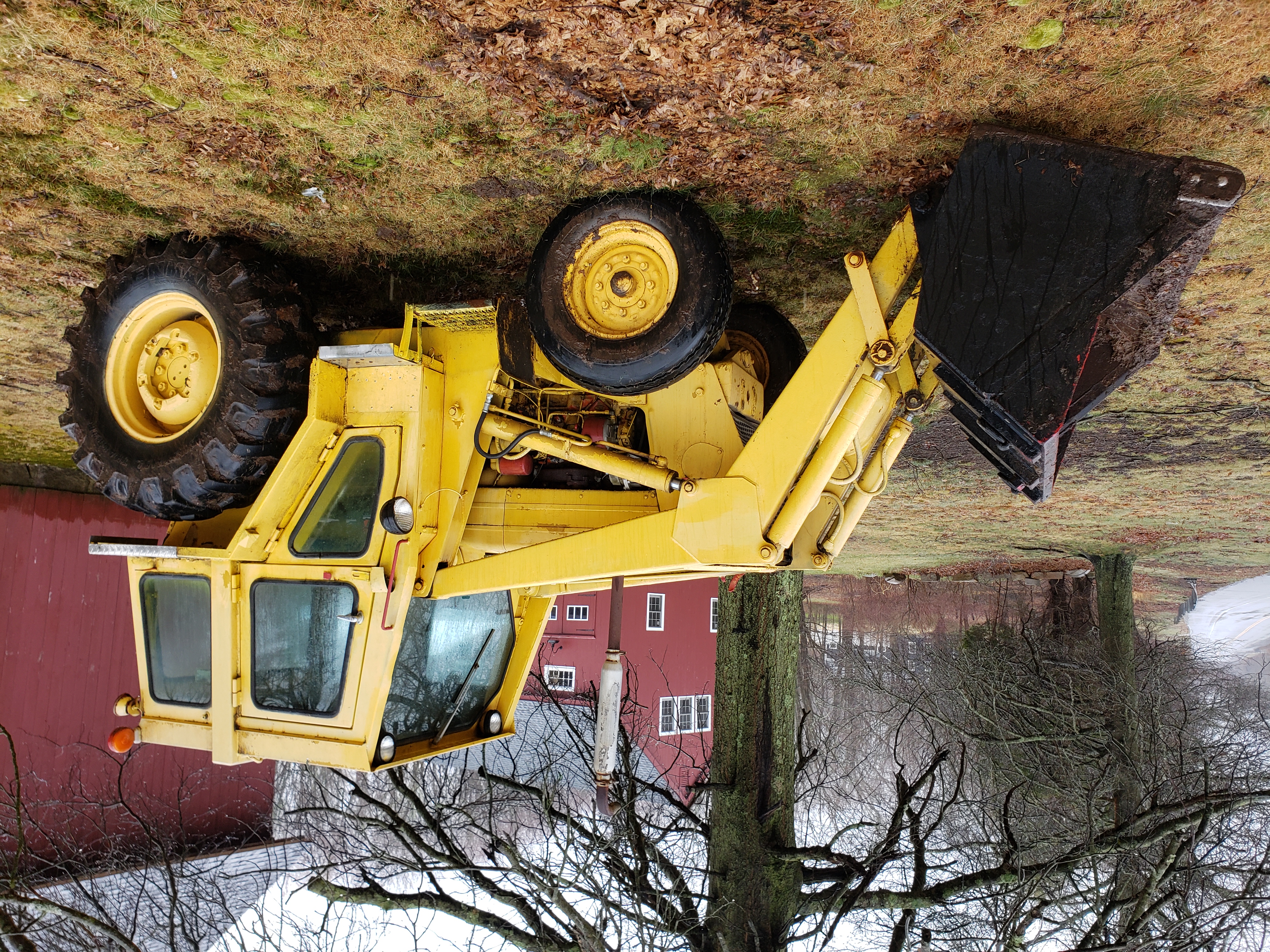

We used to call that a Pippin
Its a backhoe chassis without a backhoe.
It could easily weigh 13,000lbs.
Really only good for doing loader work on good traction surfaces, like loading hay in barns, scooping gravel pushing dirt on parked or stone parking lots, it is a very stable, heavy loading platform. That thing weighs as much as my 135HP 4wd farm tractor with a loader

No backhoe, no 4wd, no QA on the bucket, probably no AC in the cab. It’s not something I’d want. It is tough and strong.

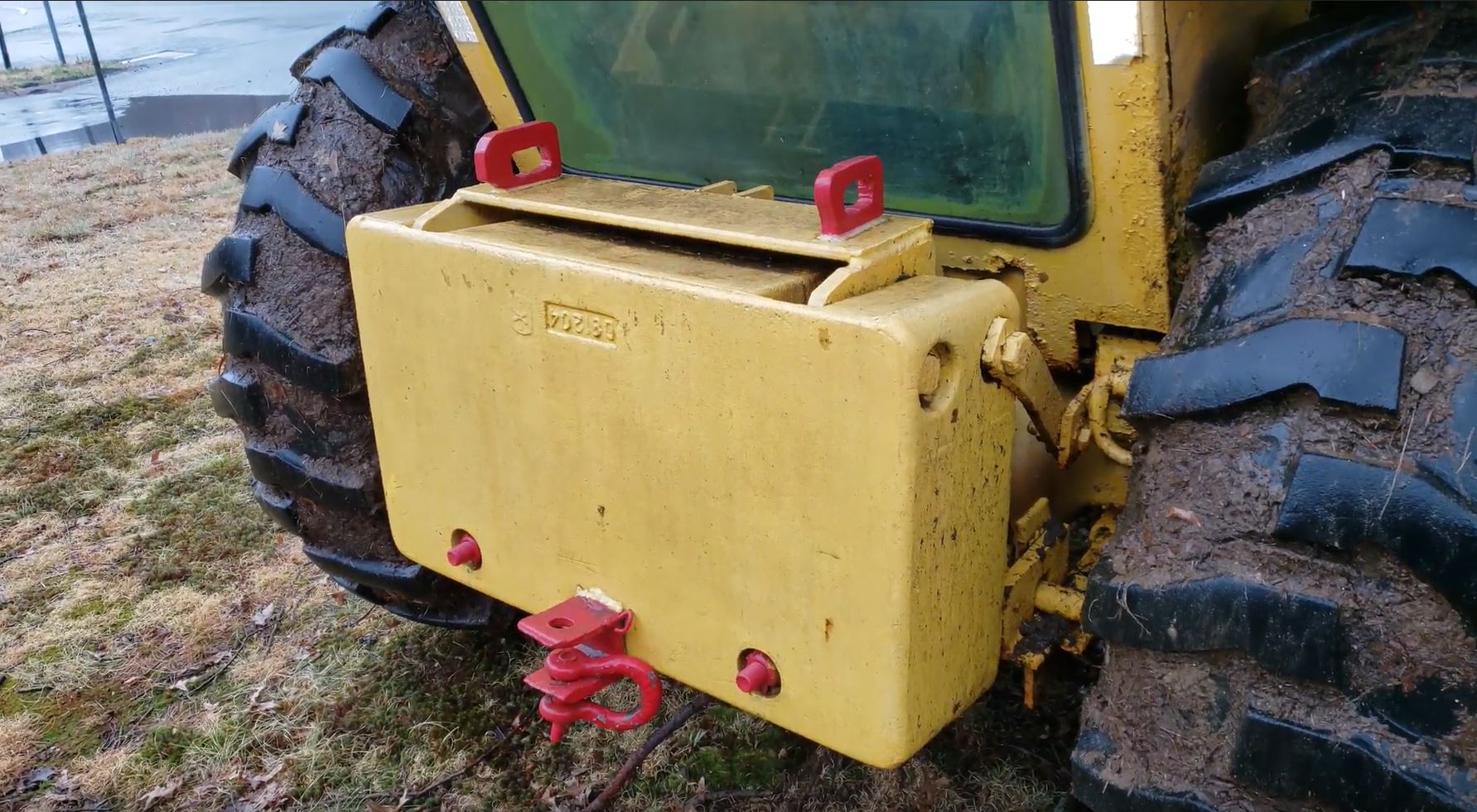

Ok, that is an old torque converter drive in that tractor they have a tendency to get pretty sloppy and loose over the years.
It is not feasible to add a pto, a three point hitch could be added but if you remove that concrete block that tractor will be almost helpless in snow or mud.
Also I don't know your location but with it being fluid drive your brakes are all that stop and hold that tractor, if the brakes are not good and the parking brake is not real good she could be hard to stop and real hard to park on a hill.

No but it’s about 25 years newer, a good bit stronger loader, shuttle shift trans, and half the price.
