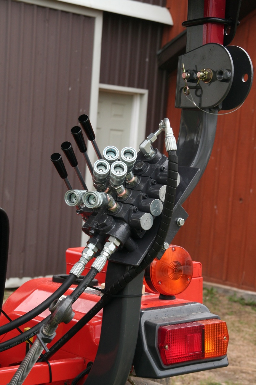

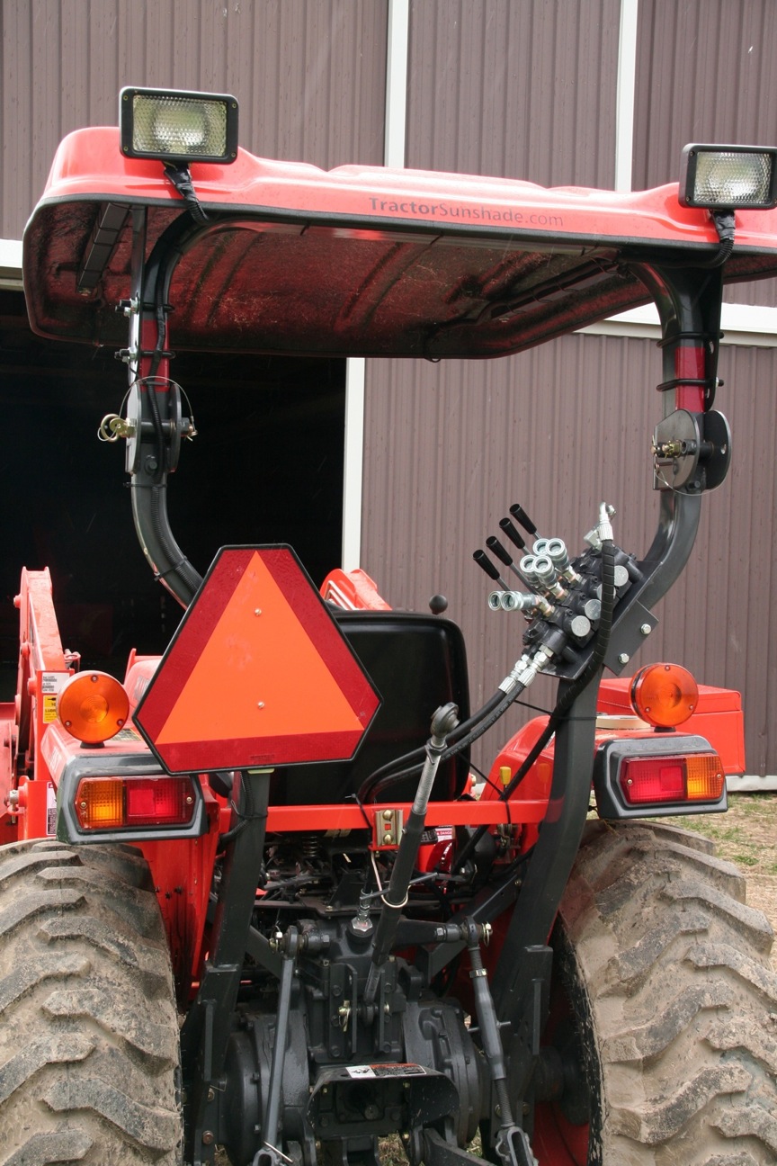

Yes that Prince SV valve should work just fine. I just finished installing that same setup - 4 spools - on my L3400.
Here is how I mounted it (bracket design shamelessly stolen from StrangeRanger) on the ROPS. I like this setup quite a bit. The handles are very accessible, the view is unobstructed and the QDs are easily accessible from the rear. Note that it is very useful to have the remote handles in such a location that you are able to adjust the top link length standing behind the tractor changing implements.
I have to say I was a bit surprised at the size of the Prince SV valve. It is nice that it is stackable however.
Why not go with the setup your dealer normally does? I'm guessing your machine is smaller in size than mine. I would probably want a valve with a smaller footprint on your tractor. Do you really need the 12 GPM flow this can handle? It is almost 100% more than what my tractor puts out so I would doubt it.
Remotes are fairly standard. All you need is a remote that is open center and meant for double acting cylinders that can handle the GPM that your tractor's hydraulic pump puts out and your CCM cylinders will work just fine with it.
For more info on my installation (just put the cylinders on today - yay!) see this thread.

Forgot to post pictures of my mount.
