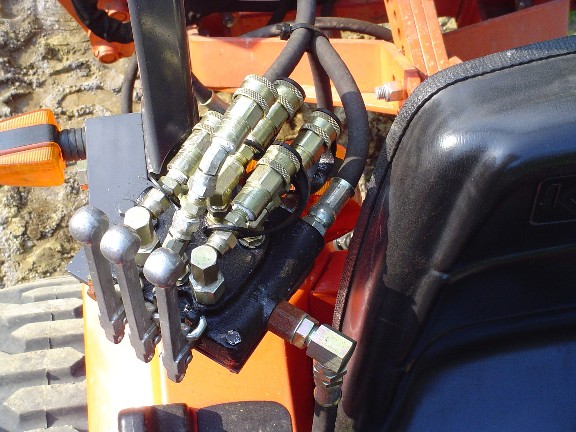

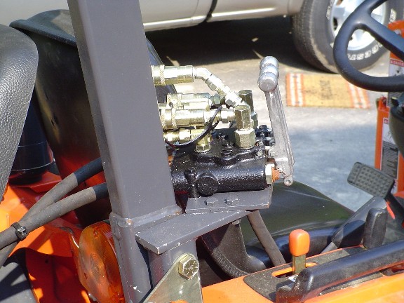

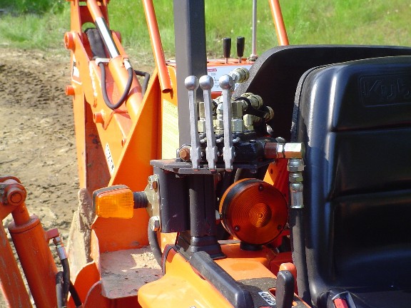

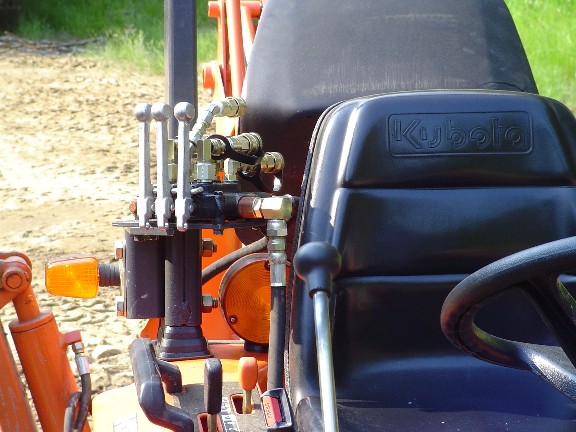

Here are a few photos I have had on my computer for a while. They are marginal quality, but you get the idea. I have run this set-up for a few years, I really love it. The valve sits at the perfect height so when I sit on the tractor, half turned to look back at the implment with my arm on the back of the seat, my hand lands right on the levers.
As you can see, it was a pretty simple mount. A piece of 2" square tube, with a piece of flat stock welded to the top. I then removed the ROPS bolts and replaced them with longer ones (same grade ROPS police, if you are watching), putting the longer bolts through two holes drilled in the 2" tube. Then bolt mounted a plate to the flat stock to mount the valve to. Very rugged set-up with no vibration or issue. By bolting the mounting plate on, I can remove it without taking everything apart.
The valve doesn't have anything hooked to it in the photos, my backhoe was on that day. When the backhoe is off, I use the rear remotes to supply the valve. When the backhoe is on, I disable the valve, since I don't need it anyways. The smaller footprint of the Eaton Cessna valve was a big asset in my installation. Hope that helps. This installation made possible by the MadReferee, a lot of the work was done at his house.
