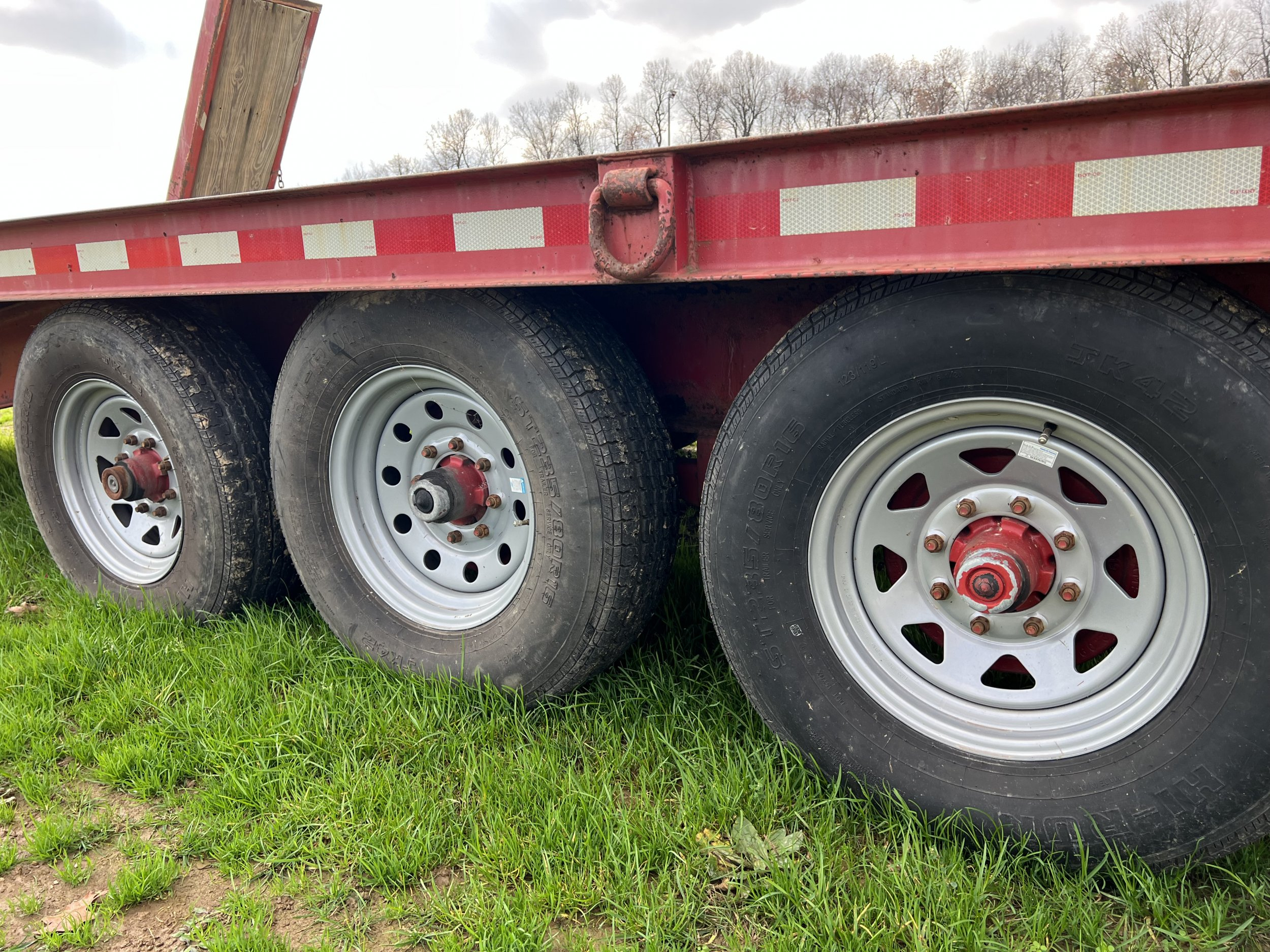

I would be curious as to why there is a missing lug nut on the picture of the tire/wheel. That is a severe no-no as far as th D.O.T. is concerned! Plus it really is more of an issue with 3 axle trailers and the scrub effect when turning. Lug nuts are cheap!

A missing lug nut is very little concern to me. A broken-off stud would be though.

Then there's the massive amount of suspension there with 3 axles and once you "get into" it you discover some egged out hangers and other little things. For me once you've determined that it needs some parts there, that project can quickly grow into a complete re fresh that probably involves flipping the trailer and welding.
Tough decision but probably still a good trailer for $6k.
Bring a jack and take the weight off of the axles at a few places looking for the dreaded "egged out" spring hangars, equalizers, etc.
Agreed, unless the nut got left off for a reason, such as stripped threads or damaged stud...then it might as well be broken off, as it takes as much time to fix!

1. I grabbed several of the wheels and “shook” them. One of the wheels actually clicked a bit in and out. I think the lug nuts may have been slightly loose.
2. If you notice in the pictures, the wheels do not match. The visual appeal of all the wheels matching isn’t a big deal to me, but I wondered why they don’t match? All the tires match, but the wheels don’t? The wheels are obviously much newer than the trailer. They look maybe 2-3 years old. Tires all match and look excellent-albeit chinese tires of unknown quality.

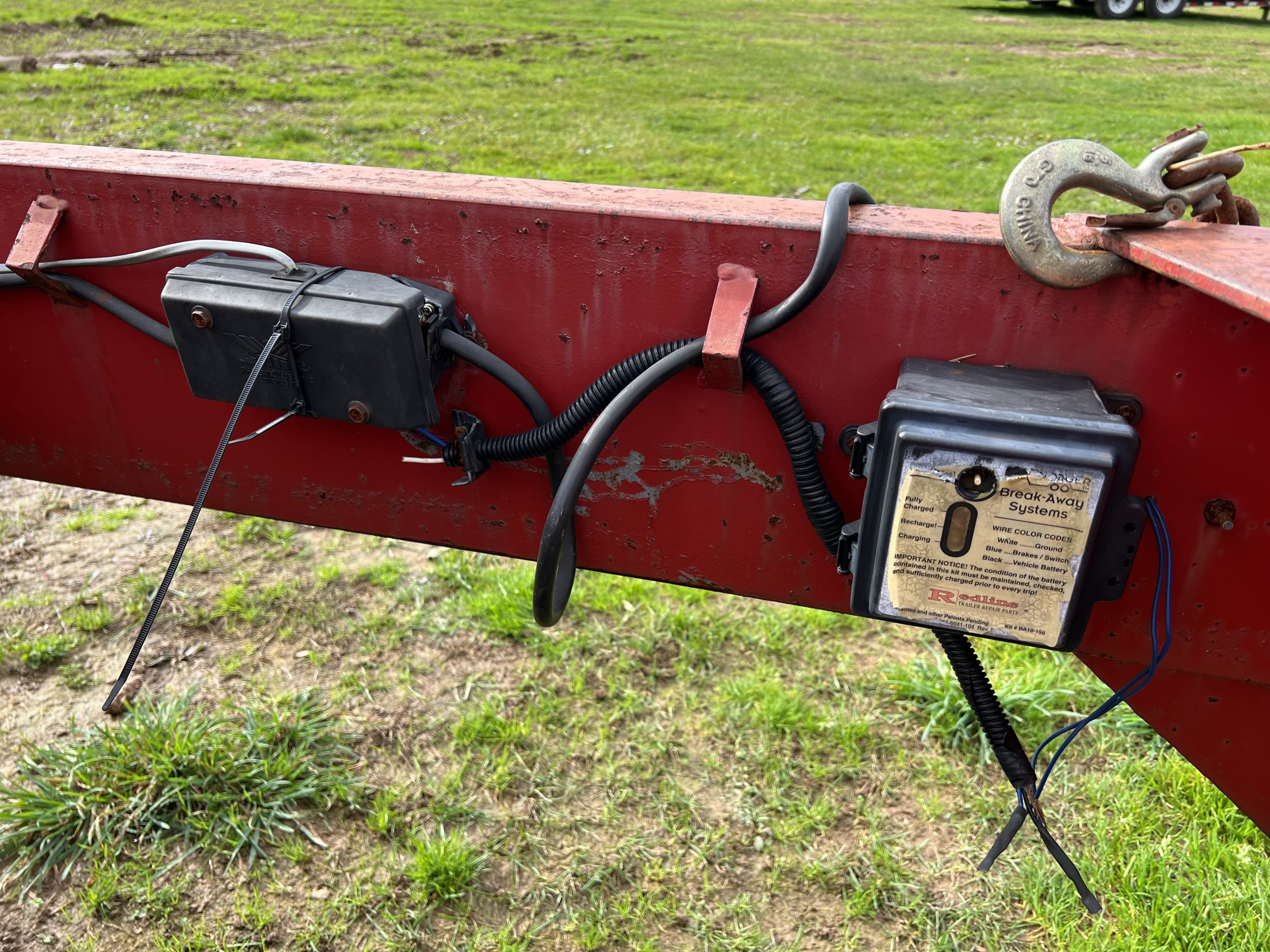

4. Battery box and wiring junction box are beat up and need replaced. I would assume battery is toast, too.

Because we don’t know what it could need to pass inspection. Basic one time inspection that passes with no repairs is $100. If it needs brakes, suspension parts, break-away battery & box, etc. etc. it could quickly add up.
