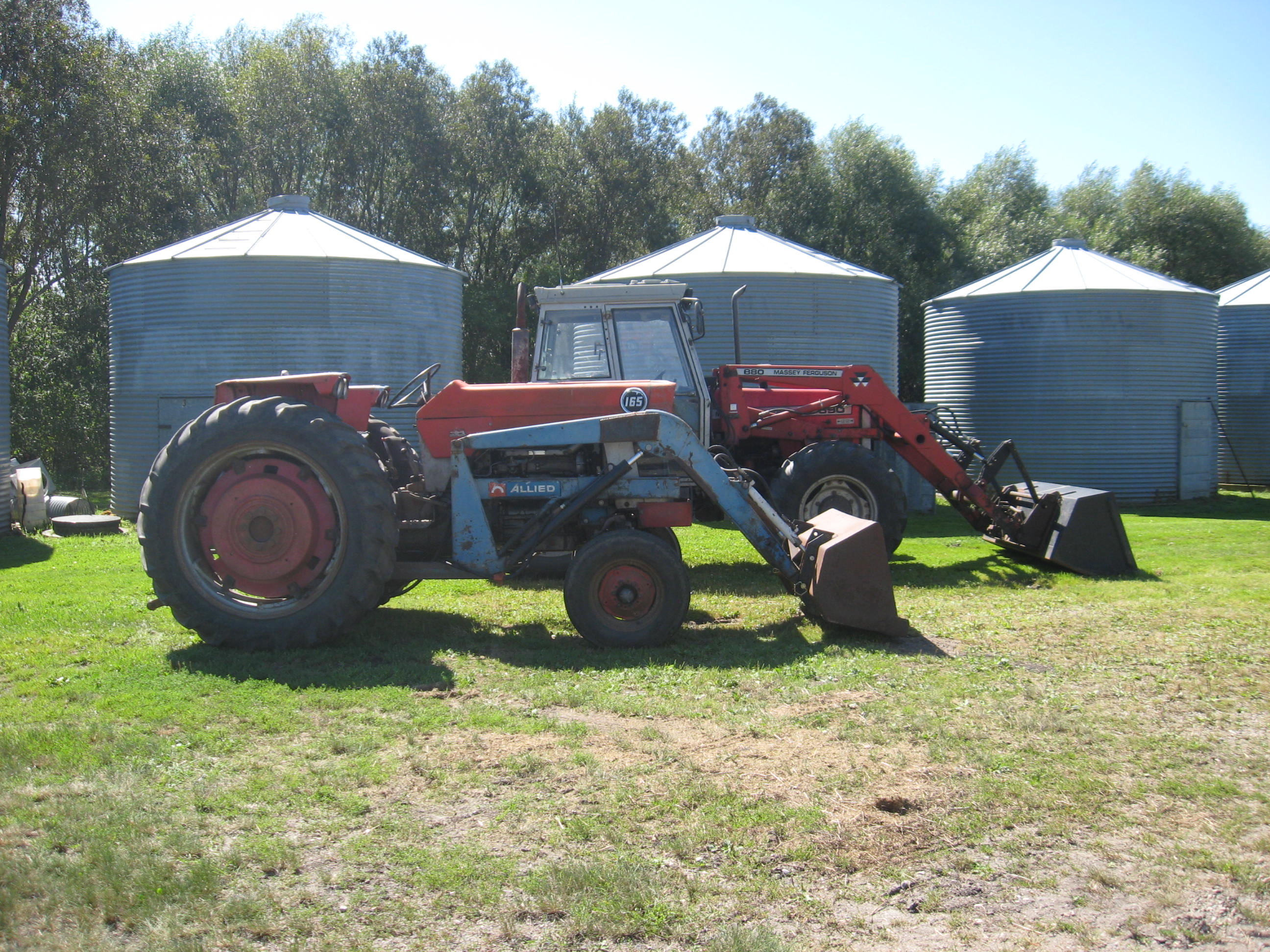

Hi everyone,
We are in need of a bigger tractor for baling small square bales, something in the 40+ hp range.
What can you guys tell me about this tractor?
Is it a problem that its gas?
What about multipower? I know what it is somewhat, but is it reliable? Will I get it home and it explode on me? Can I just leave it alone and not use it?
and finally, Is it at a good price? That tractor has sat there for some time, so that kind of alarms me. (either price-wise, or nobody likes MF 165s)
Massey 165

Anything can fail but over all Multi-power is fairly reliable. The Perkins engine are near bullet proof.

Personally I would stay away from gasoline engines in a tractor. Not for the reason that they are unreliable but because of the gasoline that we have to use today and how fast it goes stale. It is bad enough just trying to keep my lawnmower with fresh gas and it gets lots more use than a tractor especially from May thru Sept. I just think that it would be a problem keeping good fuel in it and would be a nightmare of carb overhauls. Wait for a good diesel engine tractor come along.

My concern would not be that it has a gas engine. It's the "fresh overhaul" that has my attention. That suggests to me that either there are several thousand hours on it or it lacked proper maintenance. So what did the fresh overhaul consist of? was it just cosmetic? can he tell what was done? when was it done? by who? and can he prove it? I'm not suggesting it's good or bad, only to be suspicious of "pretty" old tractors.

i'd steer away from a low use gas engine.
you'll end up rebuilding the carb every year when you wake her up to use her.
as for the tractor.. not a bad one though..

165 multipower is a good tractor but i would not want a gas either .
I have a diesel with over 10'000hrs on it

A 165 is a very good tractor and the one pictured looks really good and it's also a good price. If the seller can provide receipts for the overhaul and the Multi-power and everything else works good, it would be a good choice of tractor. Parts aren't a problem as they are still very popular. If you need to use a tractor a lot for heavier work a diesel is the way to go but that doesn't mean you should shy away from a gas tractor if it's in good shape. You can always run Seafoam or some other additive in the gas tank to keep the fuel fresh. I don't think a tractor engine is as finicky as a chainsaw or other small engine. There's still thousands of gas engines out there. If you were looking at a 100 HP gas tractor, then fuel economy might be a big concern.

So let me consolidate everything:
The Tractor is good, considering nothing is broken.
Gas tractors aren't as good as diesels, but they aren't much worse.
Run a gas tractor at least once a month, to keep from getting gummed up.
Seafoam the tractor every dozen tanks or so.
Parts availability is great, making carb rebuild kits even easier to find.
