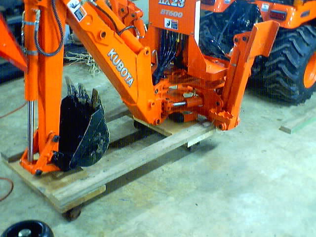

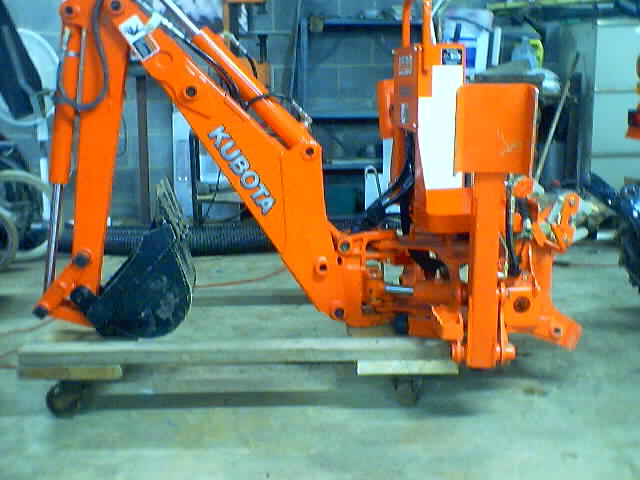

No problems w/dismounting my BX23's BH onto a dollie. Space is at a premium in my shop so stowing implements in the dry requires large implements to be mobile. I guess I'm so used to it now, after 3 yrs, that it seems it makes it easier to mount / dismount. Course I haven't dismounted the BH onto a hard surface sans the dollie since the 1st or 2nd time right after I got it home and decided it needed to be mobile :D
As for bucket size, a 12" is a good std size for my BX23 but I would imagine a larger BH on the B7800 would easily handle a 16". When digging a new trench for a water/sewer line or electric a 12" is great and doesn't make such a big trench but with that said, if one is going to do some serious digging and or digging around existing utilities where one has to work on both sides of the line(s) a 16" gives you more bite for the same effort.
For digging out a small pond (wich my BX23 did w/a 12") the bigger the better and a 24" wouldn't be out of the question then.
It all boils down to what your primary useage is and if it's pretty much everything I'd start off w/a 16" then add another later, you can't ever have too many implements :D and besides it's only your money anyways :D
Good luck
