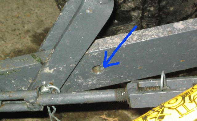

Are you using the "B" holes to connect the lift arms to the 3ph arms? I need to do that to one arm only when using my mold-board.
   / isappointed with Middle Buster
#20
pbenven, I think you might have come up with a crucial part of the answer. I now think I recall the different holes and I have never changed it before. I don't have the tractor here at home tonight, so I can't check it, but since you have the same tractor I would assume its the same.
It makes sense that if you use the front hole the lower links would be allowed to go lower. Might cause transport problems, but could be set that way temporarily for the job. I hope I'm currently in the rear hole the way your picture shows, that is, if I'm looking at it correctly.
Thanks!!
