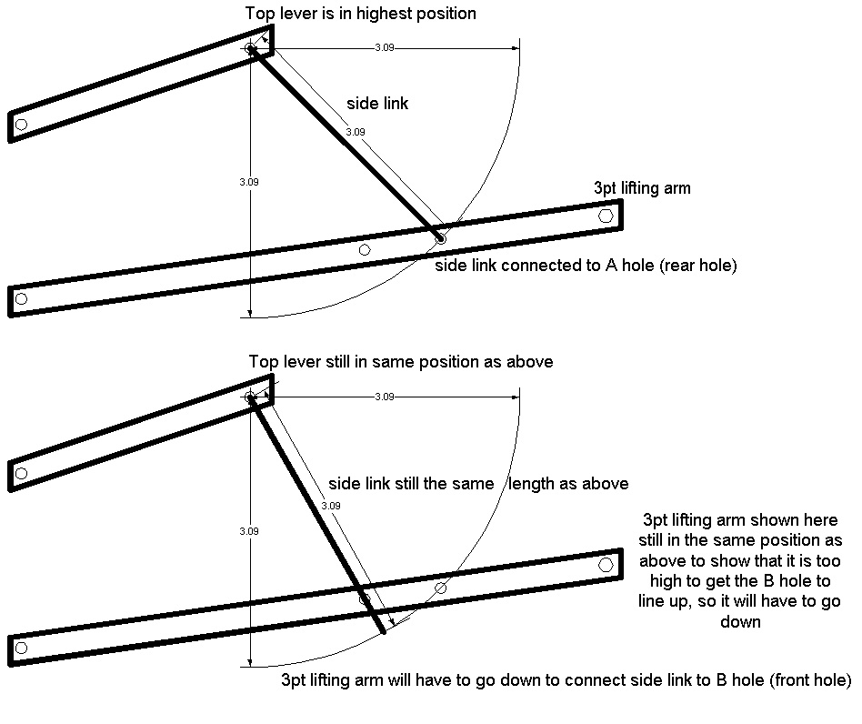

"moving the link to B hole it should go higher and lower"
I have to disagree. To prove it, put the link in the A hole, use the 3pt position control lever to raise the 3pt to the highest height, and measure the height at the end of the arm. Next, without moving the 3pt lever, move the link to the B hole. In order to do that, you'll have to lower the arm. Measure the height again and it will be lower.

Don't know about the A hole B hole but if you use the holes nearest the tractor you will have greater range of the 3 pt, ie the end of the arms where they hook to the implement will go higher and lower than in the other position but you will lose overall lifting capacity which is not a factor when using a middle buster/subsoiler so use the holes nearest the tractor to maximize the depth of cut.

If you had infinitely adjustable lift arms, the range would indeed be greater. However, with most setups, you'll only go farther in one direction. In this case, it looks like he'll go lower if he goes from A to B.

I agree, Tim. Assuming the lower lift arm is above horizontal in the raised position and below horizontal in the lowered position, in the raised position you would have to raise the lift arm to hookup from A to B, and lower it to hookup in the lowered position. The book is correct.

Here's a drawing of what I was saying earlier. With the top lever in it's highest position, put the side link in the A hole and measure the height at the end of the arm. Then move the link to the B hole. In order to do that, you'll have to lower the arm.

Thanks for clearing up what I was trying to get across.

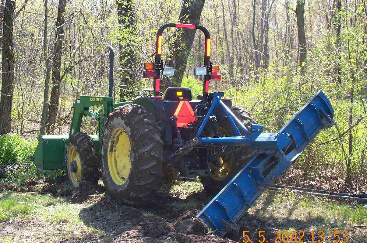

<A target="_blank" HREF=http://www.tractorbynet.com/forumfiles/5-211091-RearBladeDitching-8%27-800.jpg>Here's another way for ditching and maybe somewhat more versatile by using a rear blade...</A>
