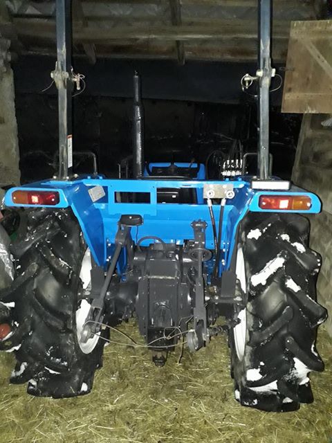

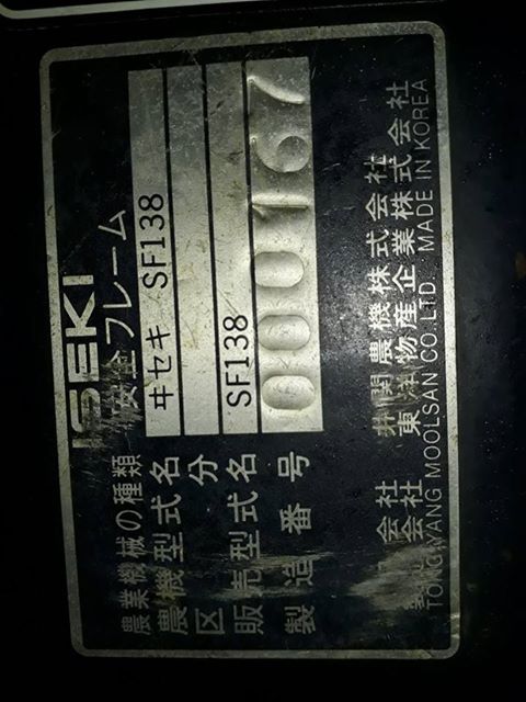

And now I have it at my house! Just arrived tonight. Actually different, equally unknown model number -- SF138 -- on the manufacturer sticker. Maybe it is a TYM model number? The castings of the transmission have TYM on them.

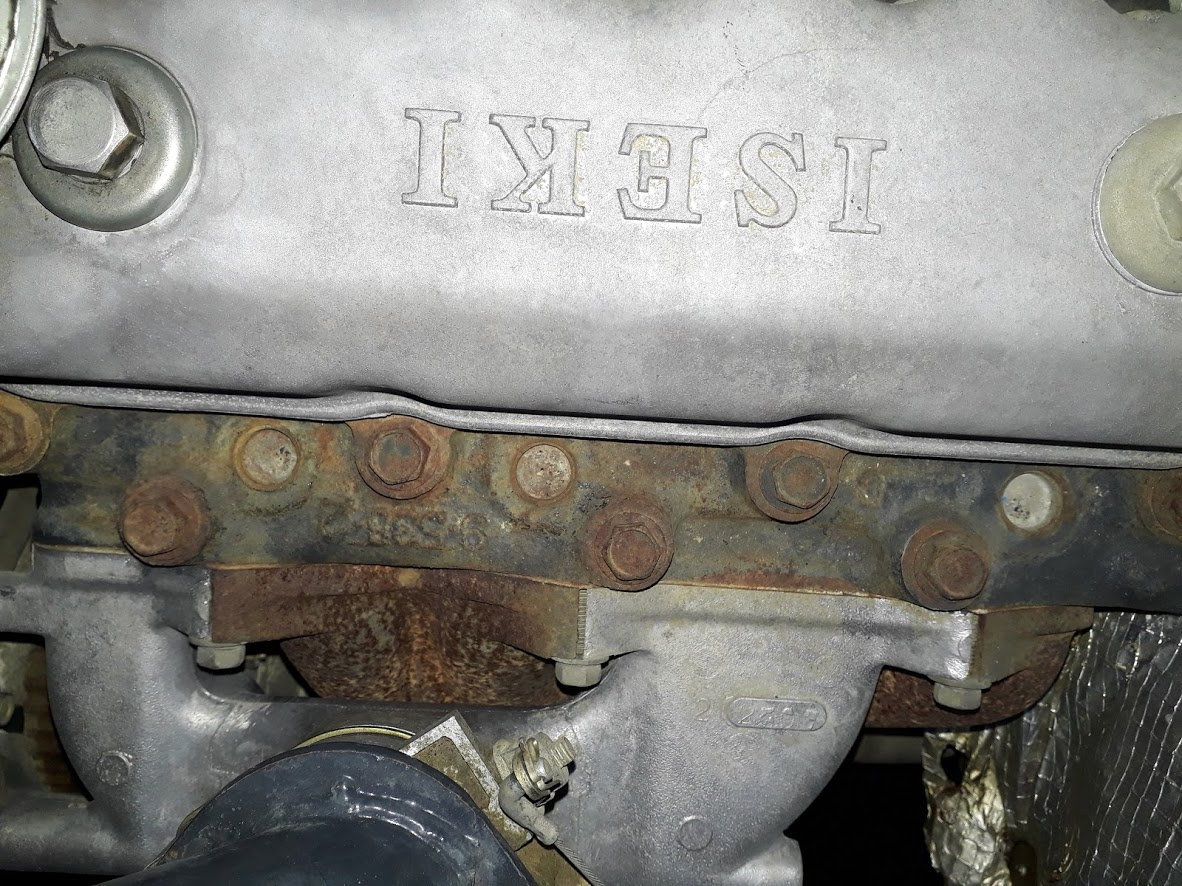

And the engine is branded ISEKI. Not sure why I remembered Isuzu. My mistake! I found the number of the engine lower down, 3AB1, which further confirms the close relationship to the earlier mentioned tractors.
View attachment 544801View attachment 544802View attachment 544803
Congratulations! Yeah, it appears to be an unusual model. The only Iseki SF models I can find are mowers. I also notice the serial number is very low... an indication there weren't many made? Just as a side note, I'd review some basic FEL operation safety, especially with the wife if she will be using it.

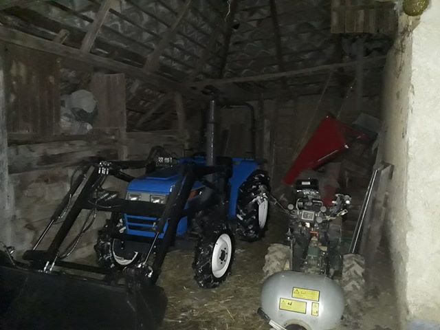

I just had it out, moving some dirt in the yard around. I realize how a joystick would be a nicer interface for controlling the FEL than 3 levers! Just have to get in my head which lever does what. A decently full bucket of soil lifted without any problem.

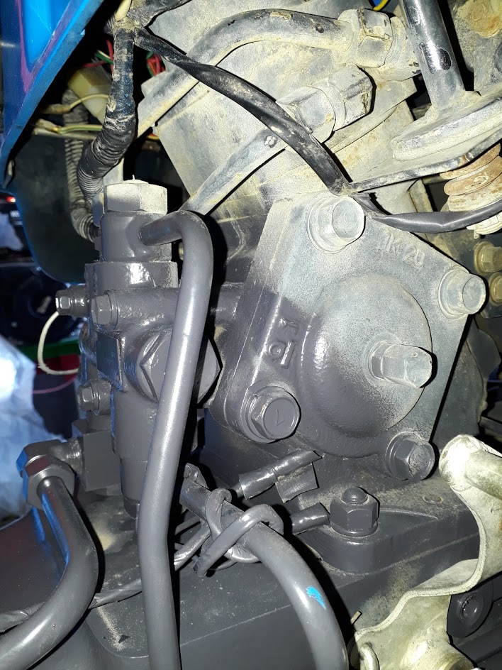

One disappointment though is that I think it has power steering, but that also seems to not be working, or only partially working. When standing still the wheels are very hard to turn. When moving at all turning is OK.
/ Iseki 35 #9
Looking at TS35F pics online, it appears that model has power steering. I would suspect either a weak pump or a relief valve bypassing. Does it only do this (steer hard) with a full bucket or does it make a difference if you have a heavy load on the front end or not?
/ Iseki 35
The bucket being full didn't matter, but it was by then in somewhat thick mud when I noticed, since it was by then that I was making tight maneuvers where I needed to turn the wheels hard, ideally before moving.
There is also what seems like to me a lot of play in the steering. With the wheels pointed straight ahead, I turn the steering wheel to either side at least 20° before any steering happens, which seems excessive.
There is some sort of box on the steering mechanism with hydraulic lines going to it, and then two of those go in to the steering mechanism. That's why I'm sure it has power steering.
I just went out and checked. The line going out from the hydraulic pump has been opened, and now the hydraulic fluid first goes up to the controls for the FEL before returning to the circuit where it continues in to the transmission (for controlling the 3pt). Separate lines go to and return from the transmission housing for the power steering.
Is this really a good arrangement? When I've seen threads of people adding FELs to their tractors on here, I see them putting Ts in to the hydraulic lines so the FEL is in "parallel", not putting it in "series" (can these terms from electrical engineering be applie to hydraulics?).

Here is where the hydraulic system is tapped in to:
This is the set of controls-- the far right hose is what connects to the pump output, and the far left hose continues on to the rest of the tractor's hydraulics:
Two angles on the hydraulic "thing" attached to the steering "thing" with the hydraulic lines going in to the steering:

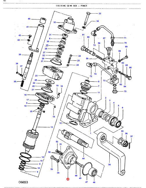

I wonder if the screw sticking out on the right would adjust the tightness of the steering gear. The manual for the TS3510 shows something like that to be adjusted.

Other interesting thing-- on the front axle there is a stamp T50F - 000167. So the serial number there matches with the serial number on the ROPS. Interestingly, the photo label of the tractor in Thailand has T50F on one line.
Google searching "Iseki SF" turns up a lot of photos of lawnmowers for me as well. But on the other hand, the google translate app translates the top line of the sticker on mine as "full frame tractor", so maybe there was an extremely obscure series of SF138 tractors? It sure would be great if there were someone Japanese speaking, even better native, on the forum who could be our "spy" in to that world. :)

It's interesting that your steering only steers hard when stopped, even with an empty bucket ( not much load on the steering) but works fine while moving with a full bucket ( much bigger load on steering). Hmmm, I gotta think more about that.
I don't know the first thing when it comes to your steering system but in past experience when I had a similar issue with "slop" (play) in the steering, it was due to worn bearings or bushings on the steering column shaft. I am certain it could be a number of other things too.....just cant speculate on that.
The system of plumbing sounds correct, this is how my FEL is plumbed. In general, you don't want to tee the pressure line from the pump, this can rob another function in the circuit.

Don't know if this will help you but I find parts diagrams invaluable. Iseki made a lot of Massey Ferguson's compact models. Sometimes searching the MF models can reveal a lot of crossover to Iseki models. I have used AGCO Parts Books or ( AGCO Parts Books enter site as "Guest") many times to figure out Iseki models. I would suspect if there is a "similar" MF model, it would be in the 30-40 HP 11XX or 12XX compact series.

Looked over the tractor again last night, particularly those labels that had been painted over. I noticed that the one on which I could see stamped numbers (so had to be metal) had loose, paper like edges. Or, in other words, masking tape. I guess it was Friday afternoon and whoever was charged with uncovering the stickers after spraying the body missed this one. :)
So according to the label on the frame of the tractor, next to the front axle, it is an "agricultural tractor (passenger type)".
Agricultural machine model name: T0014
Sales model name: TS35F
Vehicle model name: T50F
Why the label on the ROPS gives the model SF138 will perhaps remain a mystery.
