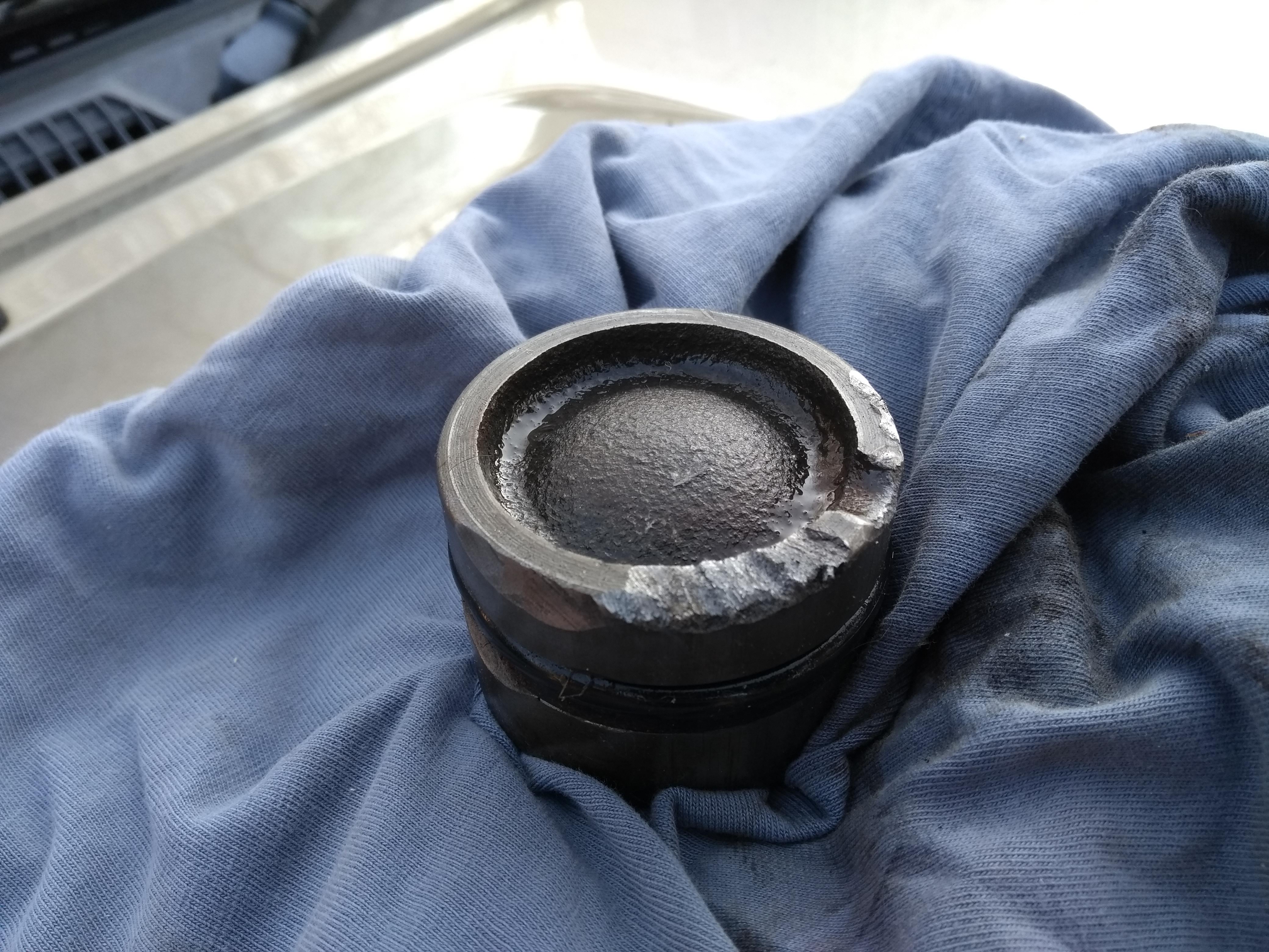

I removed the lift arm assembly last night, to find that the ram had no piston in it! Somehow it had been ejected out of the cylinder into the gear case.
This should not be possible, but yet it has happened. I found the piston in the gear case, badly damaged from grinding against the bevel gear. The ram cylinder seems ok except for some damage at the bottom. It should be repairable.
Very lucky not to destroy the gear case. Lots of flushing coming up.

I only got one shot before my phone battery ran out! Will get more tonight as I need to inspect the ram cylinder to make sure it's repairable.
There is more damage than this!
The grinding from bevel gears in obvious, but there are some more curious indentations that make me wonder if they were caused during the ejection or were already there.

For me it is important to understand the orientation of your piston first.
Is the side with the indentations the one the hydraulic fluid presses against, or, is this the side where a push rod bears?
Post a picture of the other part(s) in contact with this piston.
Often, owners will physically lift the lower 3 pt arms not realizing they could be allowing the push rod to drop out of position.
This is a mistake I too made and as I lifted the lower arms, this movement allowed the push rod of the 3 pt hitch to drop out of place and then when I activated the 3 pt, it pushed out a sickening part of the rear casting on my Nuffield. The roll pin had worn out and the piston pushrod was not being kept in its proper position when the lift arms were raised by hand
This is a 3 pt piston seal detail which I expect should also exist on your tractor..... a nylon backup ring behind the O ring.
In thinking about this photo I have provided, I now see two nylon backup rings on the same side of the O ring. One nylon ring should be on each side of the O ring to keep it from being extruded into the small gasp between the piston and its cylinder
Before you condemn your piston, lets understand how it works.

Dave, thanks for all that detail. The picture is of the pressure side of the piston.
The piston is definitely condemned! The underside is even worse.
The o rings are in place as per the parts diagrams, no problems there.
I think what you are saying about over extending the arms is probably correct, although I don't recall this happening. I'm also curious about it, as my other TX1500F relies on the arms being fully extended to power the loader. I'm planning on a few experiments when I get time to see at what position the piston can be ejected.

I've ordered the replacement piston and o rings from Germany - all up about 」56, so not bad at all. I just need to file and polish some damage at the very base of the cylinder before the new one goes back in.
