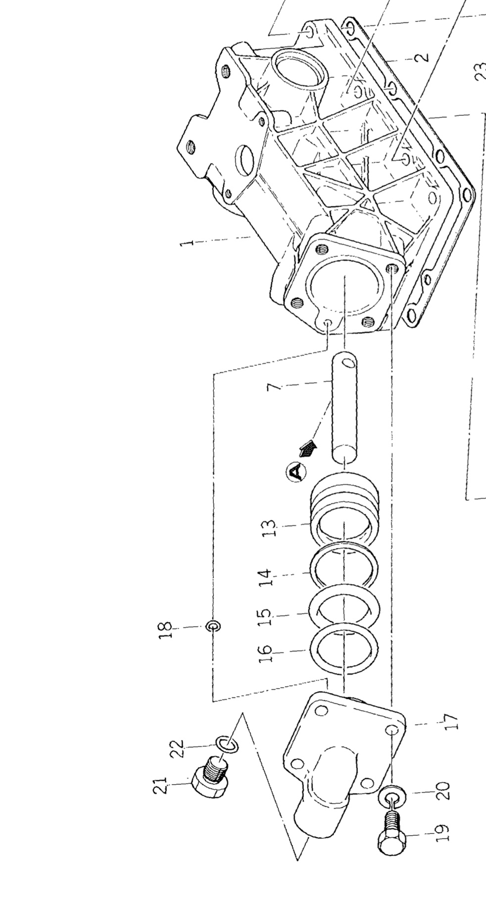

Manually raising the 3PL does not affect the piston or anything. So this should not cause your problem.
You will have to open up the top of the 3PL, and check the piston, which has 3 rings around it. This is not as bad as it sounds, you don't even have to drain the oil.
Attached the section of the manual that is about the piston. Send me a DM with your email address if you want the complete manual.
Good luck,
M.

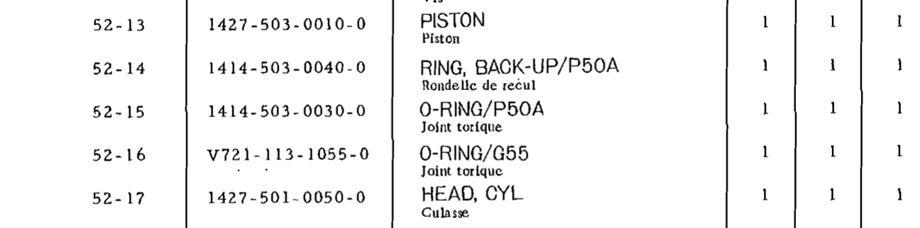

Thanks @marcelPL, great information.
Do the seals come as a kit from Iseki (I haven't yet enquired to see if there is any OEM support for these anymore), or am I better off taking the O-Ring dimensions to a local hydraulics supplier? P50A and G55 O Rings look to be a generic item, through Google anyway. The exploded view you have attached seems to show 3x different O rings, but the Bill of materials shows two of them as both P50A?

There are two rubber O-rings that are identical i think. You should still e able to get them at any normal tractor shop.
