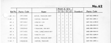

Hi,

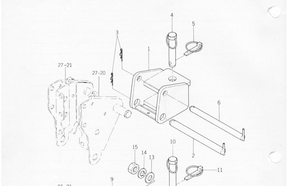

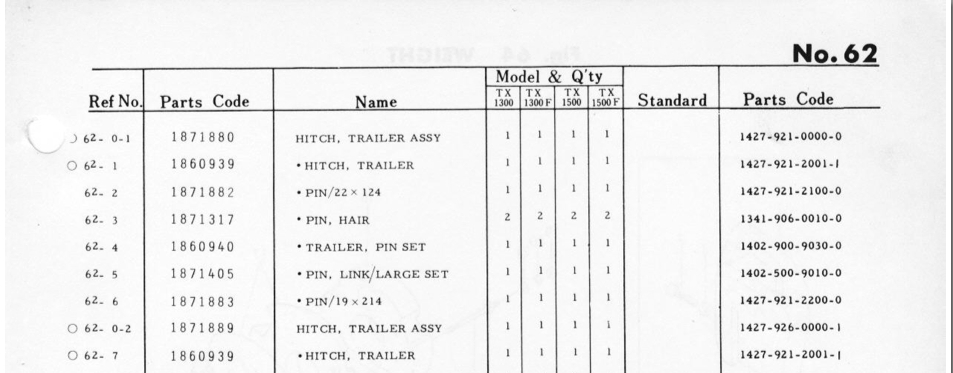

Sorry for the late response! I have been very busy this week, and I hope that springs going great for you! That would be great if you would be able to let me know if you come across this part some day! I have been looking for quite some time, and I have not had any luck. I am looking for the hitch that attaches just below the PTO shaft where you attach a trailer. Below are the photos of the hitch that I need. When I bought the tractor, it had a very roughly constructed hitch, that I would not trust towing a trailer with. I have been using the 3point lift arms with a draw bar attached, however this makes me concerned because It really extends beyond my center of gravity, and makes the front end of the tractor lift if I have too heavy of a trailer attached. Anyways, that would be great if wouldn't mind keeping an eye out! The hitch is item #1 on the list, and the diagram.Thanks again!

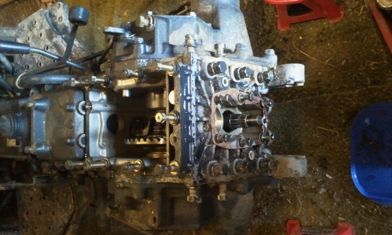

Hi All, been real busy lately so unable to post, but I finally got the replacement transaxle on Friday and spent Saturday night and Sunday morning doing the swap. Will try to tell the story in pictures.
Above is the old transaxle almost ready for removal, all hardware removed including the PTO case. I meant to take a picture of the removal of the PTO case - attached to the through gearbox shaft are two press fit bearings, you need to take these off with a bearing puller - otherwise the transaxle won't pull out over the shaft.

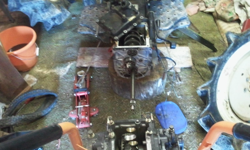

Just thought I'd show my method of removing the transaxle with a trolley - just rope it on and go. Worked quite well - good for keeping a level exit, which you need to ease the transaxle over the PTO input shaft.

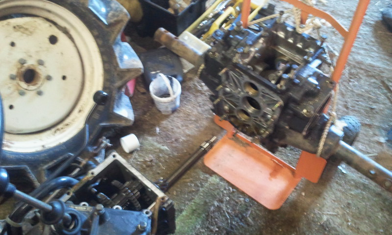

Just wheel away the transaxle with a little help from a mallet, here you can clearly see the PTO input shaft - hence the need for a horizontal pull.

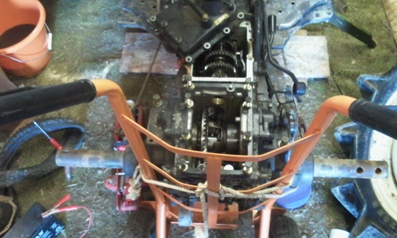

Clearer picture here of the removal method - could have used a chain block, but this was faster and doubled as a method of moving the transaxle around once removed.
