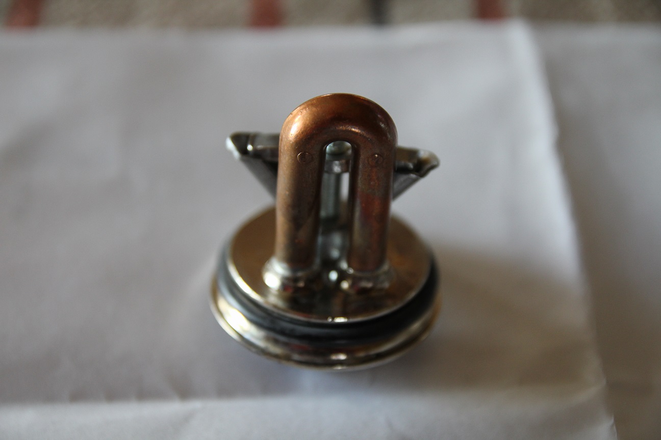

I had that style heater on my tractor but it was in the way when I started building a loader subframe for it. Anyway I have the new block heater here, the heating element on it is straight so hopefully it's the right one.

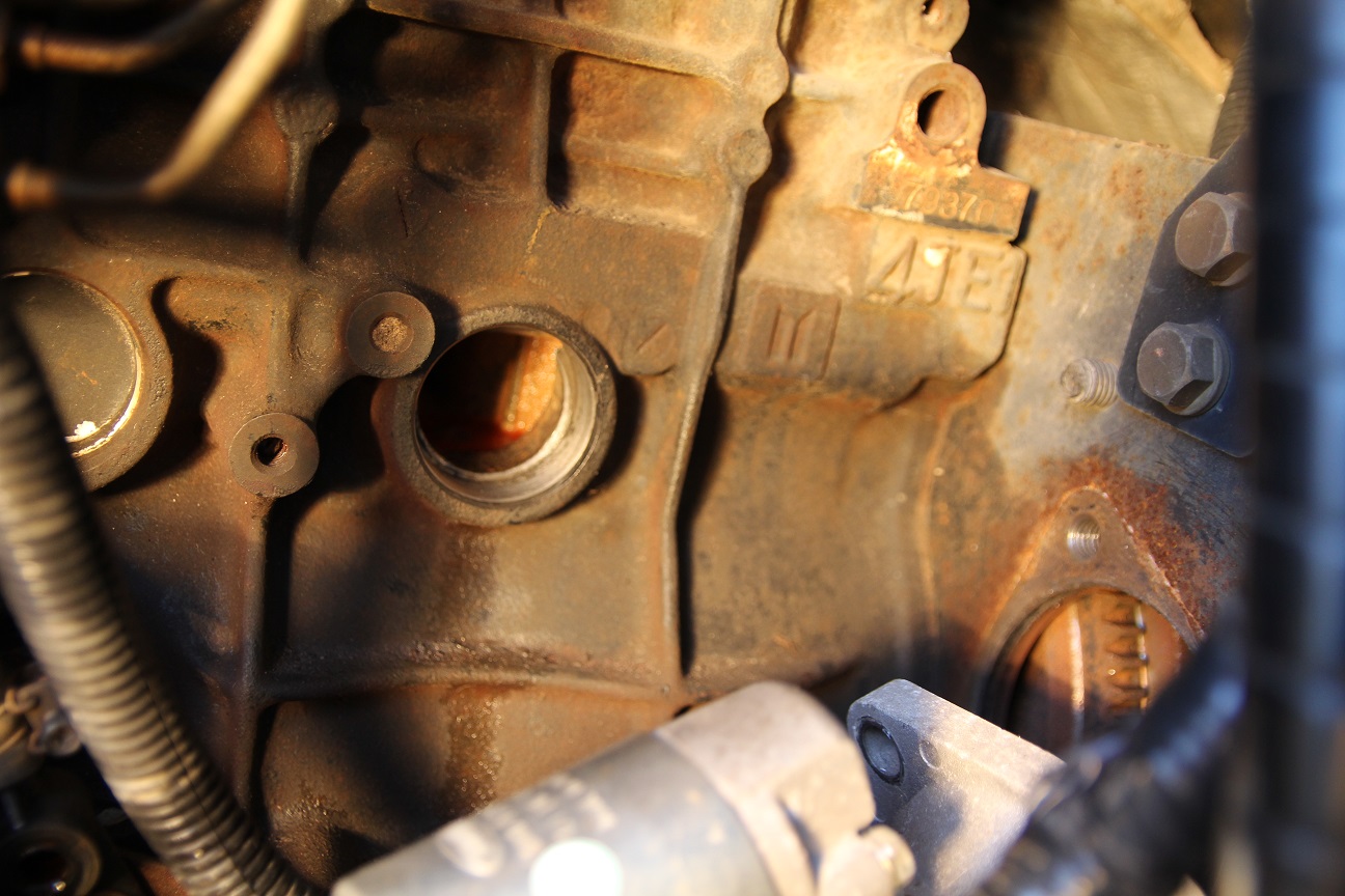

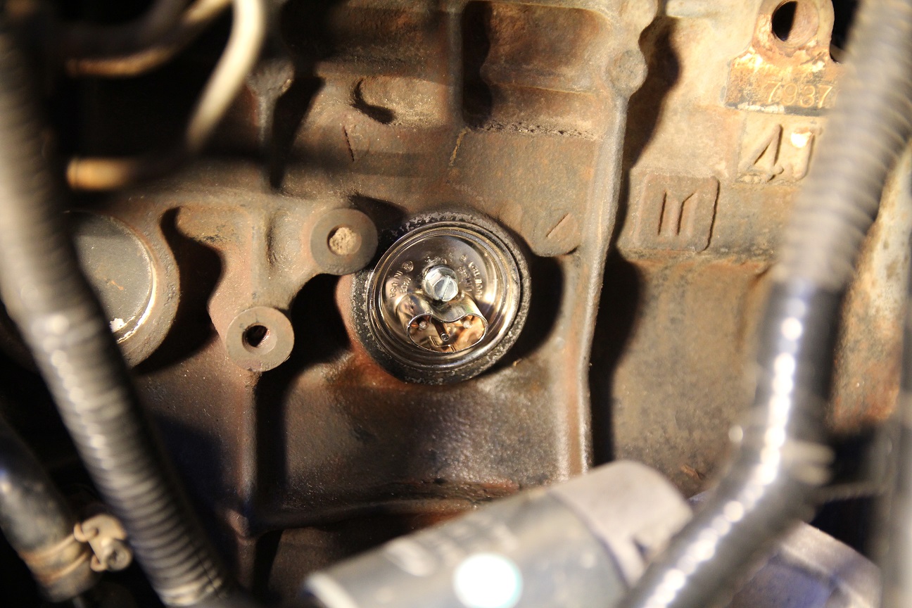

I completed the install of the block heater today. It came with instructions, simple and straight forward, didn't take very long. The hardest part was cleaning up the frost plug opening. I unbolted the starter( didn't need to disconnect it ) and pulled it away from the block to give myself a bit more room.
The element fit perfectly. The literature that came with the block heater stated it was for Isuzu engines 4JA1,4JB1, 4JC1 and when I ordered it from the jobber I asked for a block heater for a 4JD1 based on the premise that a MF1160 which has a 4JD1 is the closest N/A model to my TA357( 4JE1 ).

Good job Gerald, it looks like it was made there. Did not know this heating system, works with 12v of the tractor? with a separate switch?
